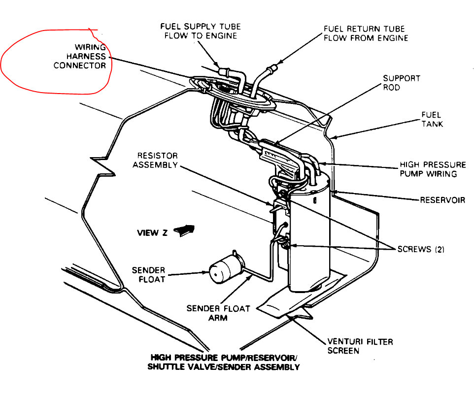

So when you turn the key, can you hear the fuel pump come on?
If the pump is not coming on it could be due to a bad pump or faulty wiring. Since you have already replace the relay the issue could be wiring or the pump itself.
https://www.2carpros.com/articles/how-a-fuel-pump-works
If the pump comes on but it does not run then you could have a faulty fuel pressure regulator.
Let me know if the pump come on.

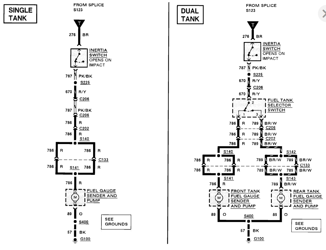

Well, it sounds like you could have a bad wiring to the pump or a bad pump.
You will have to check to see if you are getting power to the fuel pump. To do that you will have to access the fuel pump wiring connector. If it has power with the key on then the pump is bad. If it does not have power then you have a short in the wiring.
