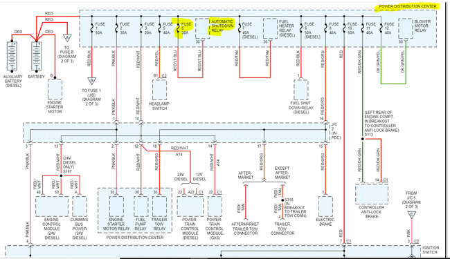

No power to coil, and the fuel pump not kicking on. The truck ran great until my lady backed into a telephone pole impact was rear bumper right on driver side frame.

This vehicle has an automatic shutdown which is designed to shut down fuel and ignition if the vehicle is in an accident. I don't know how hard it hit the pole, but that is where I would start.

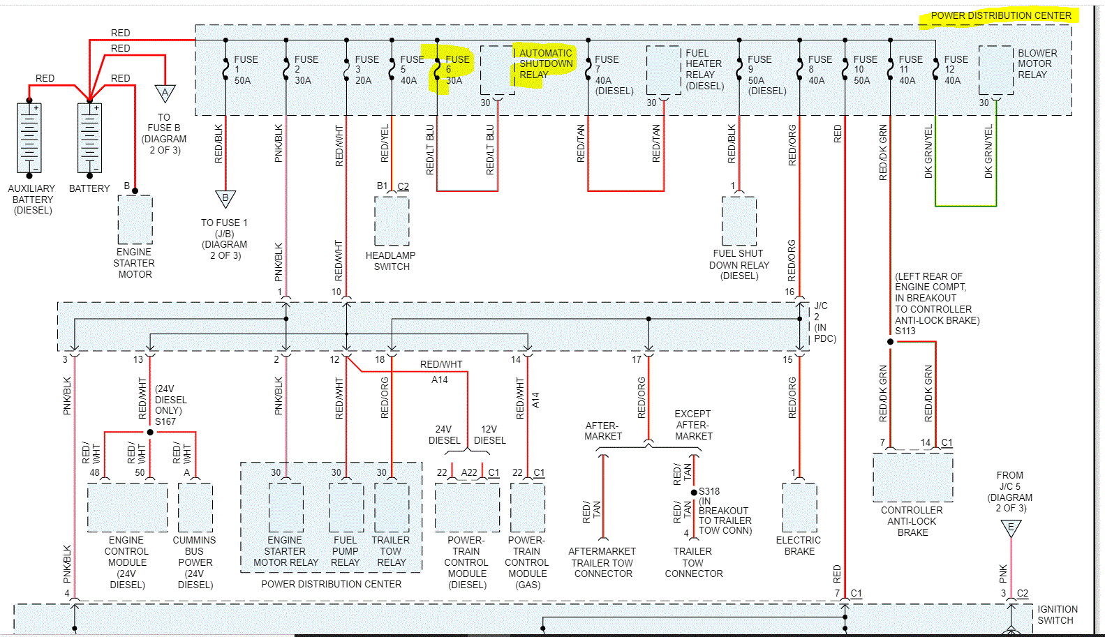

I attached a pic below and highlighted a fuse to check and the ASD relay. Confirm the fuse is good first. (Fuse 6) Also, confirm there is power to and from it. Here is a link you may find helpful.
If the fuse checks good and has power, remove the relay and switch it to a different one in the box that has the same part number. If there isn't one, here is a link that explains how to test one:
Let me know what you find.
See pic below.
