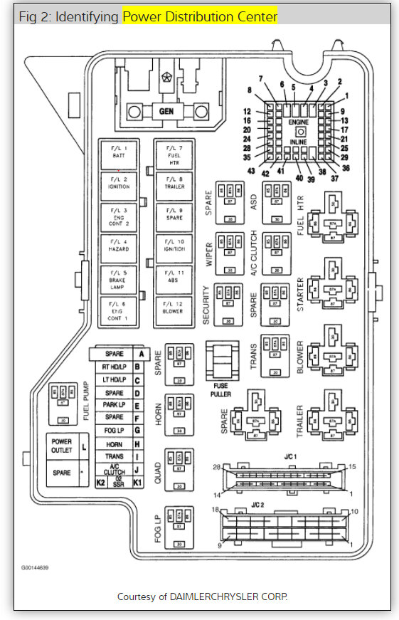

New fuel pump but don't hear it coming on when you turn the key on. I changed the fuel pump relay and still nothing. It has a viper alarm on it, not sure if it could be that or not, is there anything I can try to narrow it down to what could be the problem?
Mar 23, 2024 at 3:41 AM
  • 55,447 POSTS

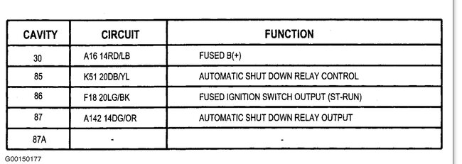

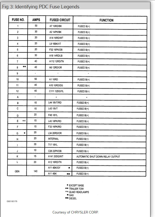

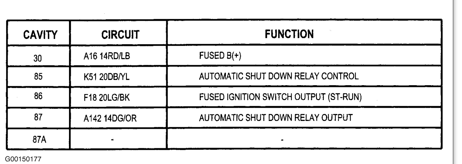

The first thing I would do is remove the aftermarket alarm which are notorious for going bad and put the wiring back to stock. Then I would check fuse #9, 6, 3 and K in the fuse panel under the hood which this guide can help with. I would also swap out the ASD relay in the same fuse panel.
Here are the fuse location and ADS relay in the images below to help you. Also see if the engine runs on starter fluid and please go over this guide:
