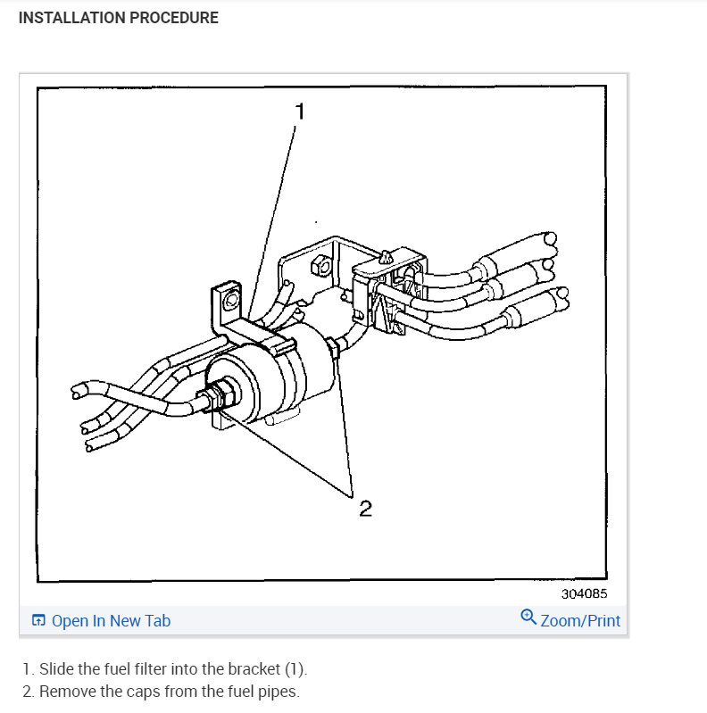

When it's idling it's okay, you go to drive it starts surging.

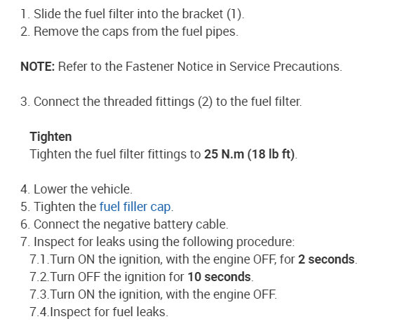

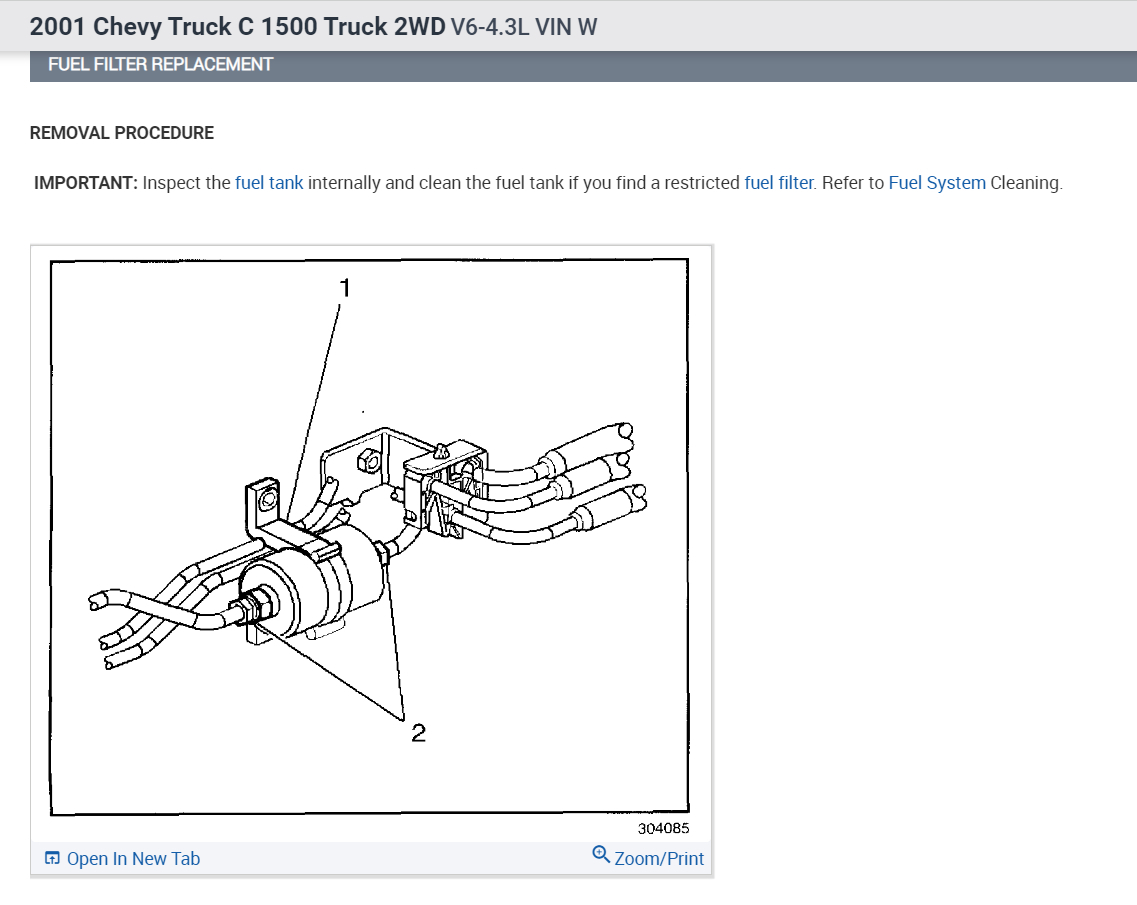

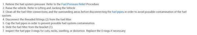

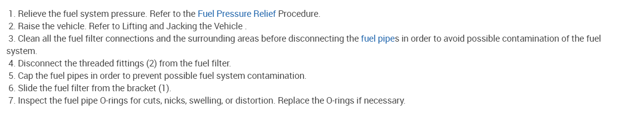

When the truck surges it usually means the fuel filter is clogged. here is a guide to help walk you through the steps with instructions in the images below to show you how on your car.
Also, here is a video to show you as well:
https://youtu.be/cMa2bp4jbNU
and
https://www.2carpros.com/articles/how-to-change-a-fuel-filter
This guide can help as well:
https://www.2carpros.com/articles/engine-hesitates
Check out the images (below). Please let us know if you need anything else to get the problem fixed.
