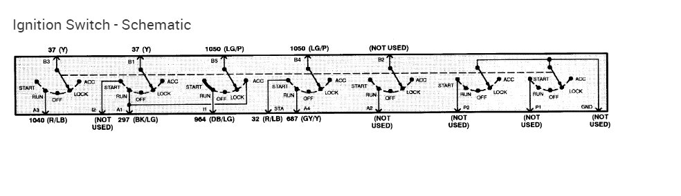

I can crank up my truck but when try and turn it off it still runs.
Tuesday, March 5th, 2019 AT 7:57 PM
SCGRANTURISMO
  • 4,897 POSTS

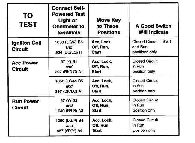

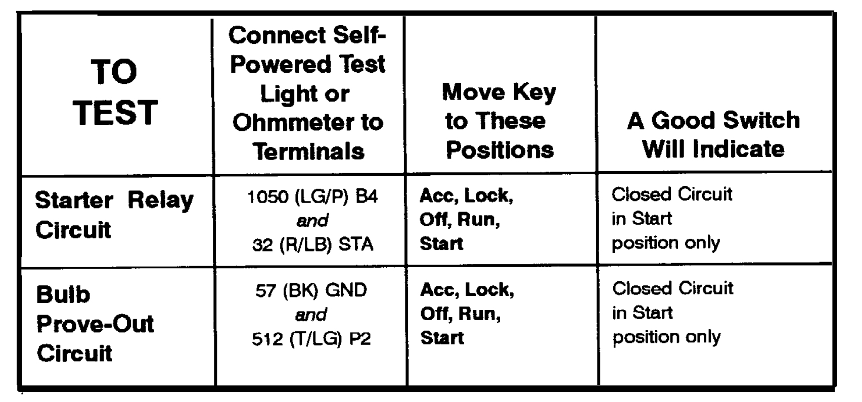

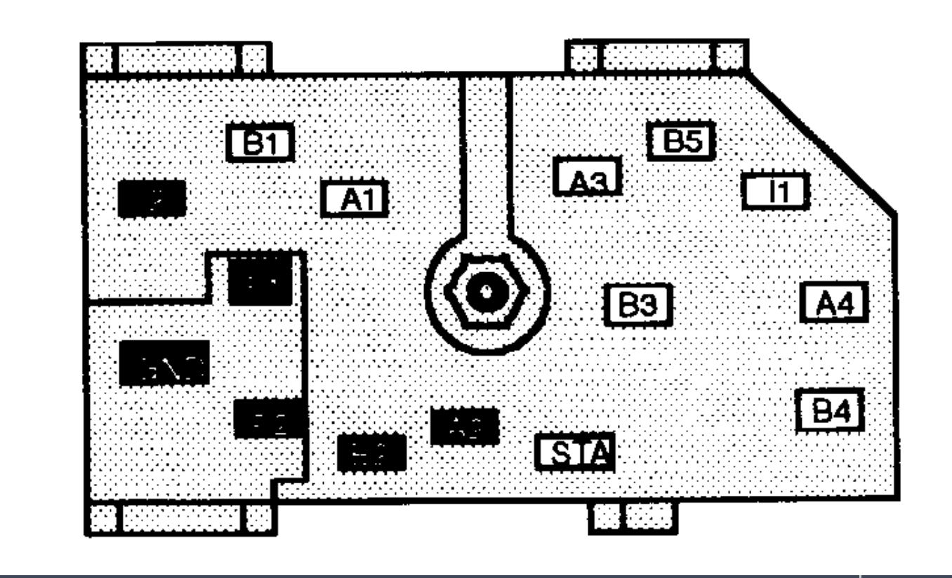

This could be a problem with your ignition switch. I have provided you with a diagnostic chart for testing your ignition switch in the diagrams below. If you do not know how to use a multimeter than go to the link below
Okay, go through the diagnostic chart in the diagrams below and get back to us with what you find out.
