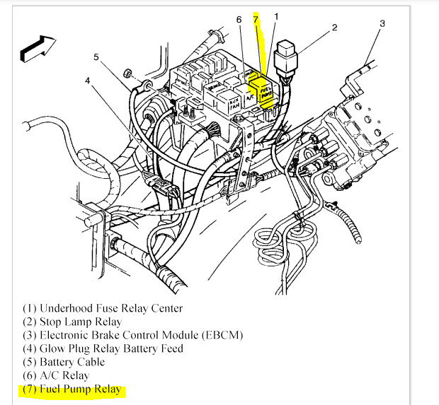

The pressure is slightly low. It should be between 60 and 66 PSI with the key on and the engine off. See pic 1.

Have you checked the fuel pump relay? If there is no pressure and you need to wait, it may have failed.
The relay is in the under-hood fuse box. See pic below

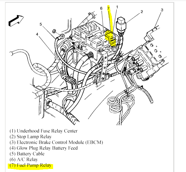

If you have a live data scan tool, when cranking the engine (no start condition) see if there is an RPM signal on the scanner.
See pic below.
