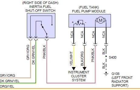

Good afternoon i have a question about a mystery im having. My 97 F150 5.4 starts but wont stay on it dies right away but it dosn't sputter before it dies it just dies immediately almost like if it was a bad ignition switch or something. I checked the fuel pressure at the fuel rail & it doesn't have any pressure, my first instinct was to check all relays & fuses all checked out ok, next i changed out fuel filter still nothing. Next i pulled down gas tank & replaced fuel pump, the fuel pump gets power & you can hear it sucking up the gas so its getting gas from the fuel pump all the way past the fuel filter, checked fuel lines to make sure & they have gas going thru them. Also checked inertia switch of course, its like its not getting fuel pressure from the firewall to the engine, i started to dissconecting different sensors to see if i can find a faulty one but still no luck. Can it be the Fuel pressure regulator maybe the PCM not giving out a signal, maybe missing something elsel??? How can i go about checking these components, i checked pressure regulator vac line to see if presence of fuel but none, i realize it can still be bad. No codes when plugged up diagnostic. I would really appreciate your expertise & invaluable experience as this problem is keeping me from work & need to find out problem ASAP. Thank you for your time & maybe you guys can give me some kind of help it would really be appreciated.

First off, my hearing is no good, I can't hear the fuel pump with engine cranking. the initial prime is one thing, but, you need to check voltage and ground at the fuel pump with engine cranking. If your losing the rpm signal it can stop the fuel pump as well as spark at the plugs and fuel injector pulse. Granted, different makes and models can handle that a little differently.

Just to add, the pink wire with black tracer at the fuel pump connector is voltage with engine cranking.

You can't test fuel pump outside the tank. I've seen faulty fuel pumps that would run up a storm outside the tank,but wouldn't make pressure in the tank. If you have Schrader valve at the fuel rail, and your saying, no fuel pressure? With key on, no crank, bleed the Schrader valve, use a rag or something to catch the spray. W/o recycling the ignition switch, crank it, then check for spray from Schrader valve, if nothing there, you have to backtrack the fuel system.

Check for good voltage and ground at the fuel pump, engine cranking. You will need a helper to crank it. If good voltage and ground with no pump action, have to suspect the pump.

*UPDATE*- My bad guys i been kinda busy but maybe my experience can help somebody else. After replacing the fuel pump twice with no luck i finally found a bad a** mechanic that found out the truck had a bad ground in the motor, i think it is the ground to motor So as i found out the hard way one little wire can cause a big headache. Thanks a lot for all your help JDL from 2 car pros you were on the right track by saying to check the wiring to the fuel pump to see if it was getting the right voltage (it was getting the right voltage but it led us to find the bad ground) thanks a lot guys & good luck to everybody outhere, check those wires & voltage before replacing parts.
