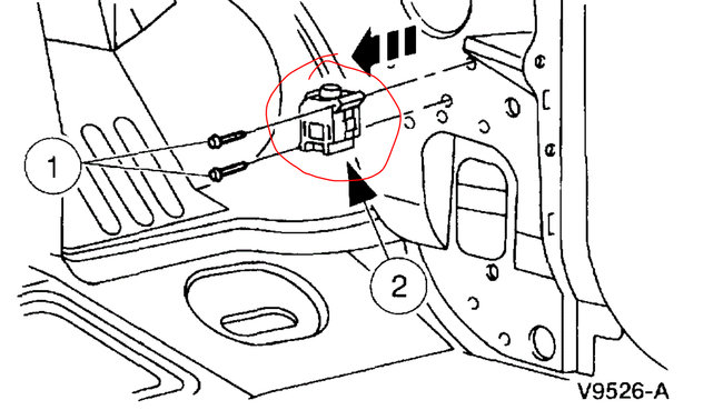

I replaced fuel pump fuel filter and still does not build fuel pressure. I checked the pump cut off it’s working fine but I’m at a loss of what else. someone told me possibly a ground, but I don’t know what ground goes to the pump.

Have you tried to reset the inertia shut off switch? It should be located on the passenger side behind the kick panel. See the attached pic.
As far as a ground, the ground path is provided via the power-train control module.
Let me know about the inertia switch. Also, let me know if you have checked any relays.

Yes, switch is fine and relays are good and I have no power to rear lights.
