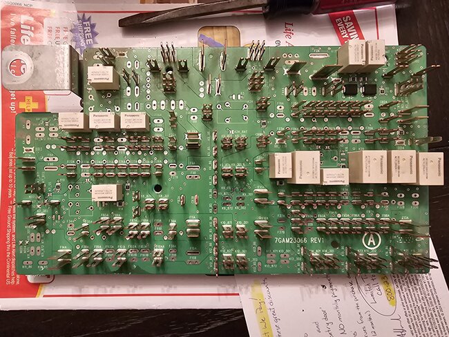

Good evening. So, I removed the TIPM and cleaned up the connectors along with the pin 25 and found it was a little on the dirty side. Now there was still no power at fuse 70 so I had opened up the TIPM to see if I could find the fuel pump relay and cannot find it. Before I order a refurbished one do you possibly know which one on the circuit board is the FPR? I have googled and nothing has popped up for a 2013 Ram 1500 with the 5.7. I took a picture of the PCB.
Feb 4, 2024 at 10:24 AM
  • 110,241 POSTS
You've been busy. I tried to find a layout of the PCB and there is nothing. Based on what you have already done, I feel funny suggesting this because likely you already have done it. However, check for cracks or burnt spots in the PCB. They can be hard to find, but use a magnifying glass to get an up-close look. You may be able to find it if there is one.

Good morning! Will do. I looked it over yesterday and didn't see anything out of the ordinary, but I will take a closer look for sure to see if I missed anything then get back to ya.

One quick question or idea I have. What if I hook the PCB back up to the truck and turn the key on, if the relay is bad when I use the tester it shouldn't do anything, should it?
Feb 4, 2024 at 10:24 PM
  • 110,241 POSTS
That is correct. Please keep in mind there could be an issue related to the PCM providing a ground path to the primary side of the relay. That would be something other than a relay issue.

Okay, so, I got home and put the TIPM back together and reinstalled it in the truck. I turned the truck to run but didn't start it so that way I could check the fuses again. Low and behold fuse 70 has power and pin 25 is good. The truck started right up, no problem. Any thoughts?
Feb 6, 2024 at 6:30 AM
  • 110,241 POSTS
If I had to guess, the problem is the TIPM. Either there is an internal solder joint cracked or the connector itself is faulty. The best thing to do is put it back together and make short trips from home to see if there are any more problems. There is a chance a connector pin wasn't making good contact, and removing it and reinstalling it allowed it to make a better connection.

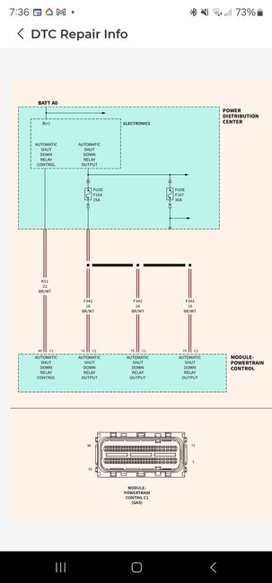

I have the truck listed above that will stall out when I hit a bump. It will crank but not turn over. I had talked with someone on here before and thought I we had figured it out. Before I wasn't getting any codes. Now I am getting a P0688. I have blown 3 fuses to the fuel injectors. With my diagnostic scanner it will give me a wiring diagram to follow, but I'm a little stumped on what F342 is or K51. Any help will be appreciated. I'm about to lose my mind with this.
