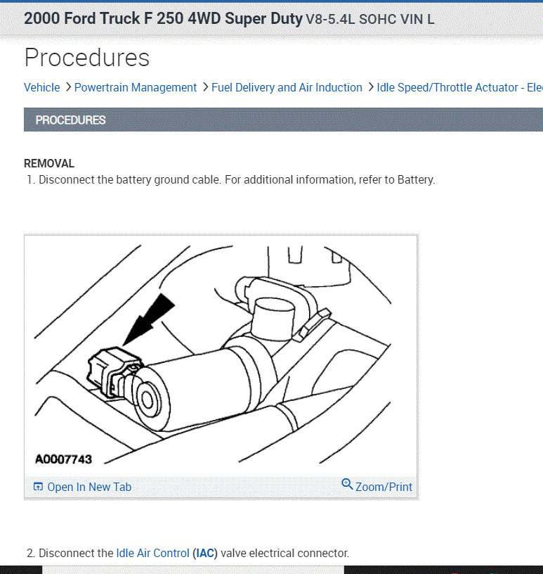

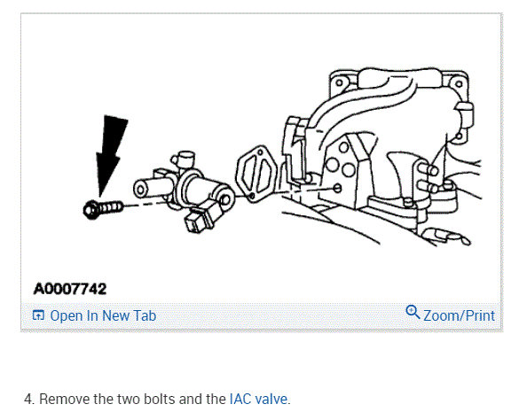

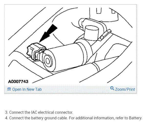

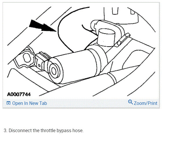

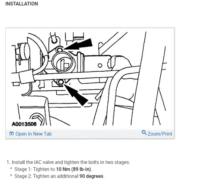

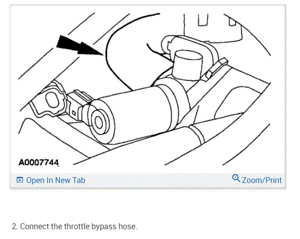

What it's doing sounds related to the idle air control valve (IAC). The IAC is responsible for the idle speed and adjusts when a load is placed on it. For example, the A/C would require the engine to increase the idle.
What I suggest is to remove the IAC on the throttle body. Inspect it and inside the Throttle Body where it mounts for dirt, corrosion, carbon, or anything that can restrict the air passage. Here is a link that explains how to service one:
https://www.2carpros.com/articles/idle-air-control-valve-service
If the pintle on the IAC is in bad condition, replace it. Also, it is important that the air passage through the Throttle Body is clean as well.
If it needs to be replaced, I attached the directions below.
Apr 26, 2022 at 1:25 PM

Hello, I changed the IAC valve looked to be an eBay part, very cheap replaced it with a good part. Now after replacing it still had a very lopy idle until I turned it off and re started it. does it need to be driven a few times for it to relearn?
Apr 27, 2022 at 10:20 AM
  • 110,244 POSTS
Was the throttle body clean where the IAC is attached? Drive it for a bit to see if the idle goes back to normal.

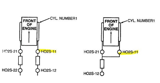

Also, just to confirm. The sensor code was the upstream bank 1 sensor. There are either 3 or 4 sensors on the vehicle. I just want to make sure the correct one was replaced.
See pic below.
See pic below. Note: One is for the original dual exhaust system and the other is a single exhaust.
Apr 27, 2022 at 11:54 AM

Still a very rough idle and yes, both upstream were replaced doesn't have cats so no downstream sensors also was reading it. could be a faulty ECT sensor?
