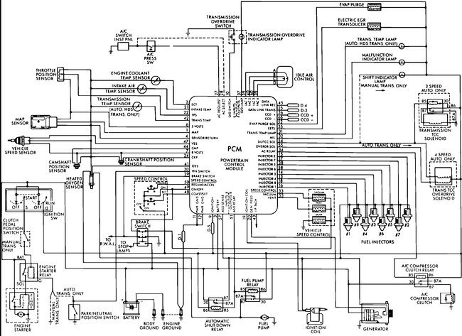

Have this Ram truck 1500, code Z, auto transmission.
Ran beautiful for five years with regular maintenance and tires .Check engine light has never worked. Coming back from Florida pulling an enclosed car trailer the catalytic converter came apart and stopped up the exhaust. Limped it home okay, about ninety miles. Had new catalytic converter, muffler and intermediate pipe replaced, as well as the O2 sensor, wires burnt. NAPA unit. Muffler shop. The next year going over Black
Mountain, the transmission temperature light came on. Made it to Pigeon Forge OK, and back home to N.C.
Transmission acted funny and started to shift [banging] hard into overdrive. Had transmission replaced, [A518]? With a new torque catalytic converter. Had troubles shifting into overdrive and fourth gear. He had left the TV cable unhooked and burnt the overdrive clutches. Replace the clutches and still would not shift. Diagnosed as
the "transmission temperature switch", and replaced. NAPA unit. Transmission repair mechanic. Transmission worked fine but I noticed the engine idle was lower than it used to be. Truck started to run rough, so had a tune up of plugs, wires, cap and rotor button, and they wrung a screw off at the distributor cap. Replace the distributor, NAPA unit. Broke oil pressure switch while doing this. Replaced NAPA unit, and had a water leak at the timing cover. Had new steel timing gears and double roller chain and gaskets replaced. Truck would not stay running for a very long period of time, leave you on side of the road. Diagnosed as EGR and transducer. Both burnt out. NAPA units. Still would not keep running. IAC control, TPS, crank sensor, cam sensor for the new distributor ,and the ECM replaced. First repair shop, friend? Still cutting off. Second repair shop, where I used to work, replaced the coil and coil wire. Did not make it home.
Third repair shop the guy spent two weeks chasing wires and ohm-ed them back to the ECM, as well as replacing the crank sensor and the cam sensor, again, and said they were okay, before he had to quit to have back surgery.
I am at a loss.
Any suggestions as to a definite coarse to take without paying $130.00 per hour to diagnose or repair?
Ignition switch? Fuse panel under hood? Wiring harness? Wrong ECM? Gave numbers on original to match up. Reprogram ECM? at dealership? I have spent a lot of money to keep this truck and would hate to scrap it or sell it for peanuts.

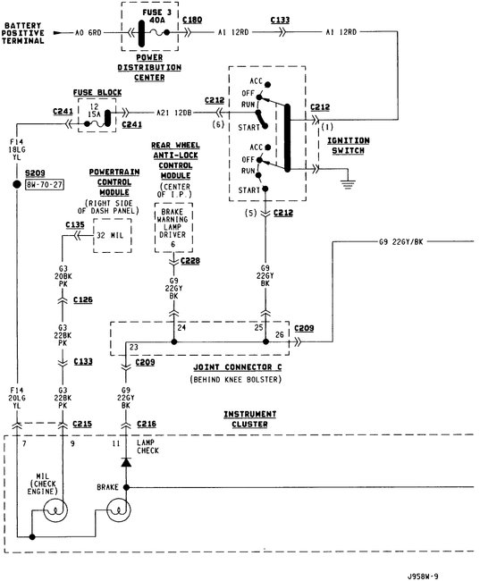

Does the check engine light have to work to store/read codes?

If you do not have one, go buy one of the $100.00 or so code readers that will display live data. That will show you if it has stored codes but also let you watch it as it runs to see what goes away when it shuts off.
The CEL bulb could be burnt out but it would still store codes. If it is the actual memory circuits that are the issue then it would not. But if the ECM was replaced and still no light then I would suspect it is bulb related.
Does the running time seem to be constant before it shuts down?
Does temperature have any effect IE: hotter run time becomes shorter?
When it shuts off is it abrupt like you turned off the key or is it more like it is running out of gas?
How long do you need to wait until it restarts?
Have you checked it to see if it was losing spark or fuel when it shuts down? If not get a can of starting fluid, run it until it shuts down and spray some into the intake and see if it tries to restart. If it does it could be a failing fuel pump or plugged filter that is not letting fuel through. Or even a bad tank vent that is starving it for fuel, when it shuts off try the spray, then go back and try removing the fuel cap, do you hear a hiss as it opens? That would be a bad vent.

The light itself does not need to work. The computer that turns it on/off does. The light is only there to tell you the ECM sees a problem.
I think the third shop was looking for the right cause, something is shutting the signal to the coil off. Like the reference voltage to the sensors is going out. Because you had a bunch of transmission troubles you may want to look at the wiring harness to the speed sensor. It uses the same 8 volt feed as the crank and cam sensors. If it was grounding out on the engine,trans or in the sender itself it could be removing power from the sensors and you get no signal to the PM to tell it to fire the injectors or plugs.

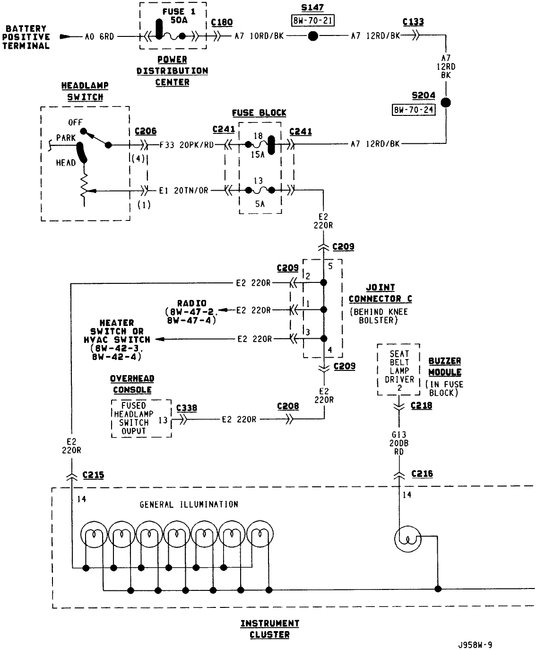

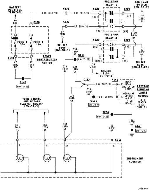

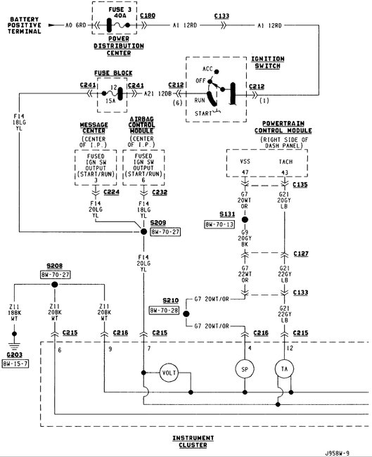

Took the instrument cluster out to switch known bulbs around to get check engine light to work. Still not working with a known good bulb. Instrument cluster printed circuit board not broken or burned anywhere. Put back together and now tachometer and volt meter not working.
If not for bad luck I would have none.
Truck still cut off after about ten minutes, and then backfired out the exhaust when tried to restart and still no start since yesterday. Do not have time to play around with wires for very long. Just have to look at and visualize what they show.
I am losing my connection to this truck more and more every day!

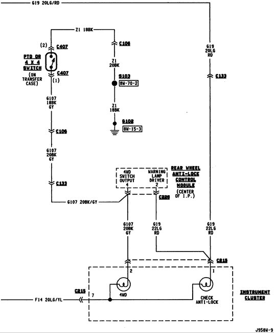

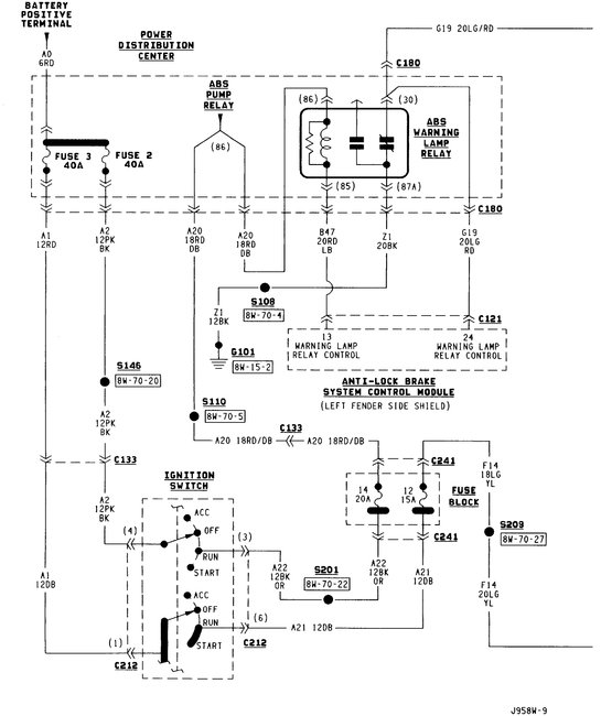

BTDT. I would look real close at the connector to the panel. It does not take much to bend a pin or have one that is loose enough to cause issues.
As for the tachometer not working, I would go look at the crank position sensor, they are known to fail as they get hot and when they fail completely you get no tachometer motion while cranking and the engine will not run. Even though it was tested "good" I have seen them still be bad.
These are the IP circuit diagrams, might help you think through those at least.

Tachometer and volt meter quit after I removed and replaced the instrument cluster, and the crank sensor is new.

Same instrument cluster. Fuel has never seemed to be a problem. Have not seen any thing in wiring diagrams on oil pressure switch to fuel pump wiring to suggest it shuts off fuel pump or the ASD relay.
