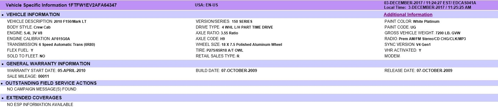

I bought the truck listed above it is the Lariat used and I was wondering if anyone can run the VIN number to see what all came on the truck? I know the dealer can but not for cheap.

What is the VIN number?

That would help a lot forgot to put it 1FTFW1EV2AFA64347. sorry about that.

Is this what you were looking for?

Here is some more information:
Detailed Vehicle Specification - 1FTFW1EV2AFA6434711:24:26 AM

Thanks that tells it all

The ones that say less anyway to see if they or myself can add on

Like JBCAA LESS DAYTIME RUNNING LAMPS for instance any way to know if tese could be added by me

I am sure you can. You may have to reprogram a module afterward.
I am reading, "The Daytime Running Lamps (DRL) system operates the low beam headlamps at a reduced intensity.
The SJB supplies voltage to illuminate the low beam headlamps at a reduced intensity when the following conditions are met:
•The ignition switch is in the RUN position.
•The headlamps have not been turned on by the autolamp system or the headlamp switch.
•The transmission is not in PARK (P).
The SJB can be configured to turn the DRL on for this vehicle.
