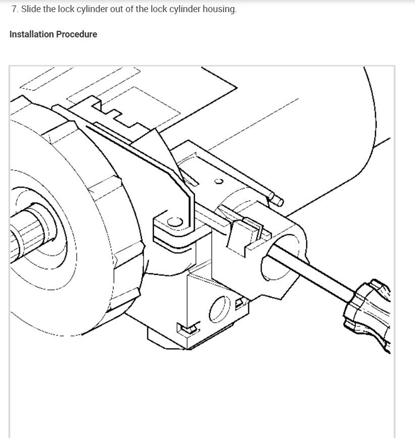

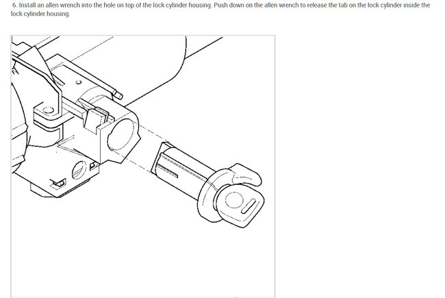

ignition key is stuck
2007 CHEVROLET SILVERADO
49,000 MILES • 5.3L • V8 • 2WD • AUTOMATIC
JEAN LEGGETT
Since the vehicle is not driven much because the ignition key is stuck I need to replace it.
Jan 1, 2016 at 8:08 AM
HMAC300
  • 48,601 POSTS

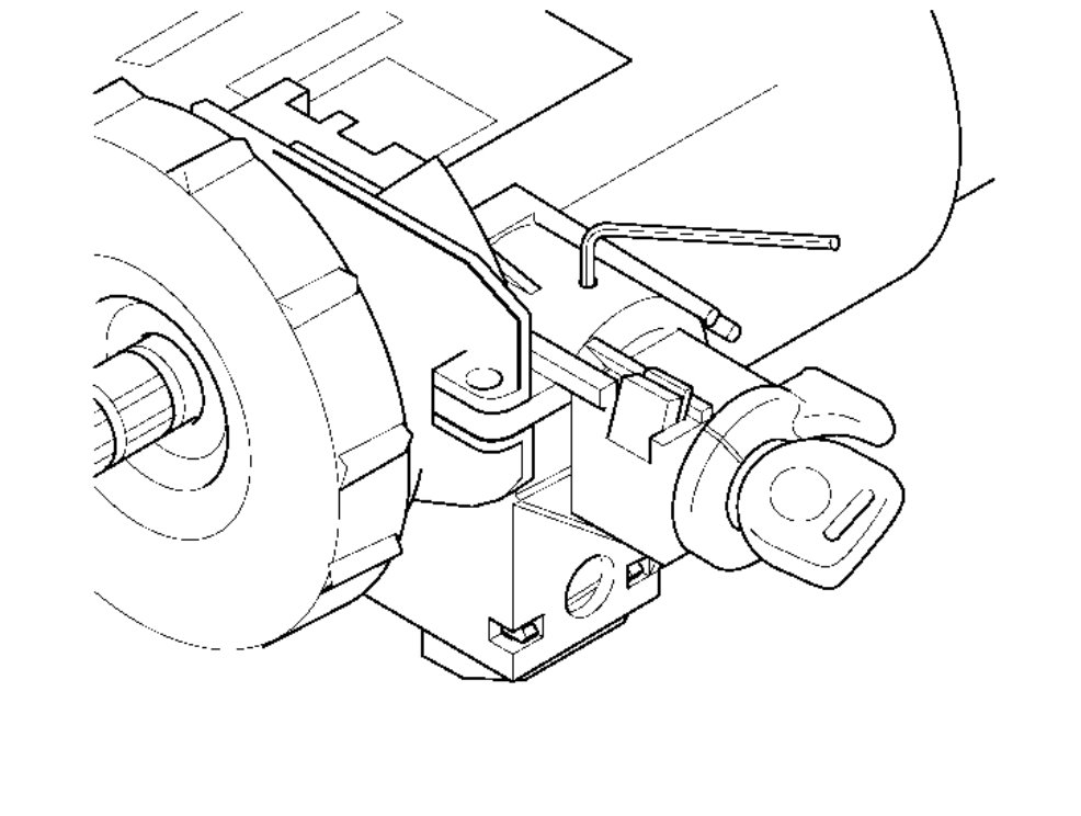

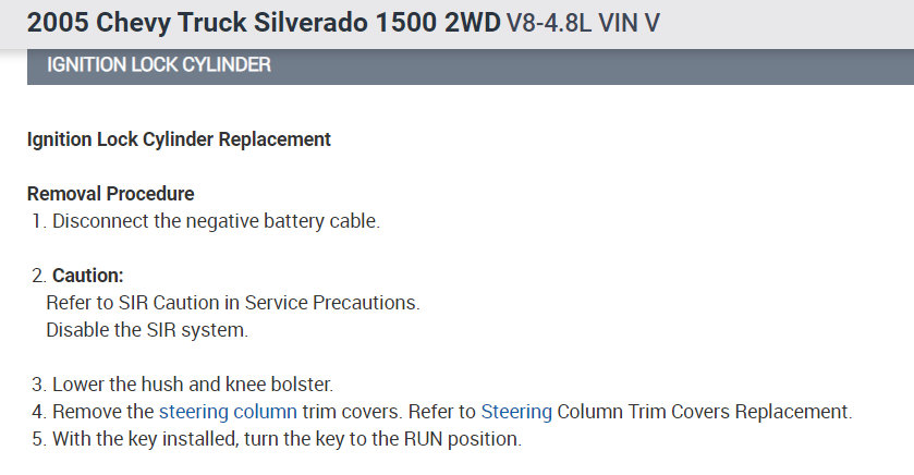

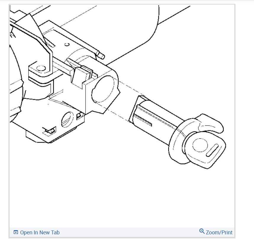

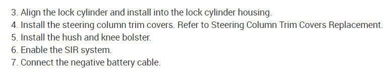

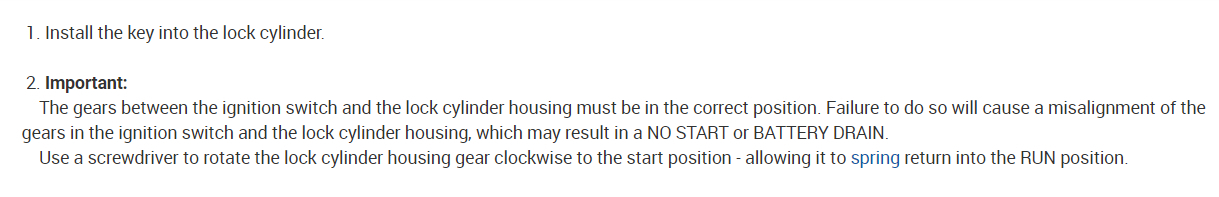

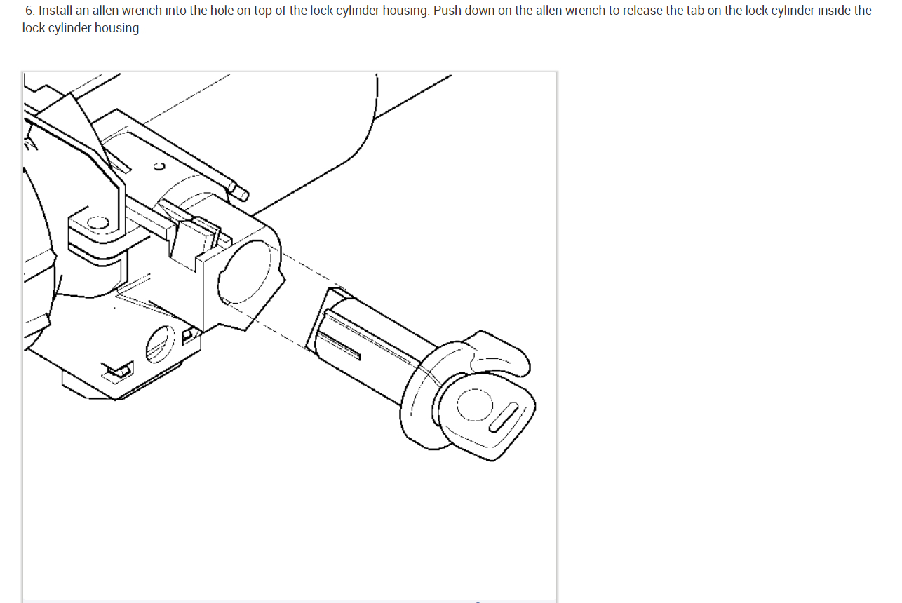

Here are the instructions to replace the ignition key and lock tumbler in the diagrams below. Check out the diagrams (Below). Please let us know if you need anything else to get the problem fixed.
