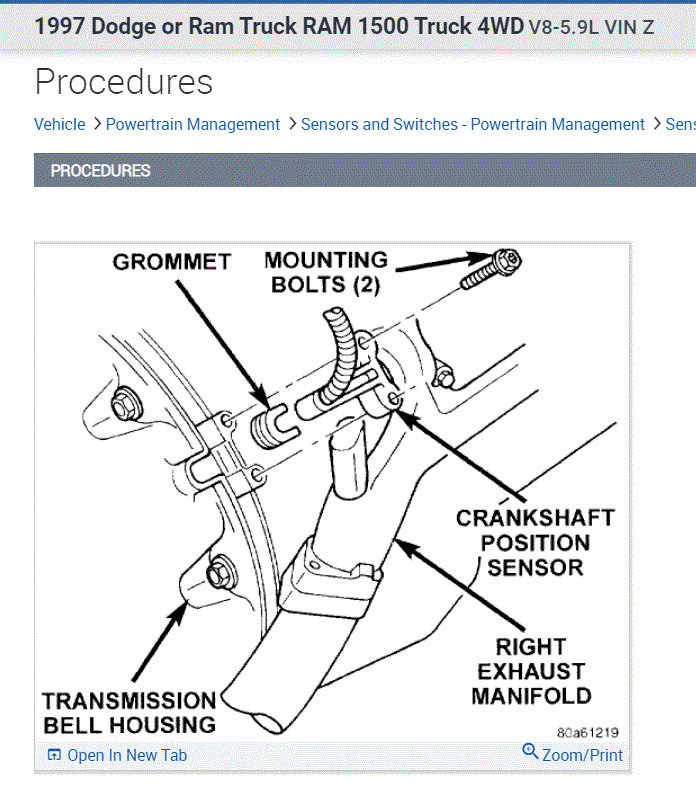

I also had my fuel pressure checked and that good my truck won't start if the check engine light is not on. I also replaced the alternator. I know my truck runs because last Thursday and Friday I drove it Saturday and Sunday every time I try to drive it, it stalled out on me and wouldn't start for a few hours then I would restart installing in.

The idea that it won't start when warm and required to sit for a few hours leads me to think it could be a faulty crankshaft position sensor. When they begin to fail, heat affects them
Do me a favor. Take a look through this link. It covers the most common symptoms related to a faulty sensor. See if it mirrors what you experience.

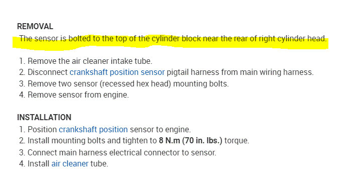

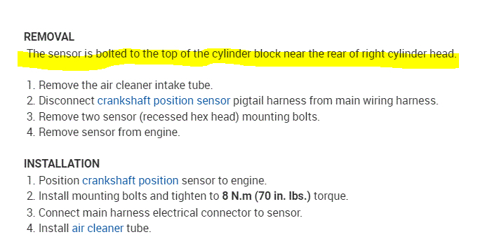

Yes, mirror my trucks symptoms to a T. I will change the crankshaft Position sensor and if I have any more questions, I will make sure to email you. thank you Joe.
Mar 15, 2022 at 1:45 PM
  • 110,244 POSTS
You are very welcome. Let me know if that takes care of the problem. Also, I attached directions below for replacement. I don't know if you need them or not, so I figured I would add them.
