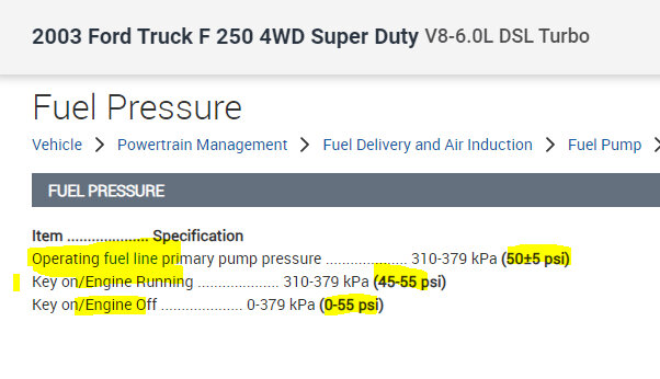

I have a fuel gauge connected at the fuel regulator and i have 65 PSI.

Is that on the regulated side of the regulator? I ask because it is high. I attached the manufacturer's fuel pressure specifications below.
See pic below.

I have an adjustable fuel regulator turned it down to 60 PSI the truck still misfires and sputters at 45,55 and 65 MPH.

The operating pressure is 55 PSI max. Are you able to turn it down so that it runs at 50 PSI? Also, is there any change when you lowered it?

I lowered it to 50 PSI and there’s no changed.

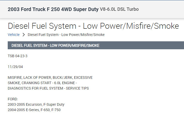

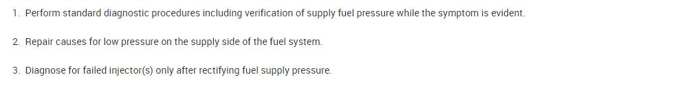

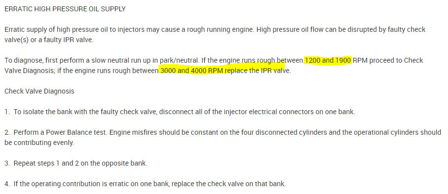

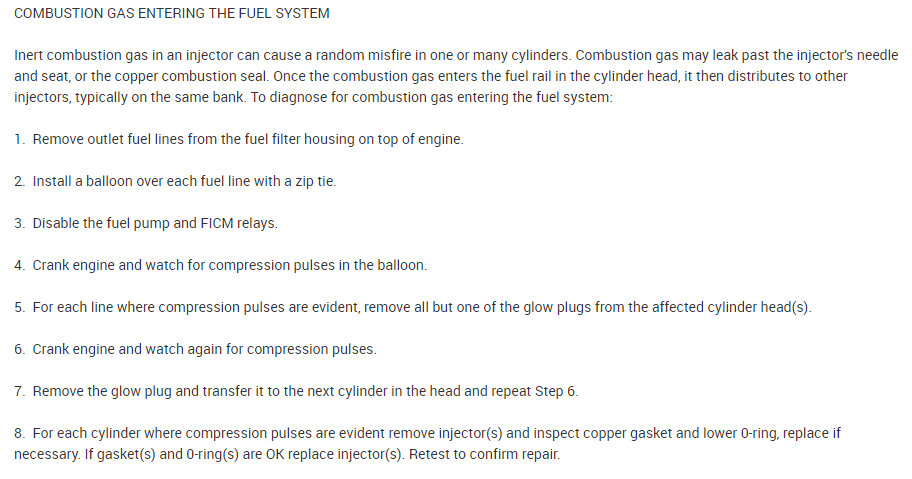

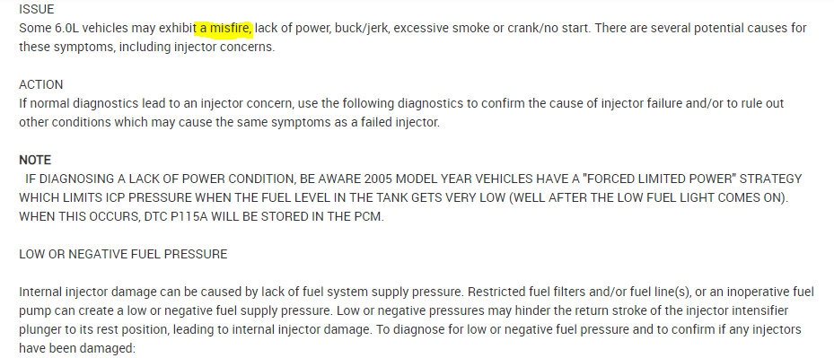

Is there any smoke from the exhaust when this happens? Have you inspected the injector pressure regulator valves (IPR)? They can cause an erratic pressure changes.
I attached a few tests below. Take a look through them and let me know if you are comfortable performing them. Note: These diagnostics are based on a technical service bulletin related to a few different symptoms. One symptom is a misfire based on engine RPM speed.

The ICP and IPR valve was replaced about 5 months ago.
