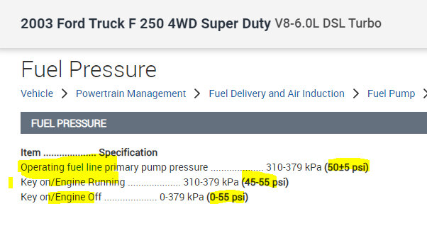

Is that on the regulated side of the regulator? I ask because it is high. I attached the manufacturer's fuel pressure specifications below.
See pic below.

I have an adjustable fuel regulator turned it down to 60 PSI the truck still misfires and sputters at 45, 55 and 65 MPH.
Thursday, February 22nd, 2024 AT 8:50 PM
  • 109,885 POSTS
The operating pressure is 55 PSI max. Are you able to turn it down so that it runs at 50 PSI? Also, is there any change when you lowered it?

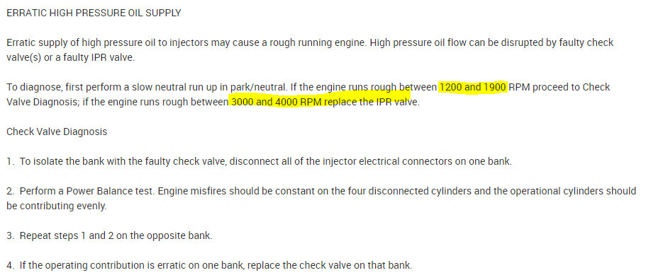

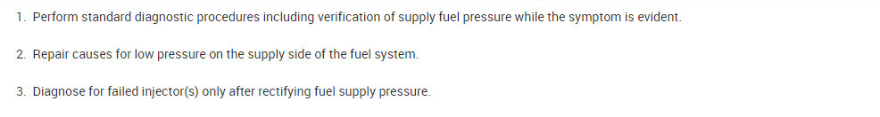

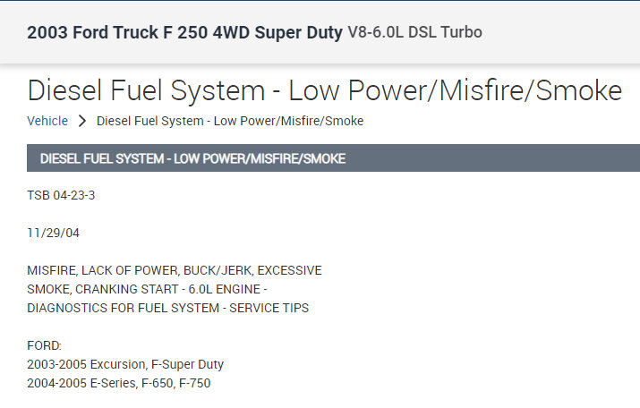

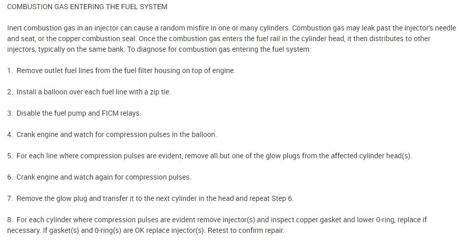

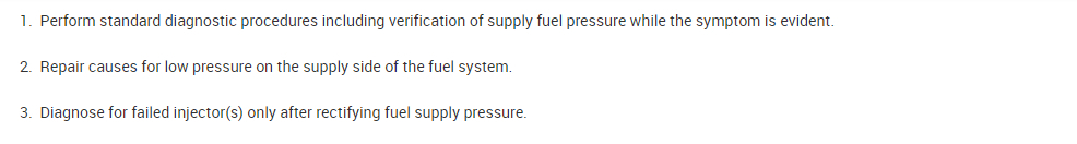

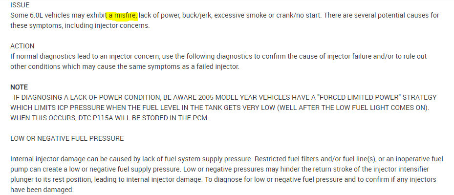

  • 109,885 POSTS

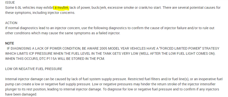

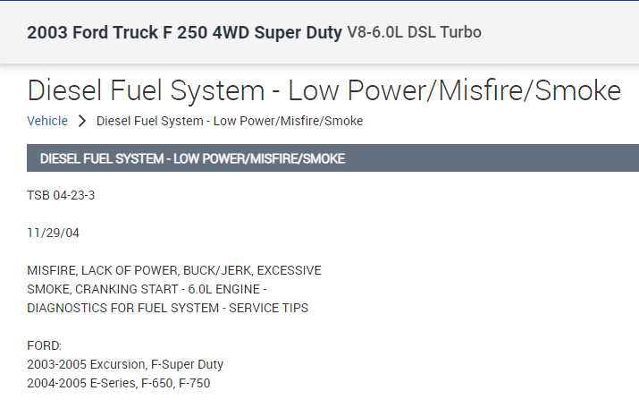

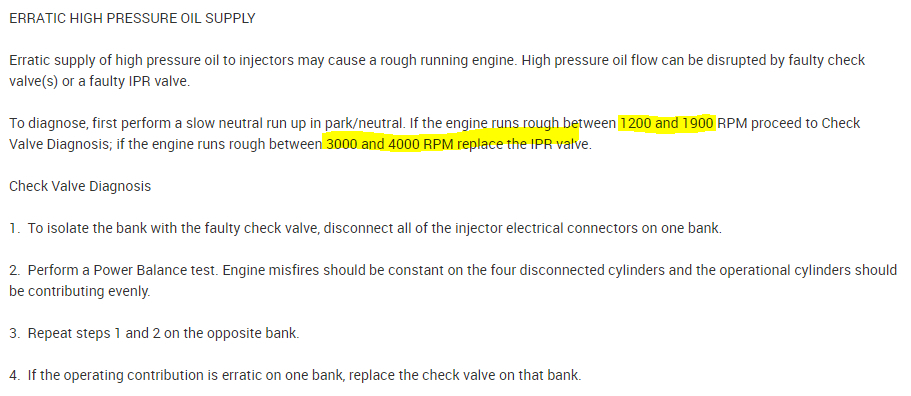

Is there any smoke from the exhaust when this happens? Have you inspected the injector pressure regulator valves (IPR)? They can cause an erratic pressure changes.
I attached a few tests below. Take a look through them and let me know if you are comfortable performing them. Note: These diagnostics are based on a technical service bulletin related to a few different symptoms. One symptom is a misfire based on engine RPM speed.
Friday, February 23rd, 2024 AT 9:52 PM
RUBENGR541
  • 17 POSTS
The ICP and IPR valve was replaced about 5 months ago.

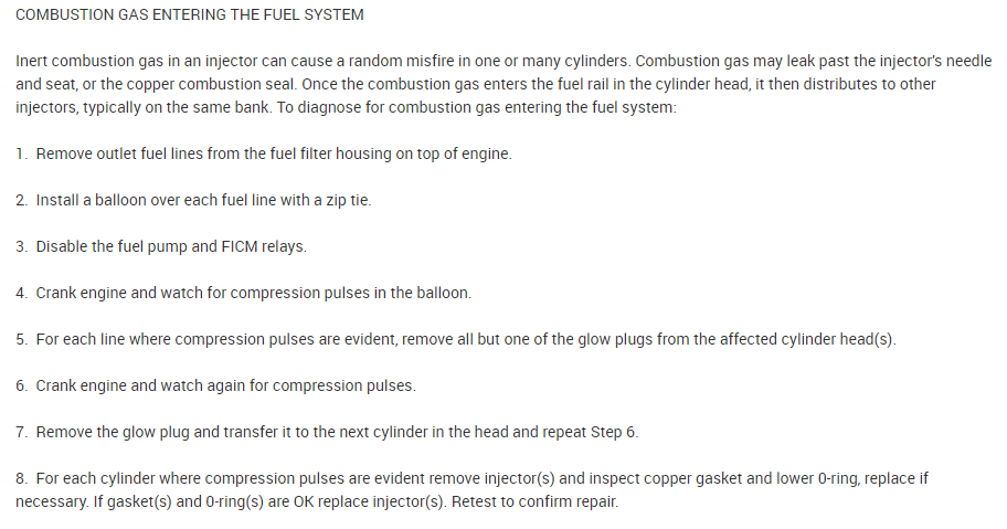

Yes, it does it every time at the speeds I mentioned and smells like unburnt diesel at start up.
Sunday, February 25th, 2024 AT 6:58 PM
  • 109,885 POSTS
I feel bad asking so many questions, but not being there makes it a bit more difficult. I hope you understand.
When you checked the fuel pressure, how quickly did it drop off when the system was turned off? The idea that you smell raw fuel when starting may indicate an injector is leaking.
