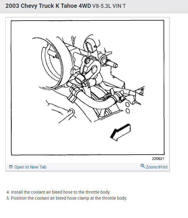

SUV started to lose power when i drive and sometimes it doesn't want to accelerate and now its blowing white smoke and smells like something is burning. so, is the engine burning?
May 24, 2022 at 1:16 PM
SQM
  • 6,383 POSTS

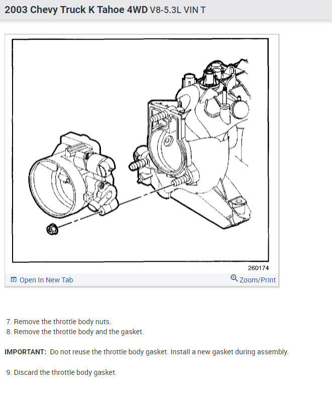

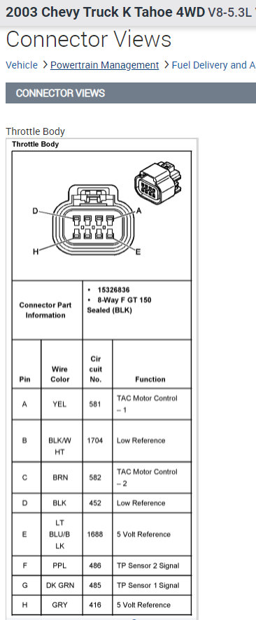

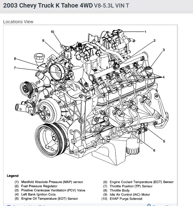

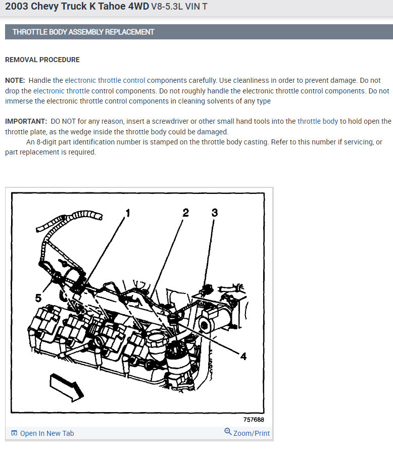

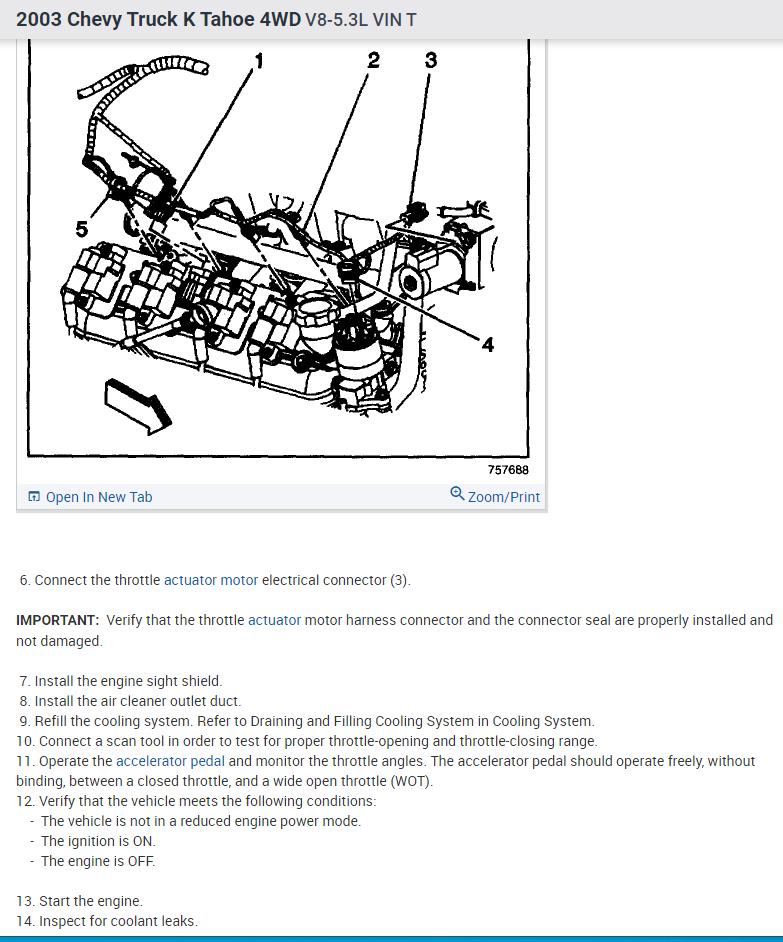

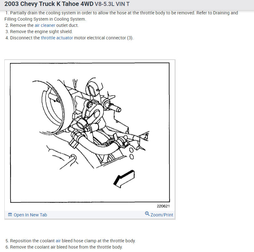

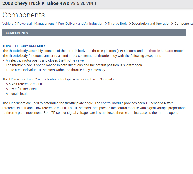

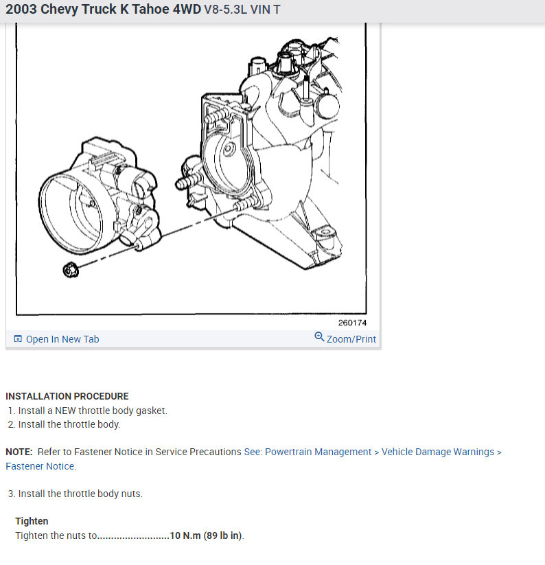

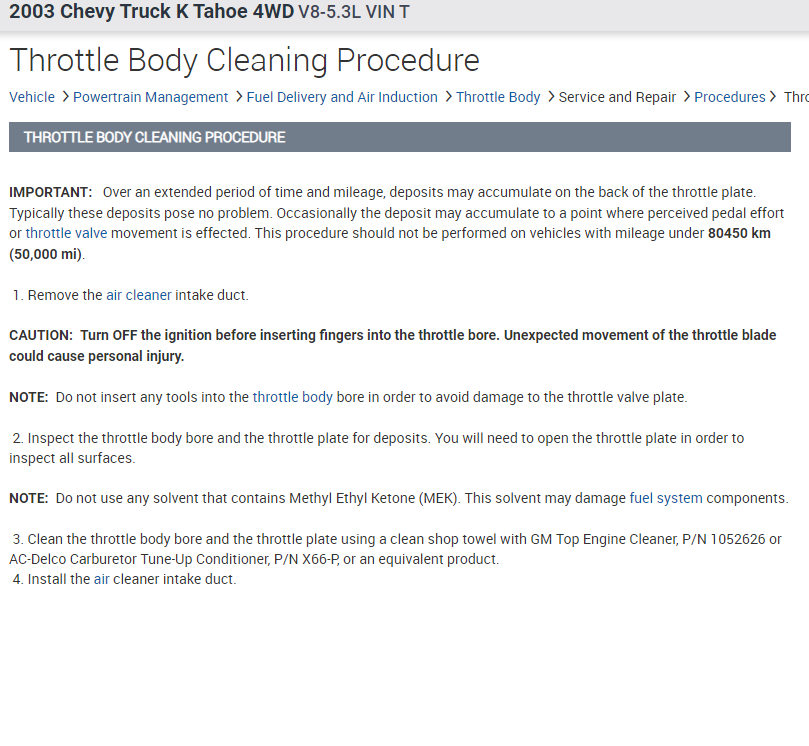

One of the most common causes for low power output or limp mode is having a dirty throttle actuator. Dirt and debris can impact the effectiveness of the throttle position and other sensors and that can trigger the limp mode.
Cleaning out the throttle body can improve drivability.
As for the white smoke, does the vehicle overheat?
Typically, white smoke is due to a blown head gasket. In which the coolant will mix with oil and create smoke. Also, this will turn the oil to a milky white color.
Here is a helpful guide on how to test for blow head gasket:
Let me know of any questions.

Inspect the throttle actuator and clean it out, if you haven't already.
