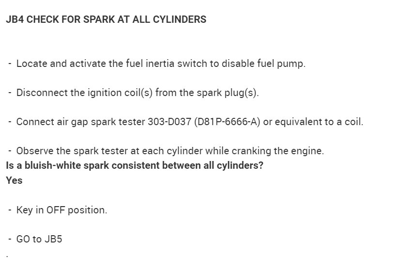

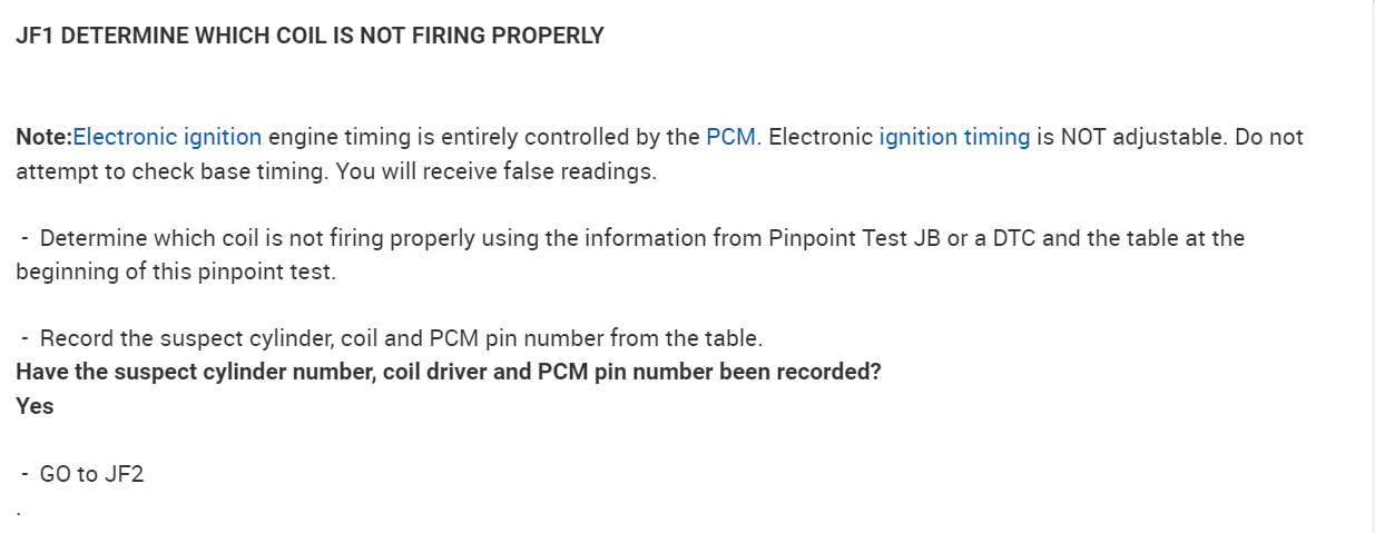

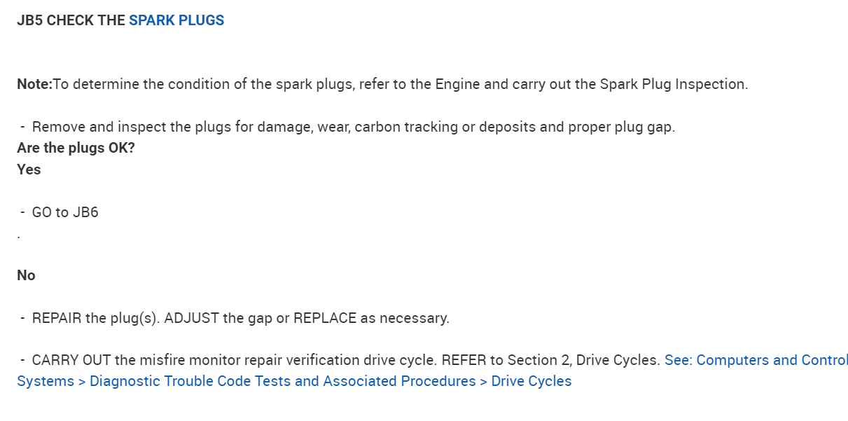

I replaced fuel filter, VCT solenoids, sparked plugs (8), I replaced all coils packs (8). Do I need to replace all fuel injectors? With truck running three pending codes are showing up and they only show while the truck is actually running.
P0356-ingition coil F Primary /secondary circuit malfunction
P0356-Bank 1 system to lean
P0351-Ignition coil A primary secondary circuit
Jul 20, 2019 at 1:49 PM
SCGRANTURISMO
  • 4,897 POSTS

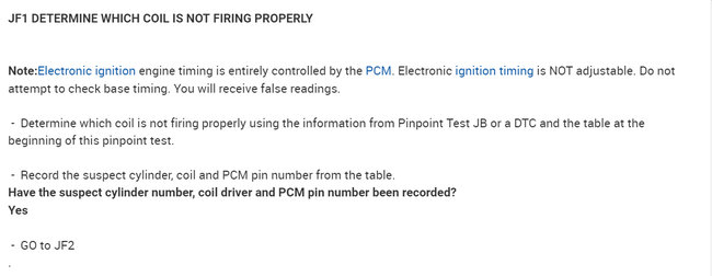

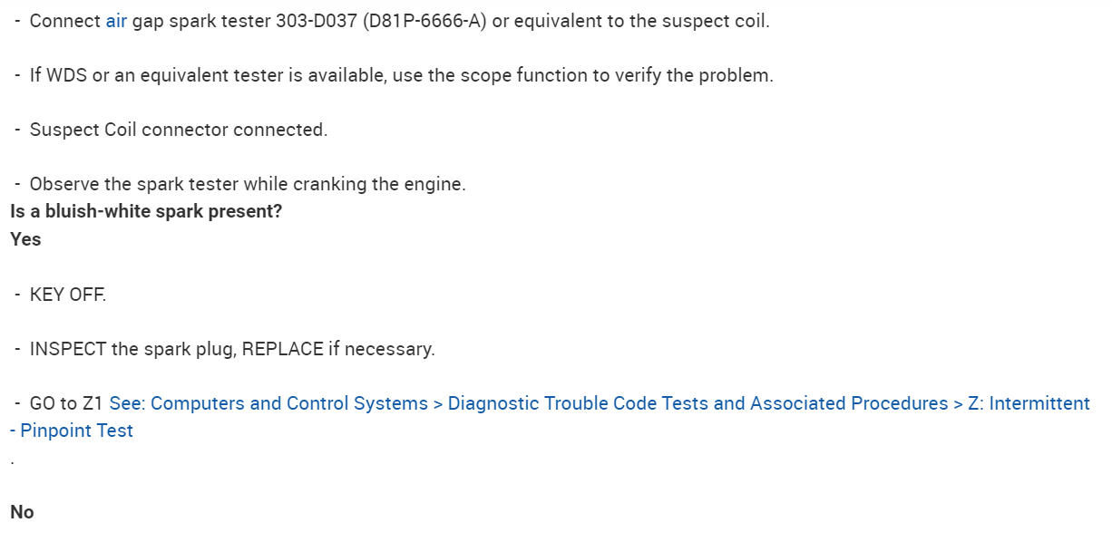

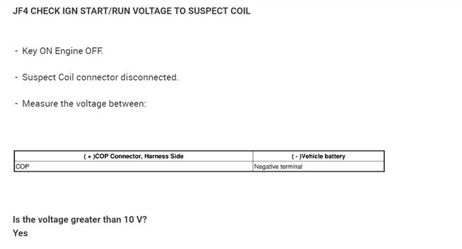

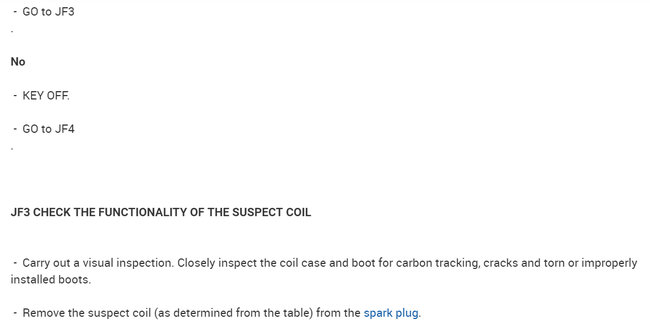

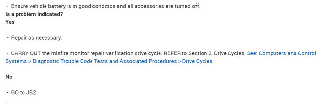

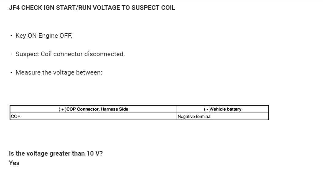

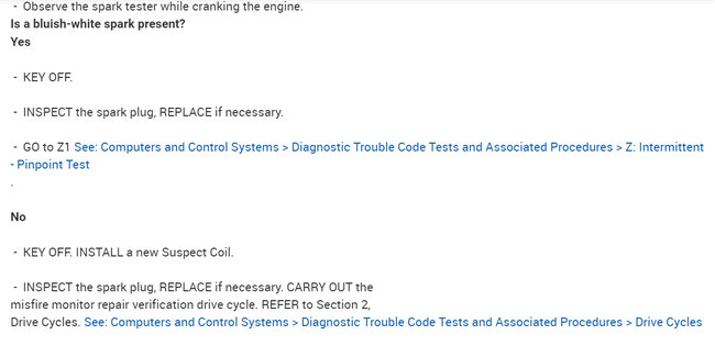

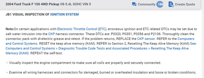

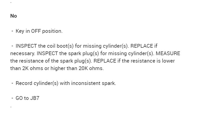

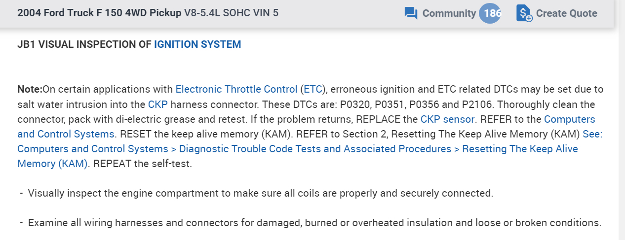

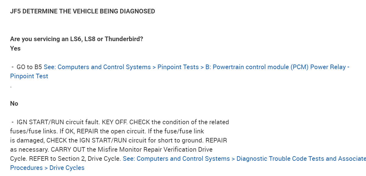

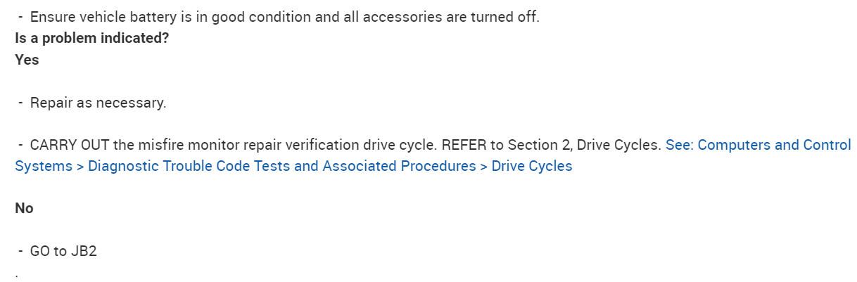

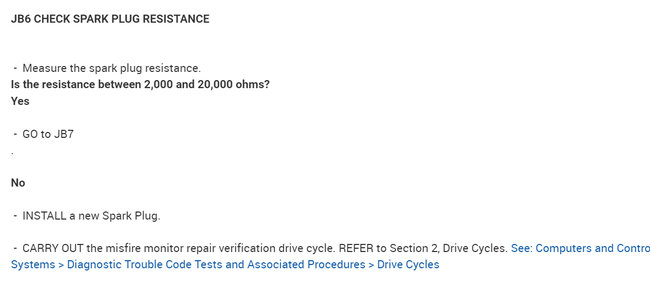

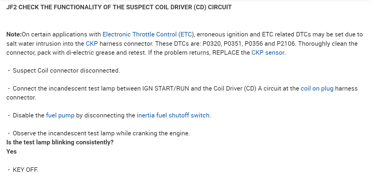

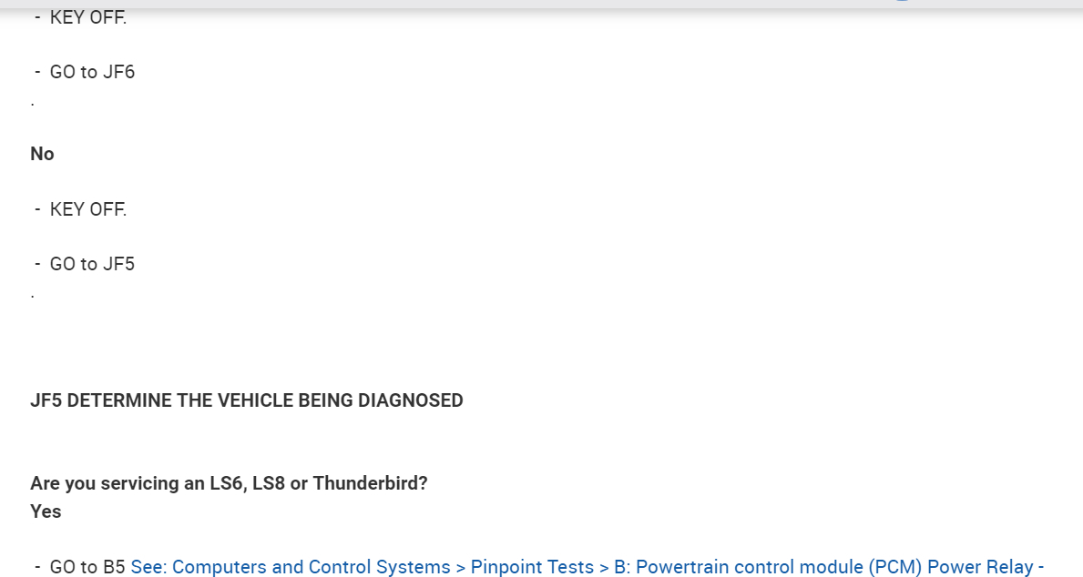

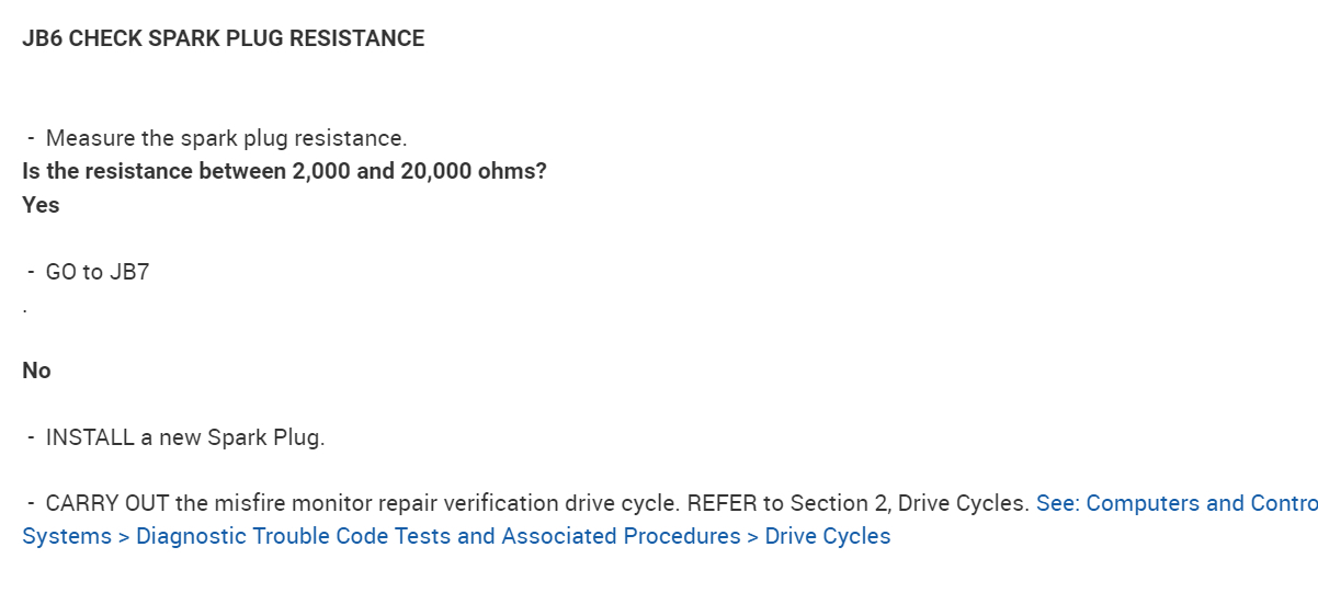

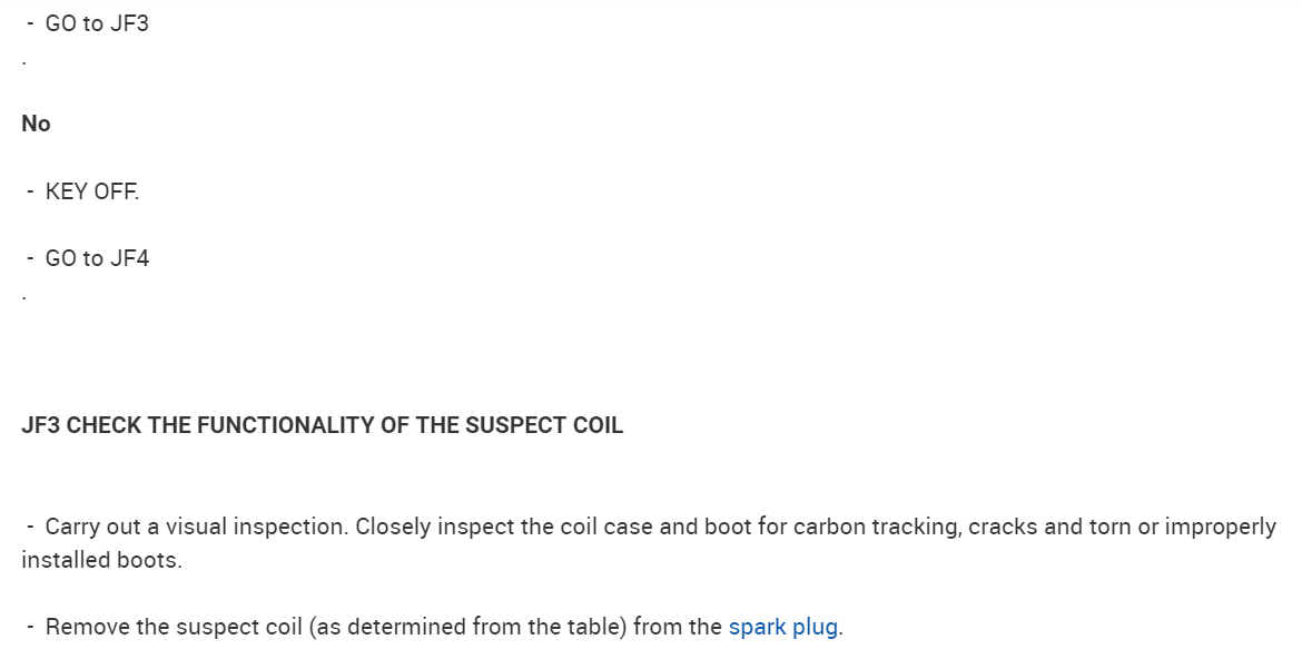

In the diagrams down below I have included for you the factory diagnostic troubleshooting flowcharts for your vehicle for Direct Trouble Code(s)(DTC)(s) P0351 and P0356. In the pinpoint tests they will have you test for spark, and here is a link below explaining how to do this if you don't have a spark tester:
Please go through these guides and get back to us with what you are able to find out.
