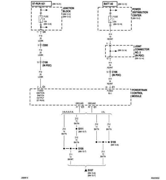

The truck is in limp mode for some reason and turns but will not fire. I replaced fuel pump,the pickup coil and the ignition coil. None of these things have worked and relays are all good.

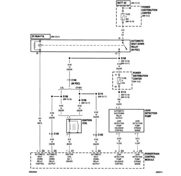

Okay, I sent two diagrams for you to view. check the fuses in each diagram for power on both sides with the key on.

Okay checked all of the fuses and relays and still in limp mode so going to try replacing the crank position sensor today and hope that works. Any other ideas would be appreciated. Thank you for your time.

Okay, can you check the voltage on the positive side of the ignition coil?

Took a few days break from this truck but now can say no voltage to ignition coil
Feb 23, 2018 at 12:11 PM
OK Can you test for voltage at the ASD relay with the key on?? This relay provides power to the coil and the fuel pump.
