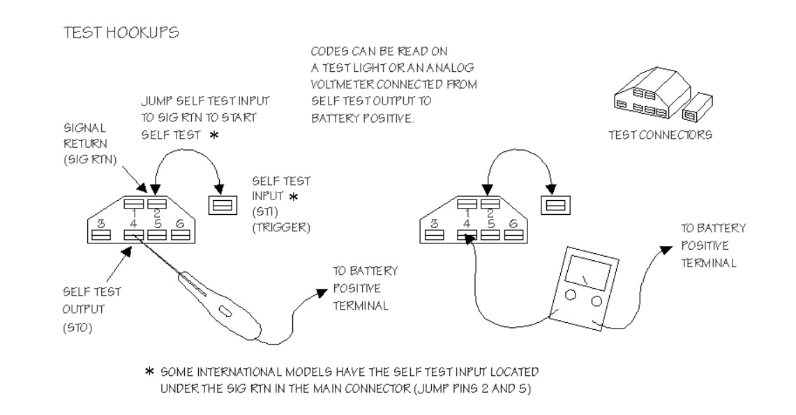

Why wasn't the code test conclusive? If your eec iv, there other ways to check the codes. Diagnostic connector right front inner fender panel.
You can use a test light or analog volt meter. Hook it up, turn key just till dash lites come on, then the test light starts flashing or the meter needle starts sweeping. You count the flashes or sweeps to get the codes. It does take some practice to get used to reading the pulses, correctly. After you get used to it, you shouldn't have any problems.
