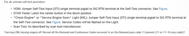

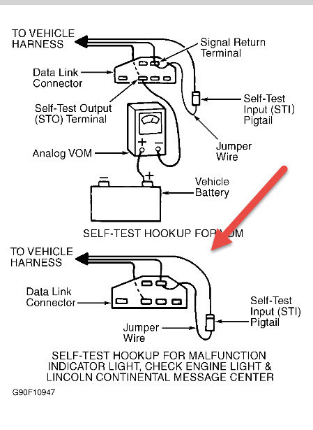

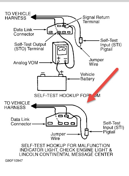

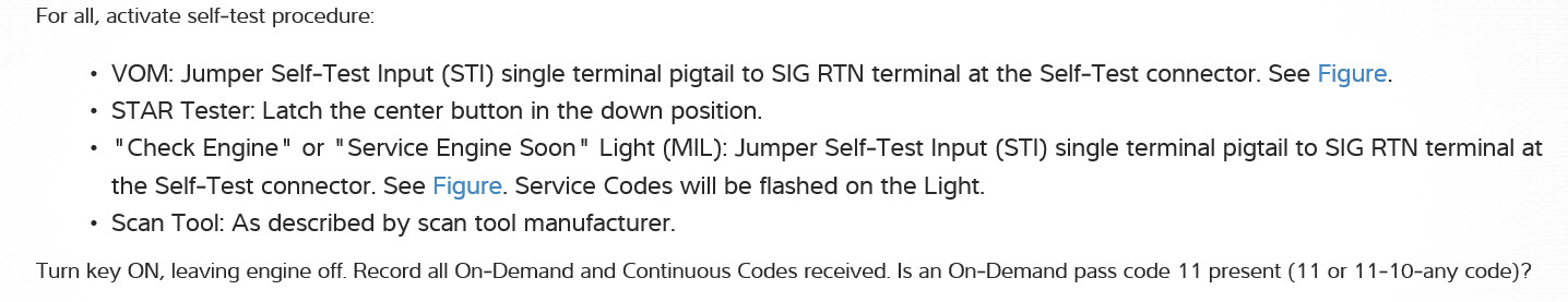

How do I get codes its obd1
Jan 20, 2016 at 4:31 AM
HMAC300
Experienced Mechanic
48,601 POSTS
see pics
