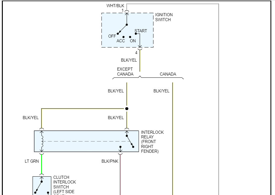

So, my truck won't start when I turn the key, everything else comes on except the truck. But it starts when I push start it.
Oct 5, 2022 at 3:56 AM
  • 110,248 POSTS
Do you mean the starter won't engage? Let me know.

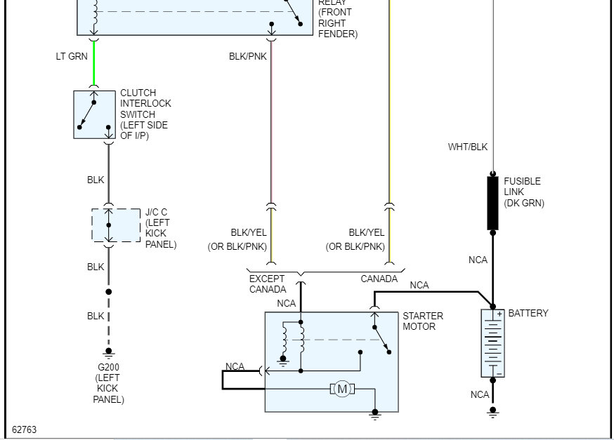

I attached the wiring schematic below for the starter circuit. If it is the starter that doesn't engage, chances are it is either the clutch switch or the relay.
Here is a link you may find of interest:
Let me know if you hear anything when you turn the key. For example, is there a click at the starter or anything at all?

So, I have changed the battery, the starter, the starter relay, and the neutral control switch and the ignition relay that's in the fuse box under steering wheel and yes it clicks when I turn the key.
Oct 5, 2022 at 1:28 PM
  • 110,248 POSTS
If the starter itself clicks, it's getting power. So, the circuit is completed. That leaves a loose or faulty connection or a faulty starter, but that was replaced.
Have you checked the battery terminals, grounds, and wiring to the starter? Also, are you able to turn the motor by hand?
