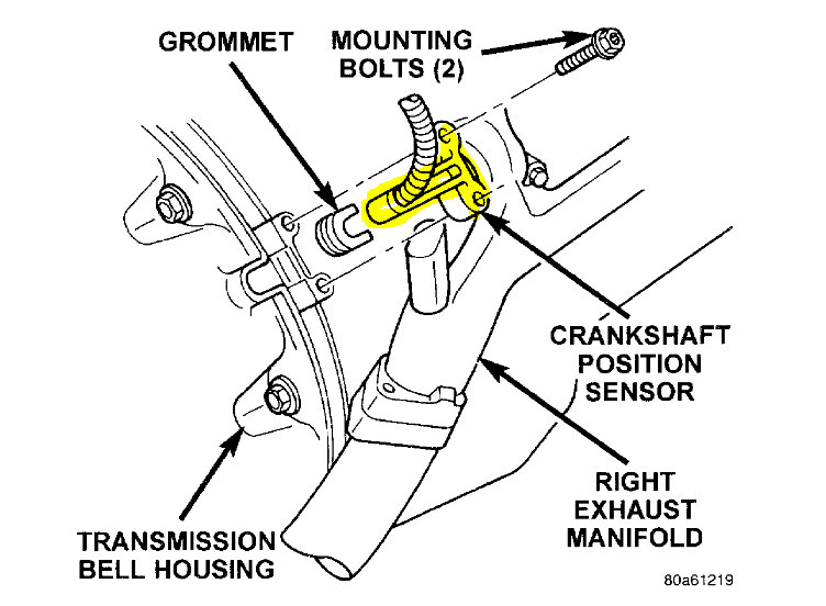

If you have no spark, then my first suspect is the crankshaft position sensor. If your scan tool has live data, see if there is an RPM signal when cranking the engine.
If it doesn't but the truck has a tachometer, see if there is any movement in the tachometer when cranking.
I attached a pic below of the crankshaft position sensor location. If there is no signal, that would be my first suspect.
See pic below.
Aug 2, 2023 at 10:33 AM
NICKI SCHMIDT
  • 6 POSTS
Okay, sorry first I apologize for being mistaken; I've since been informed the coil is good, but it is no spark to plugs. Why wouldn't the scan tool pick up on crankshaft sensor on the codes? Just curious, again I apologize but this helps me learn to know next time is all. Thanks, and we are going to my parts truck tonight for said sensors. We shall let you know how it plays tomorrow once we install them. Again, thank you very much.

A crank sensor may or may not set a code. "Because a crankshaft position sensor is related to engine speed when they fail it may not trigger a CEL light. This is because there are some things that can stop the crankshaft position sensor's signal that will have nothing to do with the sensor going bad such as running out of gas or stalling the engine when letting the clutch pedal out too quickly."

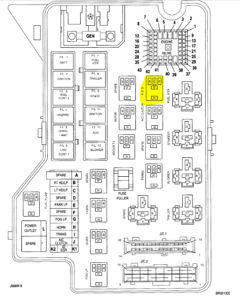

If you lost fuel, my first thought is there is an issue with the automatic shutdown relay (ASD). However, that doesn't explain no spark.
On the other hand, if there is no ignition, the vehicle is designed to shut off the fuel to prevent damage or flooding.
Do me a favor. I attached a pic of the under-hood fuse box and highlighted the ASD relay. Switch it with a different one having the same part number. If there isn't one, here is a link that explains how to test it:
Let me know what you find.
joe
See pic below.
Sep 4, 2023 at 2:15 PM
NICKI SCHMIDT
  • 6 POSTS
Okay Joe, I've already done that, nothing changed. Now I've also been told my cam sensor is probably bad. My current battle seems to be maybe something else too... Okay, so, I took my battery to get it tested and charged up again. Tested good, brought it home put in truck tried cranking it a few times maybe 3 then let sit couple days had other things to get to so that's why else I'm slowed up in timing here. But I'm trying, so what would have caused my battery to drain that quickly? I have never had any problems with this until now as well. But I am stuck like chuck with no clue where to go but all your help is definitely appreciated. This is our only transportation so it's hurting us badly. Thanks again

When you checked the ASD relay, did you confirm the circuit is working? In other words, there should be two power supply pins and a ground path provided by the PCM. Did you confirm they were all present?
