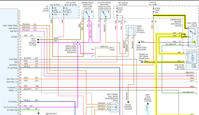

Okay, so I am not hearing the fuel pump when I key the ignition. I had a similar problem a few months back. Thinking it was the fuel pump I replaced it, the fuel filter and also the pressure regulator and fuel pump relay. I still had the same problem and replaced the control module. Eventually I found a wire was grounding out on the bracket for the oil fill tube and it has been running great since. I replaced the orifice tube and accumulator Sunday and recharged my A/C. drove to my fathers house and back about 35 miles and when I turned left to go up the hill to my house it suddenly just shut off and had to have it pulled to the house. It will run for a few seconds with starting fluid so I know it's fuel related but thinking electrical. Where should I start? I took out the bolt on the left rear frame and cleaned everything for the ground there when I first had this problem a few months ago.
Jul 20, 2020 at 10:15 AM
  • 110,240 POSTS

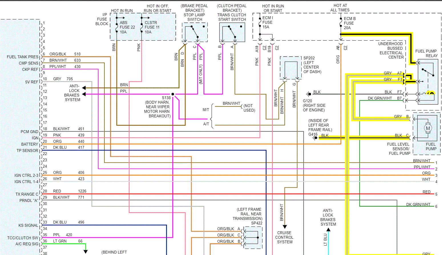

Okay, lets start at the beginning. First, confirm there is power at ECM B fuse which is hot at all times and sends power to the relay at all times. If the fuse is good and has power, confirm power to the relay. See the attached pic.
Now, if you look at the pic, you see a gray wire that feeds power to the pump and injectors. I need you to jump the power wire to the relay with the gray wire to the pump. Do this and see if the pump turns on.
Jul 20, 2020 at 11:32 AM

Okay, had power at ECM B and relay jumped it and no fuel pump. If I was just checking the ECM fuse and fuel pump relay I had already swapped out other relays to no avail. Next?

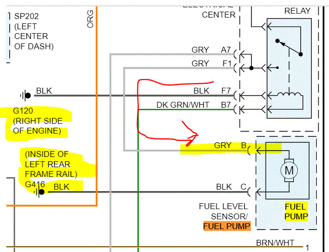

By jumping that, you sent power direct to the fuel pump. If it didn't turn on, either the wire between the relay and pump is broken, the pump is bad, or there is no ground.
What needs done now is to check at the pump to see if power is available for it. Even if it was a sensor, the PCM would power the pump for 2 seconds to prime the system. Then, if there was no ignition reference, it would shut it down. However, you ran power to it and it didn't turn on.
I attached and highlighted the grounds and the power wire at the pump. Check the grounds and see if there is power to the pump. Note that there will only be power for a couple seconds when the key is first turned on. Or, if you jump the relay again, it will have constant power.
Check these things and let me know what you find. If you have power and the grounds are good, the pump is bad.
Jul 21, 2020 at 3:01 PM

Looks like the pump has gone bad. I raised the bed and hooked a wire up directly to the battery and when I touched it to the gray wire I could hear the pump try to start. I guess you get what you pay for, this pump is only a couple of months old which I bought new on Amazon. I may have to bite the bullet and get an AC Delco one. Thanks for your help!

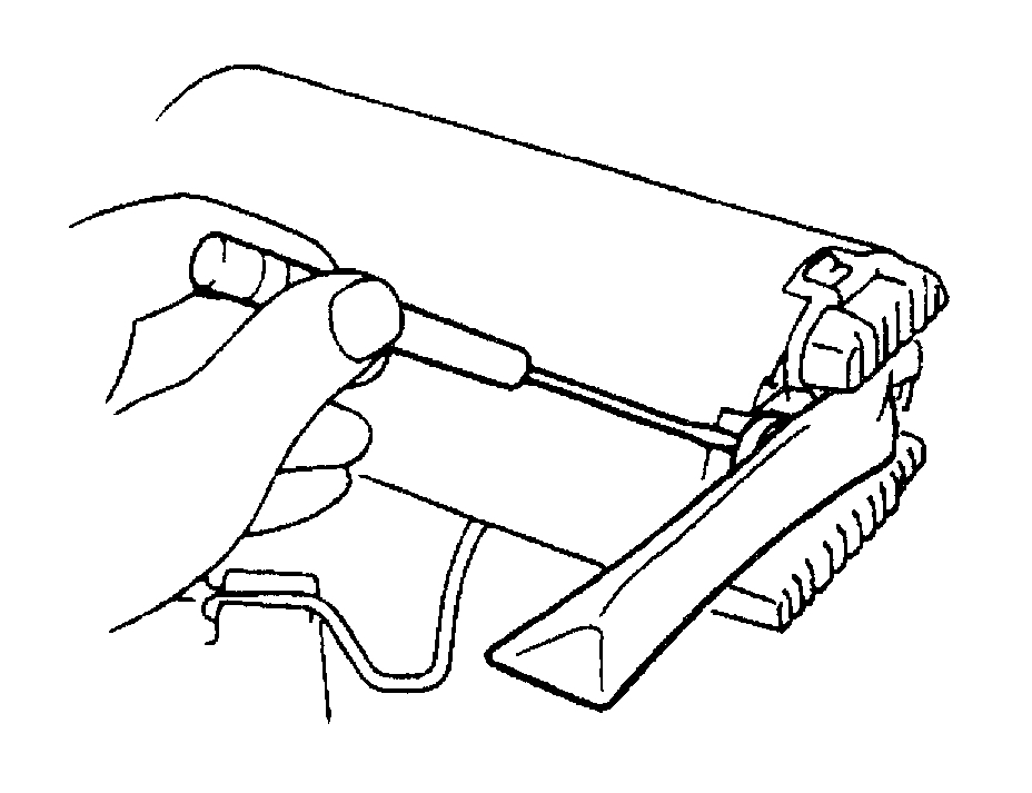

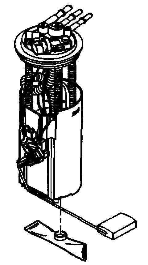

When you replace this, make sure to replace the strainer as well. Here are those directions and the attached pics correlate with them:

Fuel Pump Strainer
Vehicle Power-train Management Fuel Delivery and Air Induction Fuel Pump Pickup Filter Service and Repair Procedures Fuel Pump Strainer
FUEL PUMP STRAINER
pic 1
pic 2
Removal Procedure
1. Relieve fuel system pressure. Refer to Fuel Pressure Release Procedure.
2. Drain fuel tank. Refer to Draining Fuel Tank.
3. Remove the fuel tank. Refer to Fuel Tank.
4. Remove the fuel sender assembly. Refer to Fuel Sender Assembly.
5. Note strainer position for future reference.
6. Support the reservoir with one hand and grasp the strainer with the other hand.
7. Using a screwdriver to pry the strainer ferrule off the reservoir.
8. Discard the strainer.
Installation Procedure
1. Install the new strainer to reservoir.
2. Support the reservoir with one hand and grasp the strainer with the other hand twisting the strainer into position.
3. Install the fuel sender assembly. Refer to Fuel Sender Assembly.
