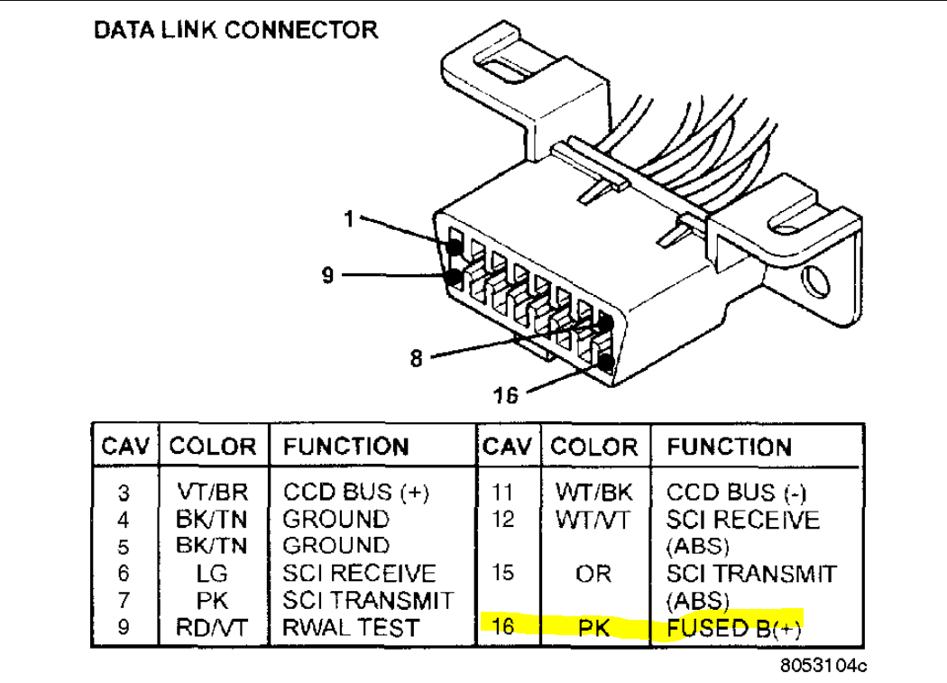

I went to get my truck smog and it didn't pass because they said that the check engine light didn't come on and that the obd2 scanner couldn't communicate. I don't know how to fix it.
Jan 4, 2020 at 6:38 AM
  • 110,248 POSTS
What I need you to check is for power to pin 16 on the data link connector under the dash. I attached a pic below to help orient you with its location.
Simply use a test light to see if it lights indicating there is power. Here are a couple links you may find helpful:
Also, let me know if the truck is running properly.
