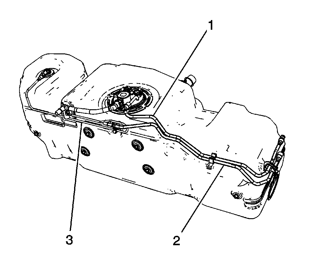

Here's the deal: I got my old welding truck that I use for taking garbage to the dump in and the other day I went to go fire it up and nothing. Battery was almost drained flat and block heater wasn't working. No big deal though as she's always started for me after a quick boost before, but not this time as she cranks over, but just won't fire!!! Anyways were on day 4 and still can't get it going, almost like it's not getting fuel which I already checked the fuses, relay and the fuel pump. Everything is all good!!! What I did notice though when I checked the fuel pressure regulator is there wasn't any fuel coming out. Shouldn't there be fuel coming out when a guy takes that cap off and pushes it in?? I'm thinking it's froze up underneath, could that be a possibility? Fuel filter possibility even too!!! Any help or suggestions would be muchly appreciated!!! Thanks!!!

There should be fuel there when you try to release it. It sounds like either something is frozen or the fuel pump is bad. What I suggest is to check fuel pressure. However, if you are pressing the Schrader valve on the fuel rail and there is nothing, then there is no pressure.
Try this trick. See if it starts for a couple of seconds using starting fluid. If it starts and then stalls, we will have confirmed it is a fuel related issue. Or, here is a link that explains how to check fuel pressure:
If you find the fuel pump is the issue, here are the directions for replacement. You will need to remove the fuel tank, so it's not a five-minute job. Note, the pics correlate with the directions. I'll start with the fuel tank removal and then the pump directions.

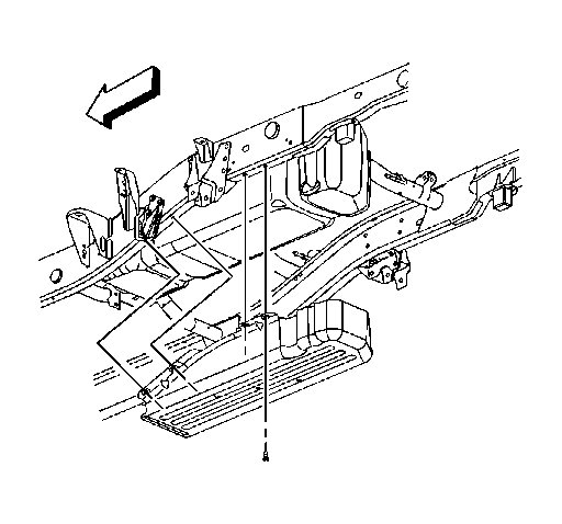

pic 1
1. Relieve the fuel system pressure. Refer to Fuel Pressure Relief Procedure.
2. Drain the fuel tank. Refer to Fuel Tank Draining Procedure.
3. Remove the fuel tank fill pipe.
4. Remove the EVAP canister vent solenoid..
5. Remove the fuel tank shield bolts, if equipped.
6. Remove the fuel tank shield, if equipped.

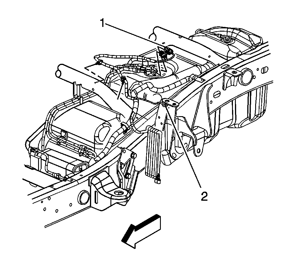

pic 2
7. Disconnect the fuel feed and EVAP lines.
8. Cap the fuel and EVAP lines in order to prevent possible system contamination.

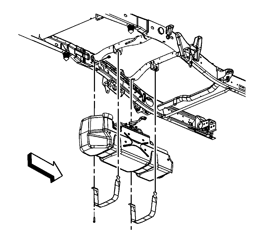

pic 3
9. Place a suitable adjustable jack under the fuel tank.
10. Remove the fuel tank strap bolts.
11. Remove the fuel tank straps.
12. Lower the fuel tank half way.When lowering the tank, ensure that the fill neck on the tank does not get hung up on the harness.
13. Disconnect the electrical harness clip at the frame crossmember.
14. Lower the fuel tank until the electrical connections are accessible.

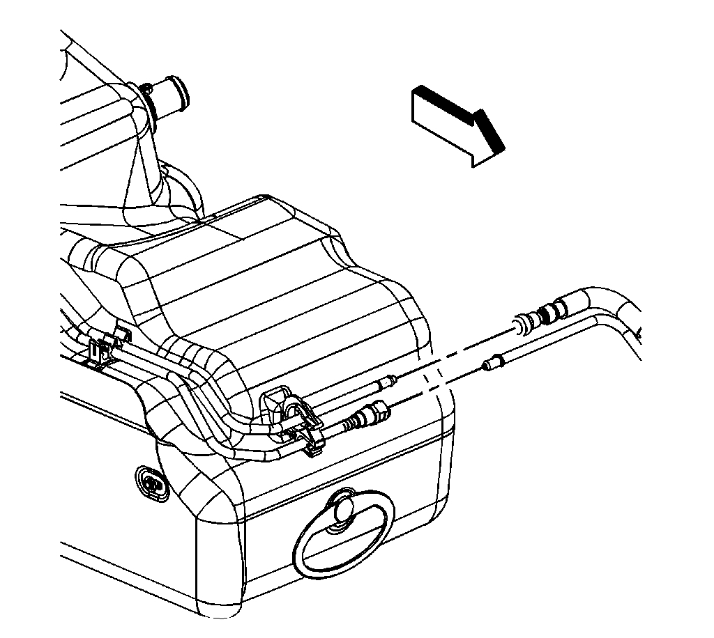

pic 4
15. Disconnect the fuel pressure sensor electrical connector.
16. Disconnect the fuel sending unit electrical connector, perform the following:
1. Disengage the gray retainer.
2. Push down the black clip.
3. Disconnect the connector.
17. Completely lower the fuel tank.
18. With the aid of an assistant, place the fuel tank in a suitable work area.
pic 5
19. If necessary, disconnect and remove the fuel feed line (1) from the sending unit and retaining clips.
20. If necessary, disconnect and remove the EVAP purge line (2) from the retaining clips.
21. If necessary, disconnect and remove the EVAP fuel level vent valve (FLVV) line from the FLVV, sending unit, and retaining clips.
22. If necessary, remove the sending unit.

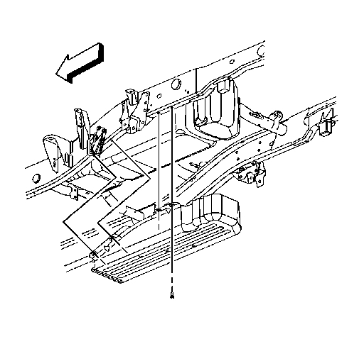

pic 6
1. If necessary, install the sending unit.
2. If necessary, install and connect the EVAP FLVV line to the FLVV, sending unit, and retaining clips.
3. If necessary, install and connect the EVAP purge line (2) to the retaining clips.
4. If necessary, install and connect the fuel feed line (1) to the sending unit and retaining clips.

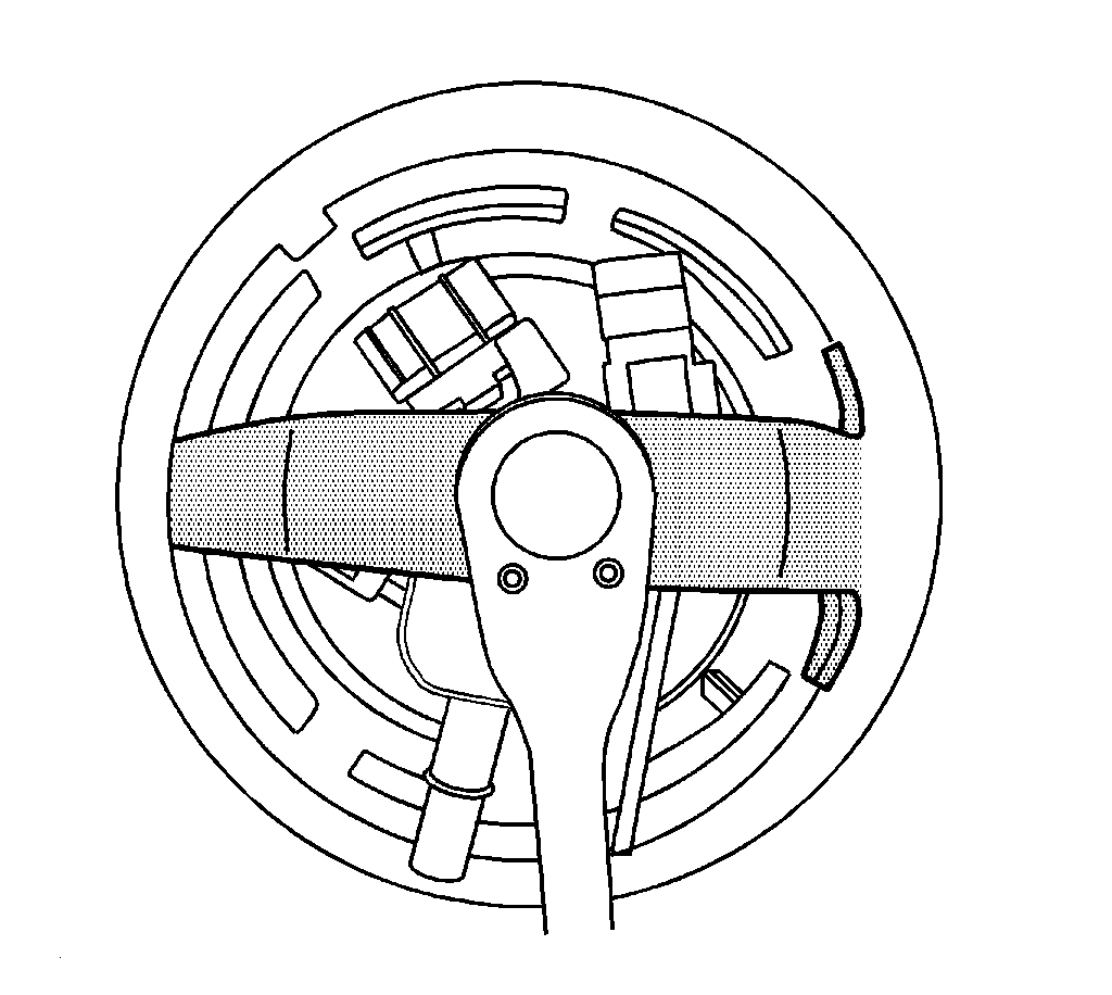

4. Using J 45722 remove the sending unit lock ring.
CAUTION: Drain the fuel from the fuel sender assembly into an approved container in order to reduce the risk of fire and personal injury. Never store the fuel in an open container.
5. Remove the sending unit and seal. Discard the seal.
