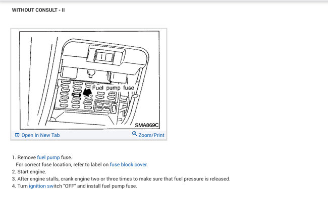

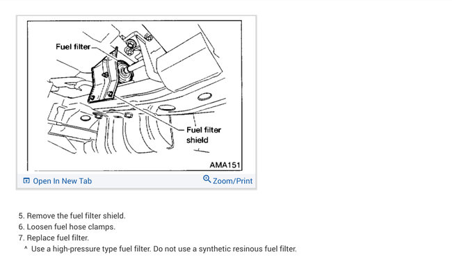

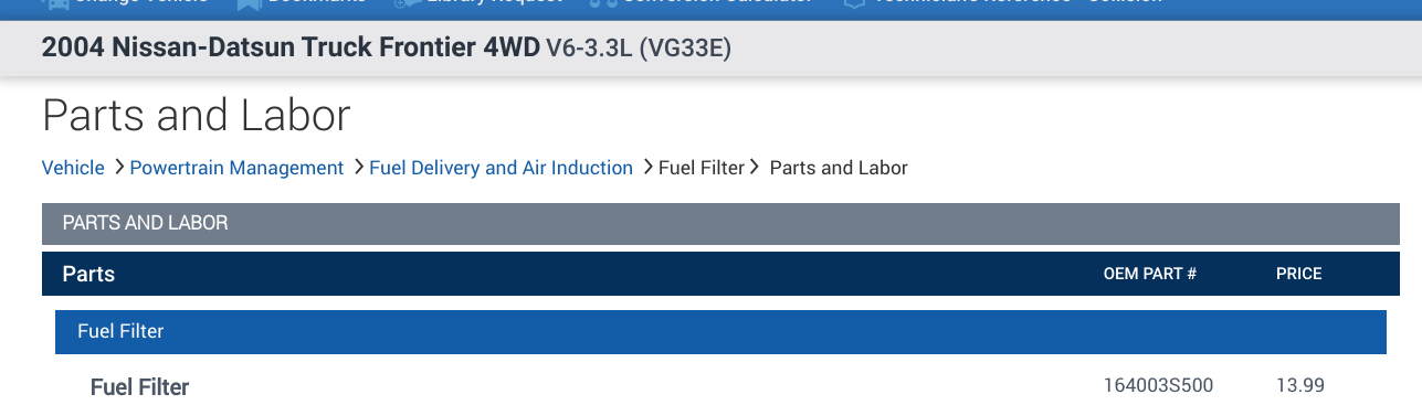

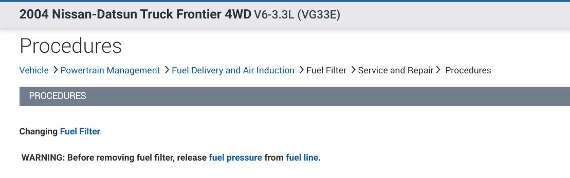

This definitely sounds like it is fuel related. Okay,so the pump starts up when the key is cycled on to prime the system. I would recommend first changing the fuel filter. In the diagrams down below I have included the Original Equipment Manufacturers part number for the fuel filter as well as the instructions for the removal and installation of the fuel filter for your vehicle. Please go through these guides and report back on how everything goes. We can go from there if needed.

Thank you very much. I'll do this first. on another note how do I release fuel pressure if the truck wont even turn over all the way? Is it possible to go ahead and just replace the filter without? Just curious.

Hello again,
The engine does not need to start to get the fuel pressure relieved. The fuel pump will be deactivated, so what fuel is in the fuel lines will be relieved through the fuel injectors with no more fuel from the pump to take its place.
