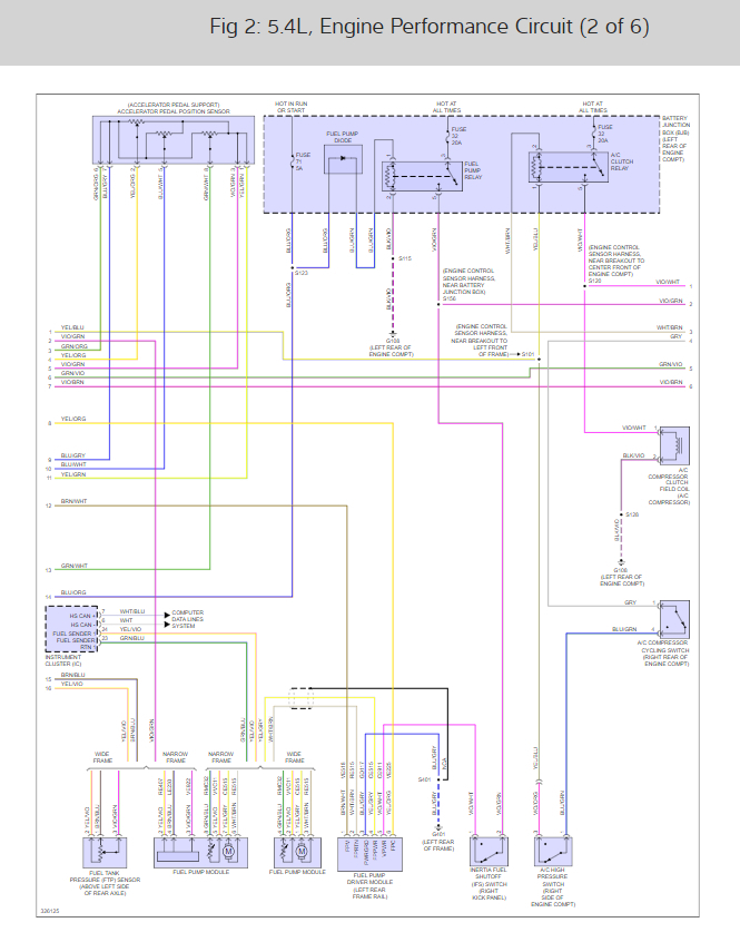

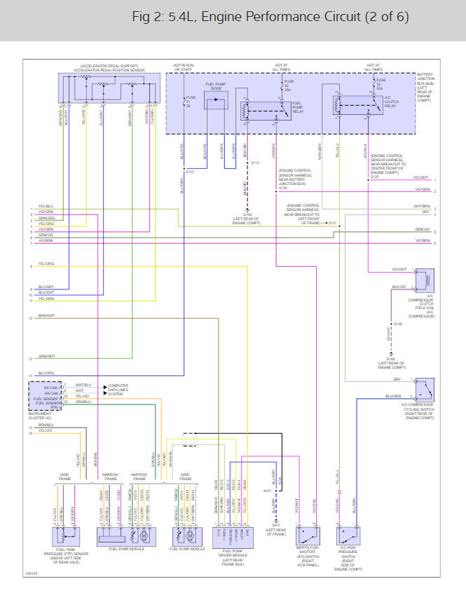

Yes, I think the fuse slot it over heated beyond repair which is causing the issue. You will need to bypass the wiring into your own fuse holder outside the PDC. Here is the fuel pump wiring diagrams so you can see what color wires to cut and splice. I show it as fuse #32 though?

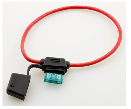

The kit from Ford is around twenty dollars and basically adds a more robust (their words not mine) pin and fuse. You will pretty much relocate it to where the square fuses are. Ken is also correct but If you want it to look stock, and for $20.00 I would use the Ford kit. And anything for $20.00 at a dealer is amazing in itself, lol.
Jan 20, 2021 at 2:09 AM
  • 55,423 POSTS
Yes, you got that right. Do the dealer fix. :) Can you take pictures of the repair other users will appreciate the help for this issue.
