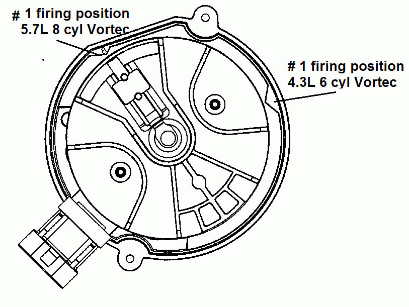

Ya, I did all that and I realized that the distributor timing was off because I forgot to mark it when I pulled it out and put a new one in. So I adjusted that but then I also realized that spark plugs wire #1 is completely messed up where it connects to the distributor. Would that cause it to not start?

I think it might have jumped time. How do I adjust it or T.D.C it

It did, well, it would run for a second then shut off. But that was before I swapped out distributors, when I pulled the old one out I forgot ta make the marks. Now it just turns over but won't fire up. I mean I know a lot about fixing vehicles and all that. But darn this is giving me a run for my money.

Okay, if you have a compression gauge take the hose and thread it in cylinder #1 spark plug hole. Turn engine over by hand clockwise until you hear air coming out the hose. That will indicate you are at top dead center. Remove the distributor cap and verify rotor is pointing as image below for 5.7L engine. If not then remove distributor and Move rotor 42 degrees counter clockwise from #1 pointer. When you install the distributor the rotor will turn 42 degrees clockwise back to its mark. Let us know if the information helped you get the timing correct.

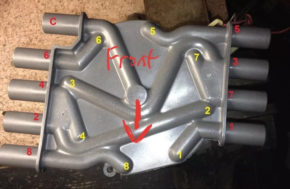

Also note. The distributor cap as you may already know I put an arrow indication front of vehicle. So the rotor picture is actually upside down. When the distributor is in the rotor needs to point to #1 on cap. Good luck and post some images once you install distributor and picture of the cap so we can make sure we are on the same page.
