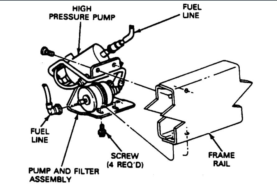

Try the fuel filter first.
The fuel filter is located on the frame rail between the frame-mounted high-pressure pump and engine.
https://www.2carpros.com/articles/how-to-change-a-fuel-filter
Did you replace the in-tank pump or the high-pressure pump at the filter?
https://www.2carpros.com/articles/how-to-replace-an-electric-fuel-pump

I actually replaced both the in tank and the high-pressure pump at the filter. I will change out the filter. Thanks for the help!
