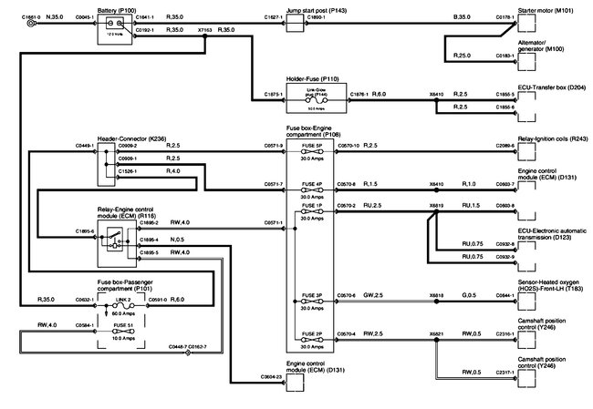

Welcome back. It is never a bad idea to check main fuses. As far as a relay, I feel you hit the important one. Do you have a live data scanner? If so, connect it to the DLC and go to RPM information on the tool. Then, crank the engine. If there is no RPM reading, I suspect the crank signal is missing. Also, check fuse 5P in the under hood fuse box. It is for the ignition coil relay. You may have blown it. Also check fuse 2P which is for the camshaft position sensors.
I attached a schematic of the wiring from the under hood fuse box. Take a look through it.
Let me know what you find.

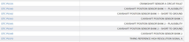

My name is Dave. I am not sure if you looked up the codes but that is the best place to start. First is code 102 which is mass air flow sensor which should not keep the engine from starting but will, however cause it to run rough. I have attached the charts for the other codes. It looks to me like the first step would be to check the wiring to your cam sensors, all of the code you have given lead me to believe there is a highly likely that there is an issue with the wiring harness, first thing I would look for is for visibly damaged wires in the harness that leads to the cam position sensors. I have attached a picture showing the location of the plugs. I highly suspect that one or more wires may have gotten pinched or damaged in the process of doing the work on the timing chain. I hope this has been helpful and thanks for using 2CarPros! Please let us know if this helps you find the issue and if not please let us know and we will be happy to help you with further steps.

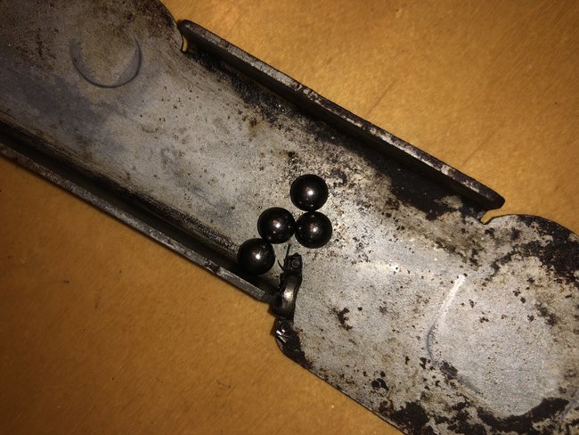

Thank you for the reply. I actually found another issue which maybe one of the main issues with the truck not starting. I checked the voltage as well as the crank sensor and that’s all fine. The p0102 code was an error on my part because I didn’t have the mass airflow sensor plugged in. Upon my visual inspection I did find ball bearings in a casing under my flywheel. I believe this could be my main crankshaft seal and main bearing which could be the issue I am having. I assume this alone will not allow any movement to the crankshaft as it does look like there are metal pieces which look similar to what I’ve researched. I have provided a picture for you to see. If my guess is right would this be the issue for my truck not starting?

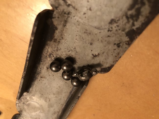

Here is another picture of the crankshaft main bearing that I found online.

I also found oil on the crank shaft sensor plug and the sensor itself along with metal shavings on the sensor due to it being magnetic.

The ball bearings are from a bearing for sure. I think you found the problem.
