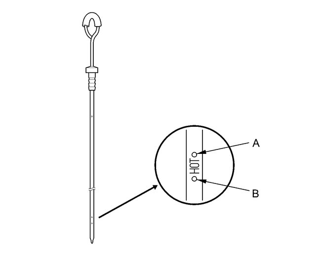

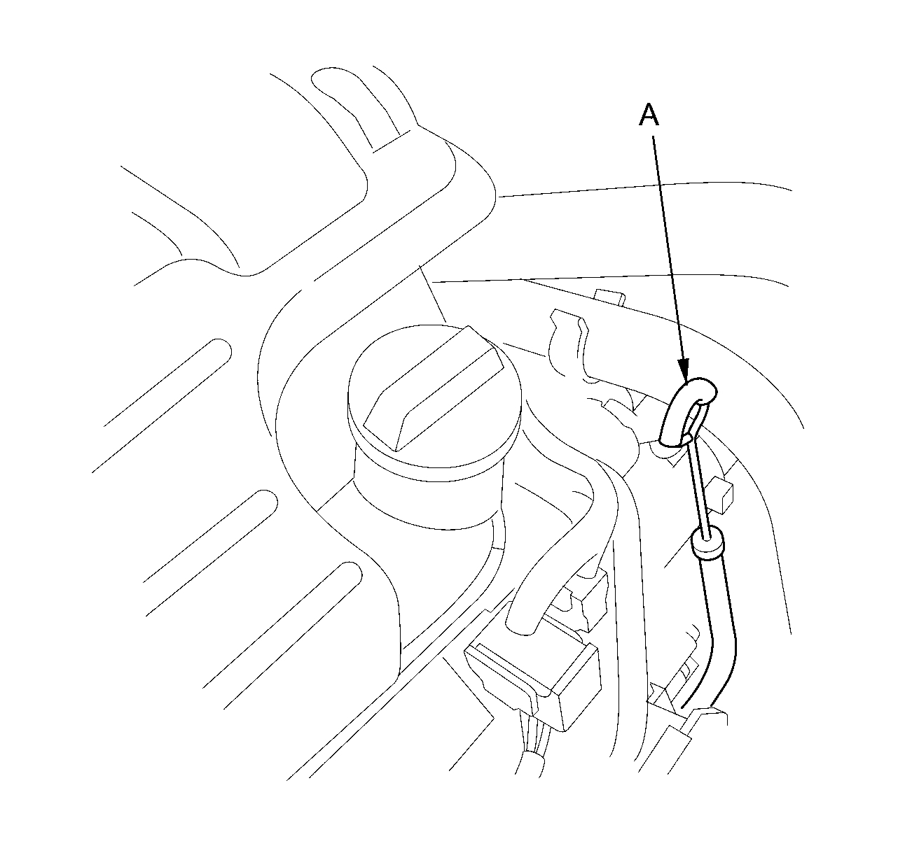

 3. Remove the dipstick (yellow loop) (A) from the dipstick guide tube, and wipe it with a clean cloth.
 4. Insert the dipstick into the guide tube.

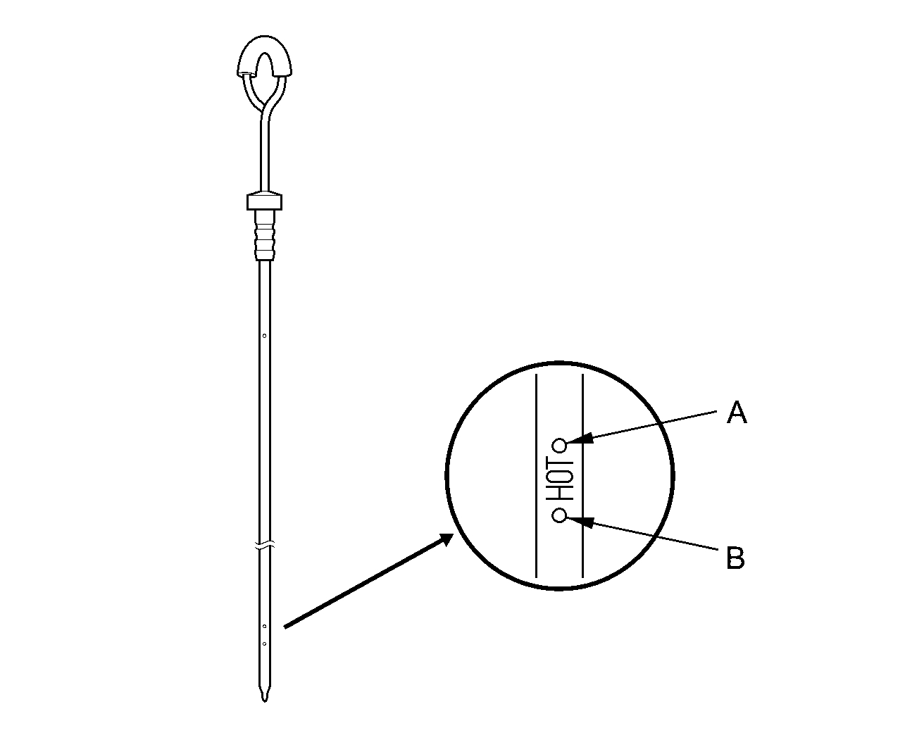

 5. Remove the dipstick, and check the ATF level. It should be between the upper mark (A) and the lower mark (B).
 6. If the level is below the lower mark, check for fluid leaks at the transmission, and the ATF hoses and the line joints. If a problem is found, fix it before filling the transmission with ATF.

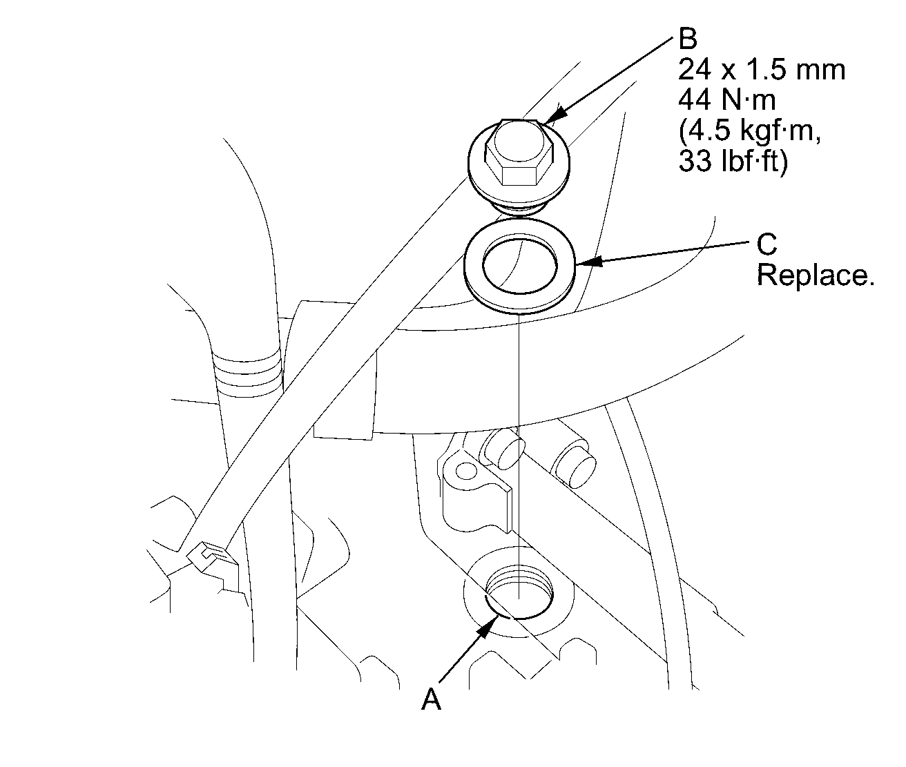

 8. If necessary, fill the transmission with the ATF through the filler hole (A) to bring the fluid level between the upper mark and the lower mark of the dipstick. Do not fill the fluid above the upper mark. Always use Honda ATF DW-1 (ATF-Z1 has been replaced with ATF DW-1, Honda Service News Nov 2010) Automatic Transmission Fluid (ATF). Using a non-Honda ATF can affect shift quality.
 9. Install the ATF filler bolt (B) and a new sealing washer (C).
10. Insert the dipstick back into the dipstick guide tube.
