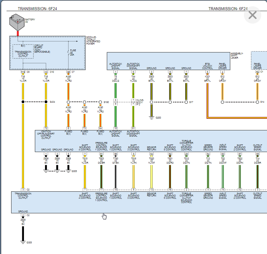

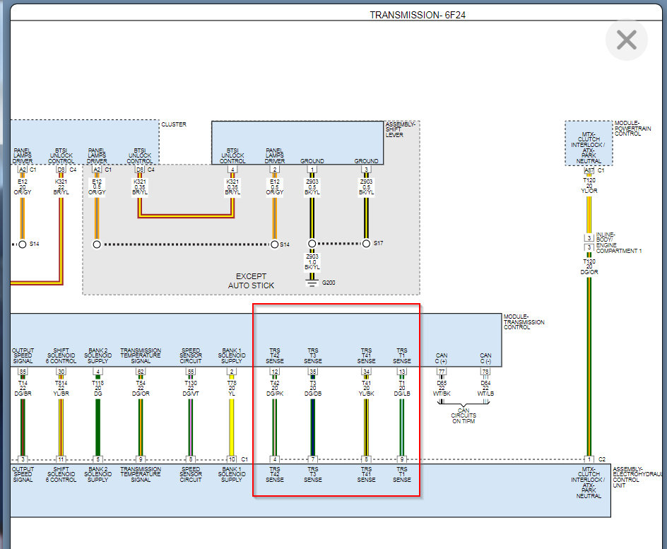

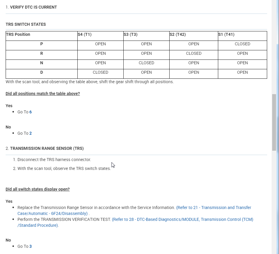

Does anybody have a color coded wire diagram for the TRS transmission range sensor?
Mar 1, 2020 at 10:21 AM

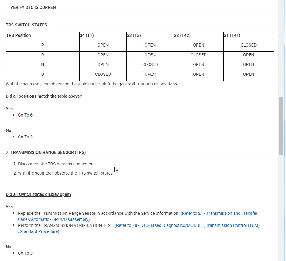

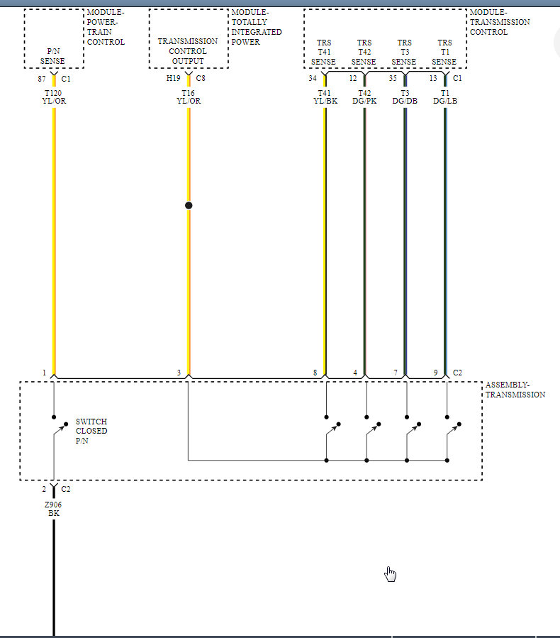

I attached the wiring diagram for the 6F24 transmission. This vehicle is a little different in the fact that it doesn't have an external TRS. It is part of the valve-body/TCM communication. The T41 is the critical circuit if you are having starting issues.
Let me know if you need more info. Thanks

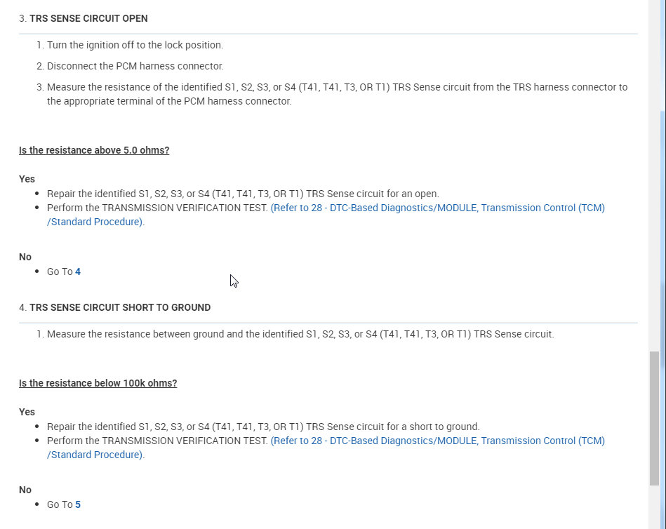

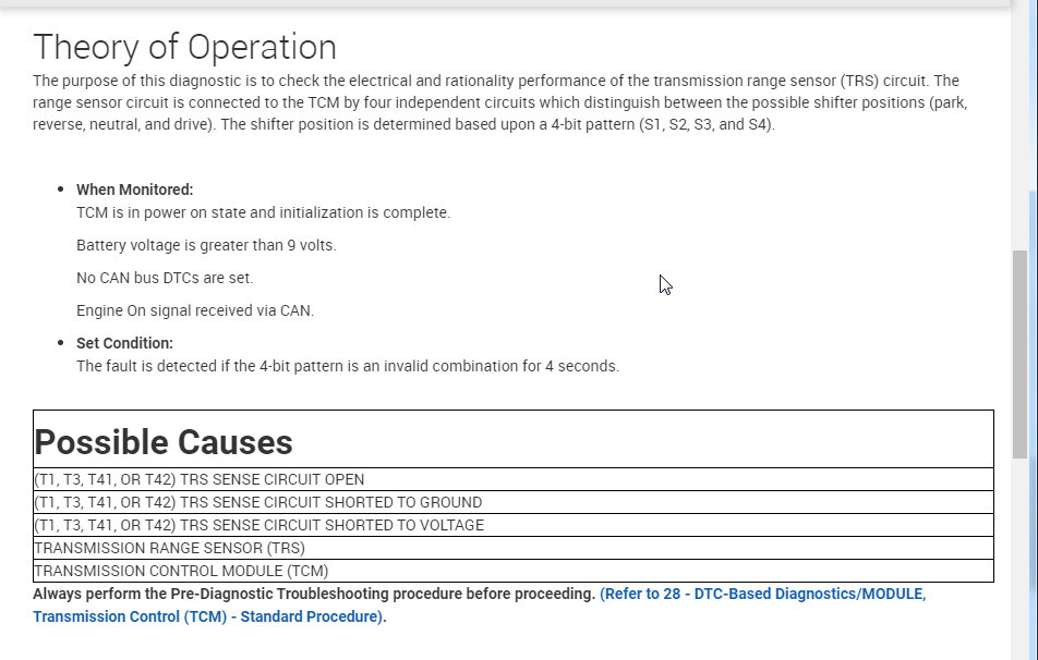

I am having starting issues. I have error code P0705 .now the connector wire that goes to the transmission range sensor the wires got really really missed up destroyed basically so I don't know the colors or the the colors of the wires or the pin locations for each each wire.
Mar 1, 2020 at 12:20 PM

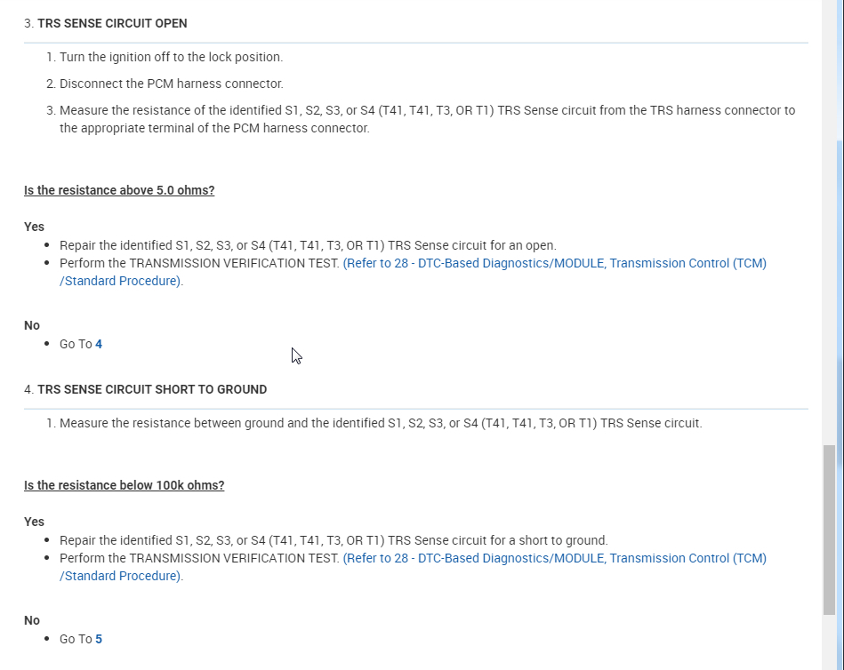

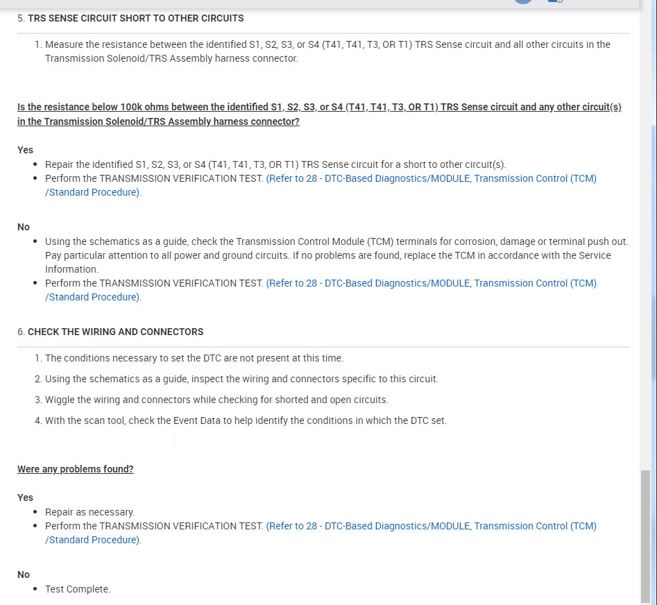

I attached the diagrams for this code but it sounds like you don't need it. This is more for others that view this that may have this same code.
Thanks for the update. Let me know if you need more info. Thanks

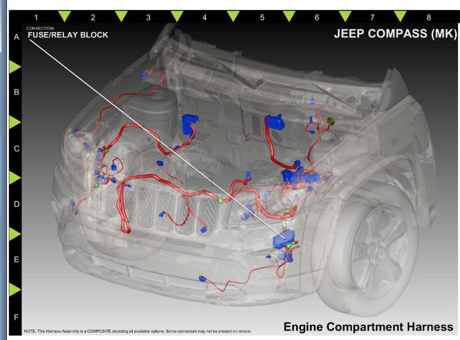

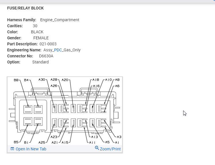

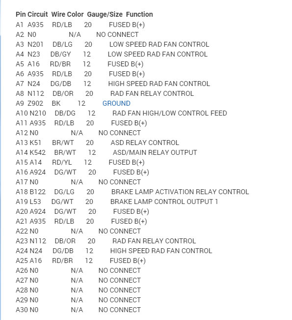

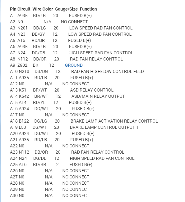

would you happen to also a diagram to the relay box?
Mar 5, 2020 at 6:55 AM
Is this what you are looking for? If not let me know and I will get you more info. Thanks
