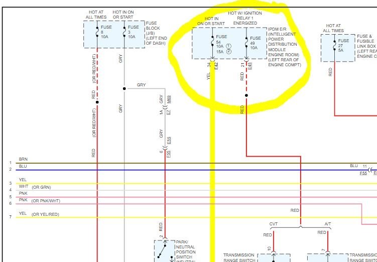

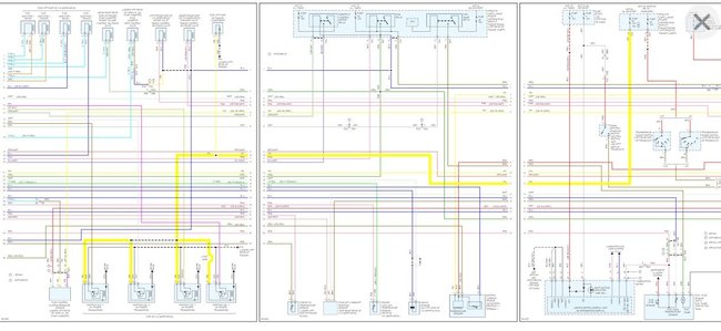

The shop just called and said there is no fire to the coils and they don't know why. Any ideas? The engine turns over fine and the dash is all lit up but no fire.
Apr 30, 2019 at 10:15 AM
OK, got it.
I attached a wiring diagram for you. The voltage for the coils comes from a fuse. I circled it in the diagram to be checked.
It sounds like this guy does not know what he is doing is he cannot figure something this simple.
