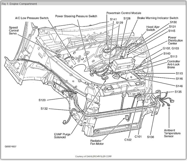

This problem is for the high speed fan relay which means the relay is bad or the relay and the fan is bad, I would start with the relay first.
Here is where the relay is located, inside of the PDC
Please let me know how it goes
