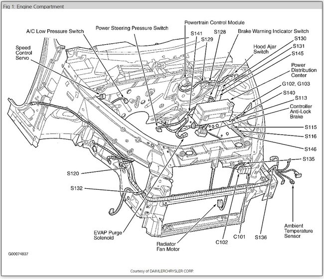

Here is where the relay is located, inside of the PDC
Please let me know how it goes
