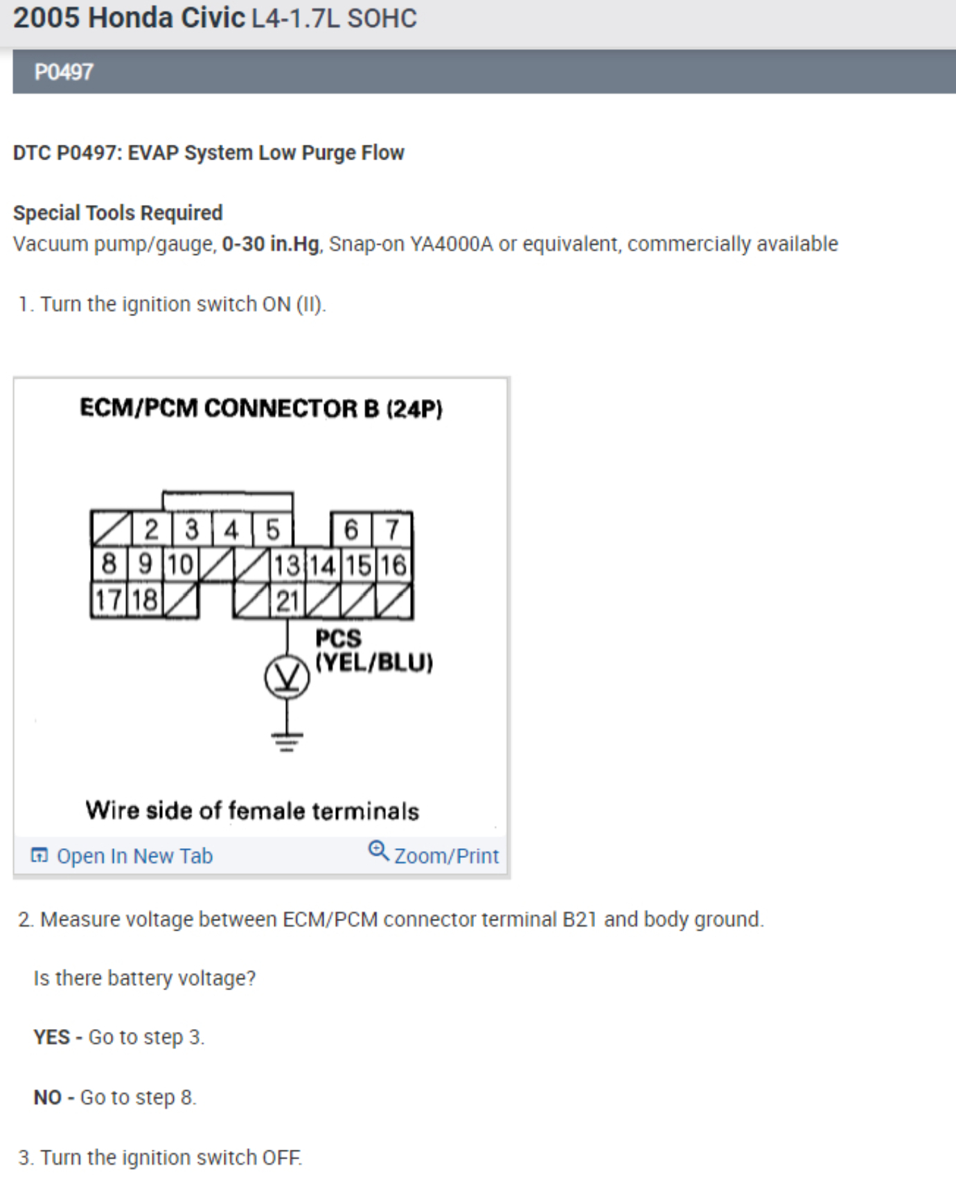

Hello
2 days ago, my car's check engine light came up. I went to AutoZone and got my car scanned. The code that came up was P0497

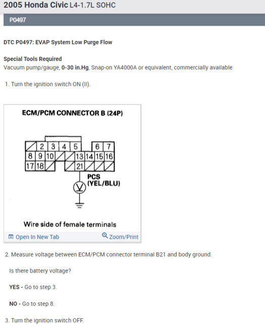

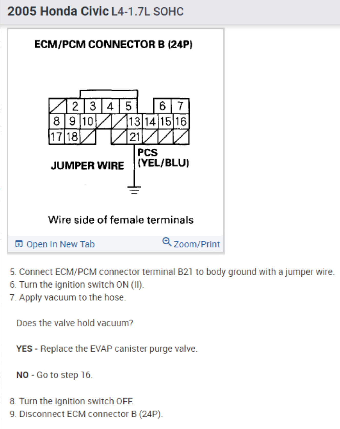

After doing a search I found a post on this website and a solution by @SQM (https://www.2carpros.com/questions/2005-honda-civic-engine-code-p0497#last) with the troubleshooting steps to diagnose the source of the problem. The steps are very detailed, and I appreciate SQM input. The only doubt I have is related to the steps that require you to measure voltage or jump a connector terminal to body ground. For example, if you look at the post linked above and the image containing step 1 (image #3) or step 5 (image #5); Is that action done while the connector is plugged into the ECM/PCM or should I pull the plug out and then do the required action.
The car listed above is an EX SP.

You should remove the connector for the control unit before testing. Here is more information on the problem:
P0497 is a diagnostic trouble code (DTC) that indicates a low purge flow in the evaporative emission (EVAP) system.
Let us know what happens and please upload pictures or videos of the problem so we can see what's going on.

I followed all the troubleshooting steps listed on the linked on my original post. All electrical components were fully functional (purge valve, solenoids, etc.,). I even took out the EVAP purge valve to double check it and its ohm readings were within specs and when necessary, held vacuum. I inspected most of the visible hoses for obvious cracks or tears but couldn't find any. I did also inspect the fuel cap and found no issues with it.
At the end, I reassembled the purge valve back into the vehicle and shortly after the check engine light went off and has stayed off. I took the car back to be scanned and the car has no active fault codes? I'm confounded by this as I really didn't do anything to "repair " the car but the code still went out. I'll keep monitoring the issue and post back if I have any updates.

No problem, no may have had a bad connection and reassembling the components fixed the issue. Use 2CarPros anytime, we are here to help. Please tell a friend.
