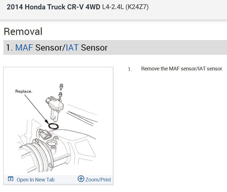

You are on the right track, the PCV valve and MAF sensor replacement should fix the problem, can you confirm no vacuum leak? If so, then proceed.
P0171: System Too Lean (Bank 1)
P0507: Idle Control System RPM Higher Than Expected

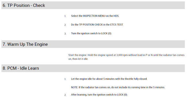

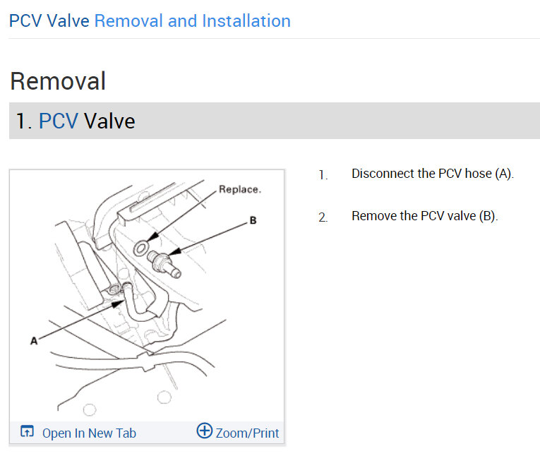

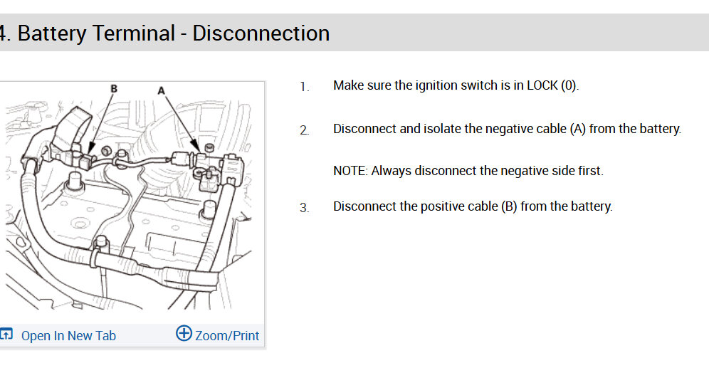

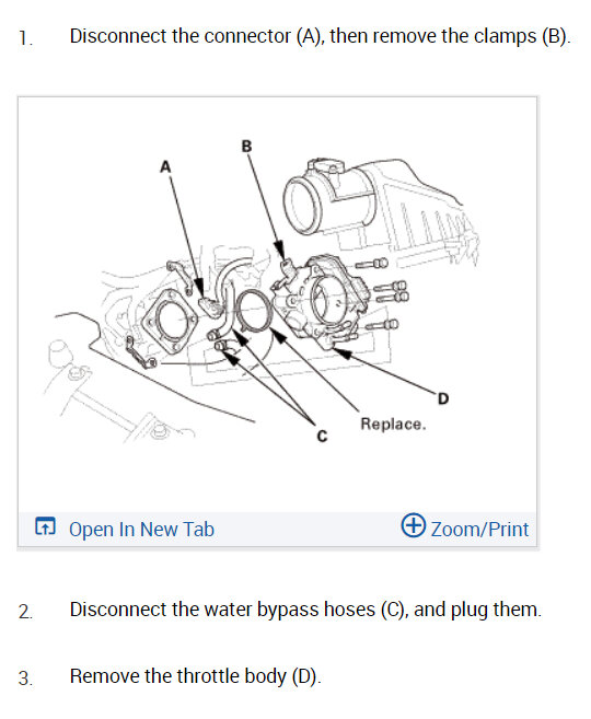

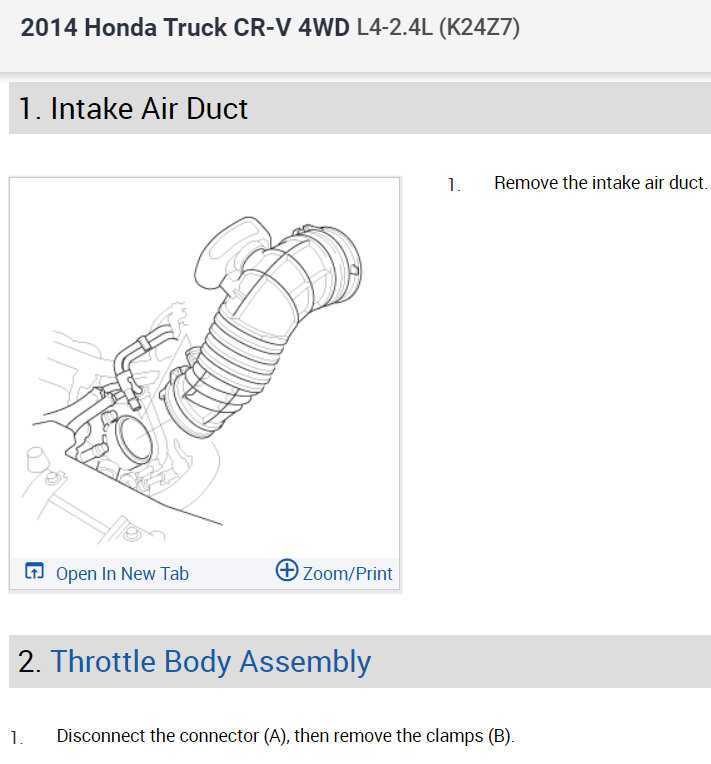

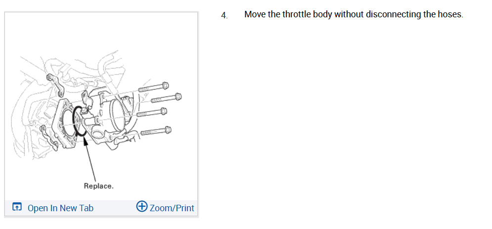

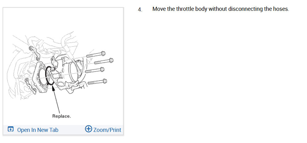

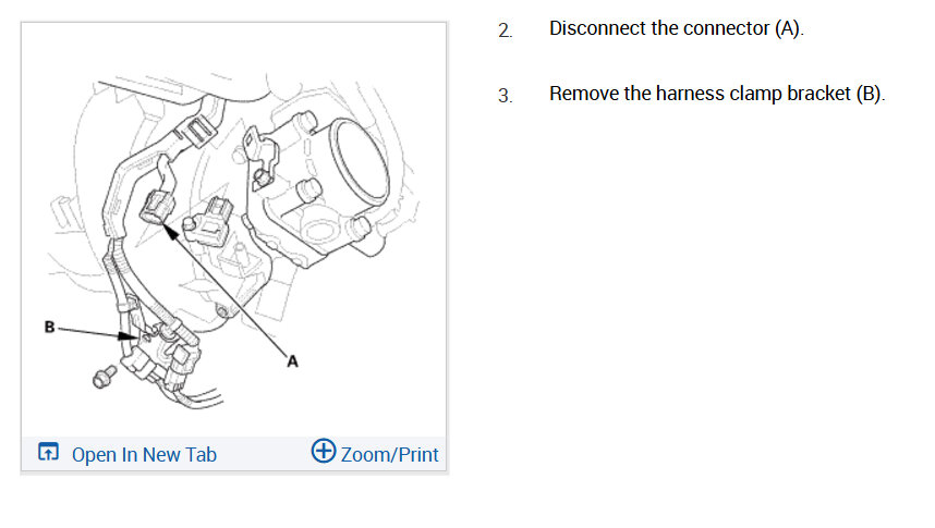

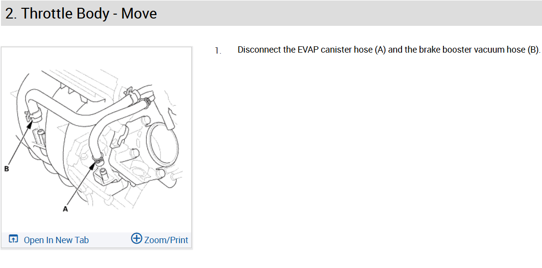

Also, with that many miles I would remove the throttle body and clean it thoroughly. Here is a guide to help with instructions for your car in the images below:
This guide can help as well:
https://www.2carpros.com/articles/repair-lean-mixture-codes-p0171-or-p0174-on-some-manufacturers
the MAF sensor once misbehaving must be replaced and cannot be cleaned to fix the problem. Check out the images (below). Please upload pictures or videos in your response of any problems so we can see what to help you with.

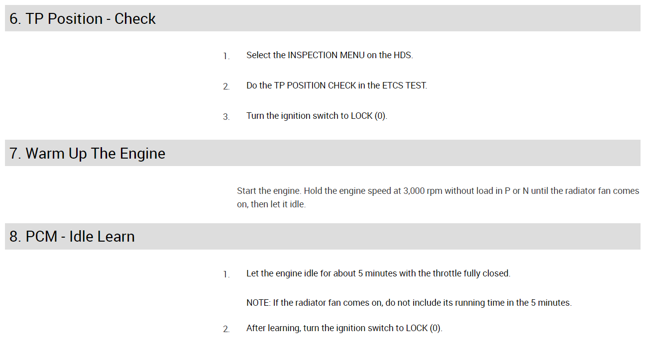

Thank you for helping me on this. So, 5 days ago I replaced the MAF (and MAP). I also ended up replacing the throttle body and tb gasket. I experienced issues reconnecting the outlet coolant hose to the throttle body [1/8" short] and I will need to replace that coolant hose later. I also had issues replacing the original PCV valve and will try again shortly with a new part. I wasn't sure how to do the TP Position check. However, I performed the relearn procedure. Car is idling much better and both P0507 and P0171 codes have not yet returned (no codes). Things appear to have improved, but the economy still is not that great (~22 mpg avg); it's like the actual mpg is always much higher than the avg mpg but doesn't raise the avg mpg much ... even on highway. Power on highway feels a little weak. While engine idles with radiator fan going on/off, the short-term trim sawtooths between 25-40% while O2 downstream inverse-sawtooths between 0.1 and 0.8 V which is much different than before; upstream O2 lambda seems OK (same as before). Could the O2 sensor be bad? I recently noticed a small cut by the purge hose where the missing b12 clip was supposed to be and will also replace that hose soon (it's taking a while to get these parts).

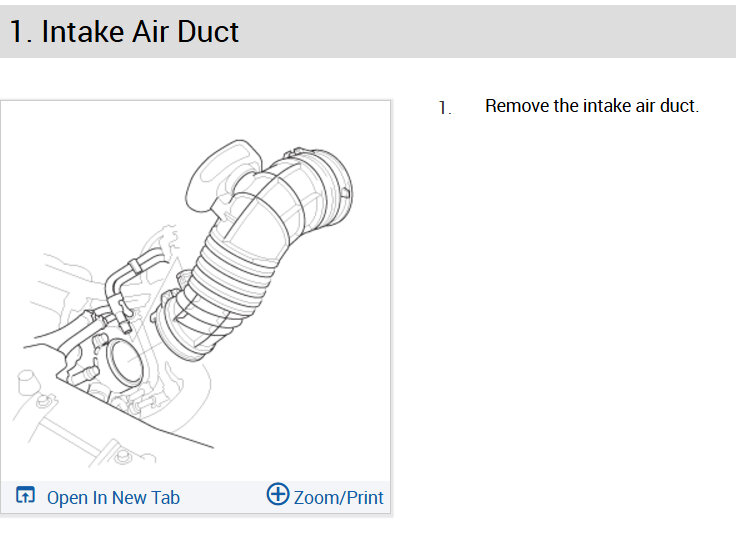

So, I first changed the PCV valve and the car drove fine for about 2 weeks before CEL P0171 returned. Avg mpg was as good as 25-26 mpg for the most part and as low as 22 mpg. Depending on how I drive (city/hwy), CEL P0171 appeared for a few car starts and then self-cleared for a few days before repeating itself.

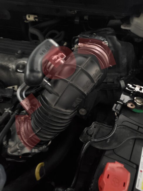

One month later, I was finally able to change out the purge hose that was cut at one of the ends. I also changed both inlet and outlet coolant lines to the new Throttle Body as well. I smoke tested airflow tube post-maf sensor [again] and did not see smoke escaping any vacuum lines. The only suspect areas I found were a few points highlighted on the air flow tube between MAF and TB (see image). Hard to say if the airflow tube and clamps are getting old.
Also, I ran the scan tool and saw much different behavior. While idling, the Short trim was 46.9% flat and O2 downstream 0.065 V flat. Sometimes when radiator fan toggles on/off, the O2 downstream toggles between 0.045 V and 0.7V while Short trim stays 46.9% flat. The Short trim is lower and much closer to 15% while driving but after stopping the short trim ramps back up to near 46.9% Tightening the clamps at both ends of airflow tube didn't seem to make a difference.

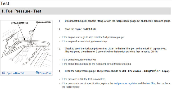

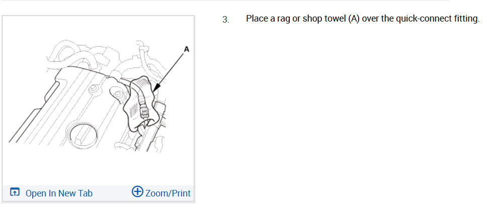

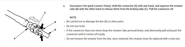

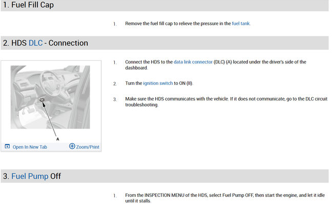

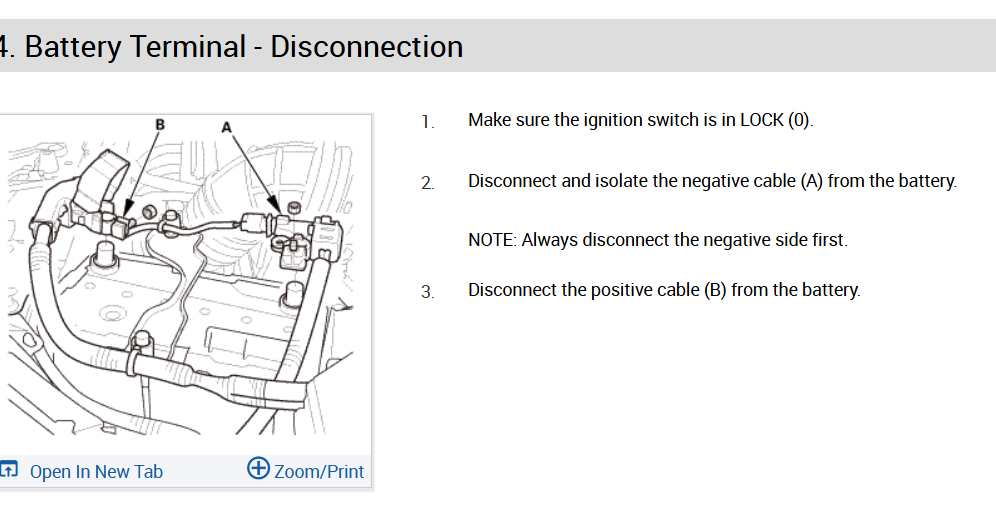

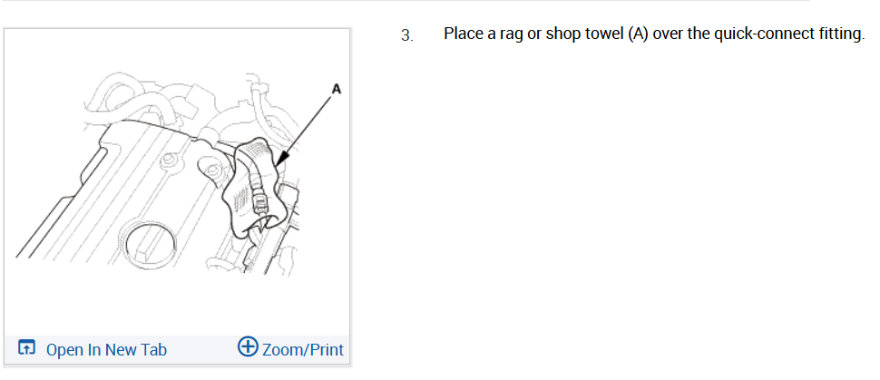

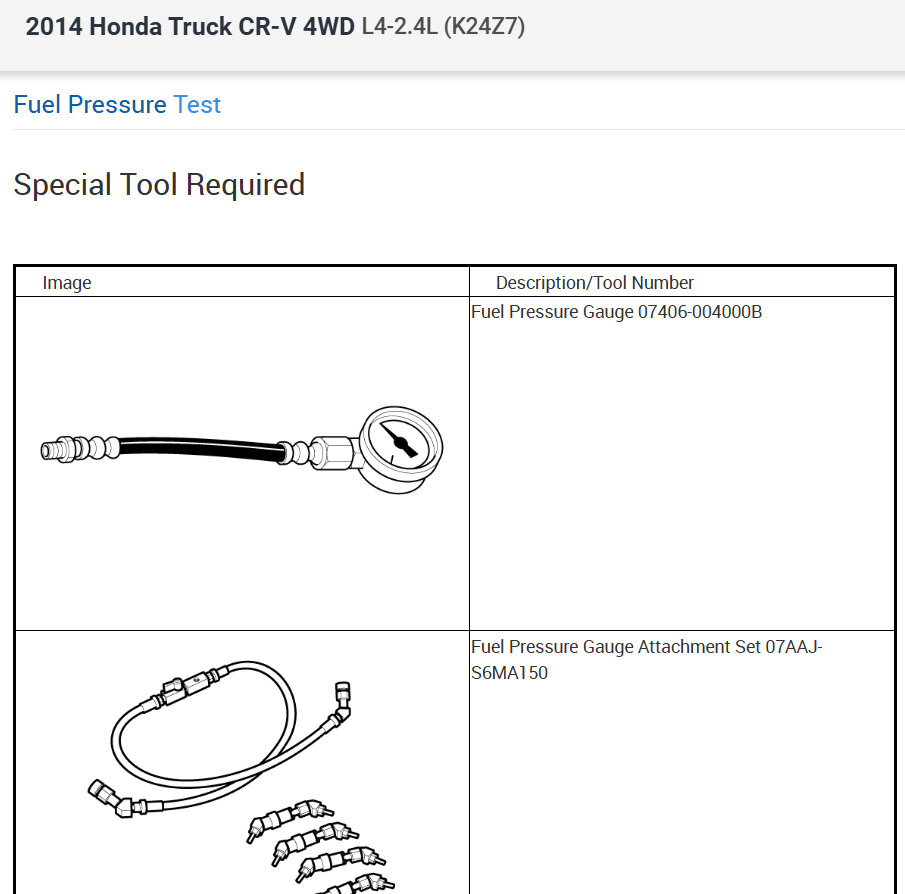

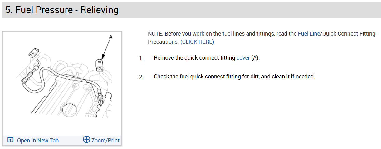

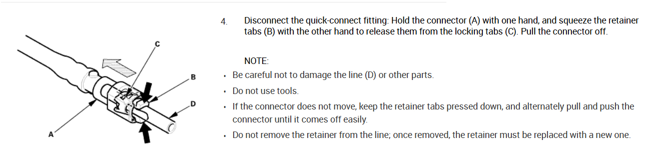

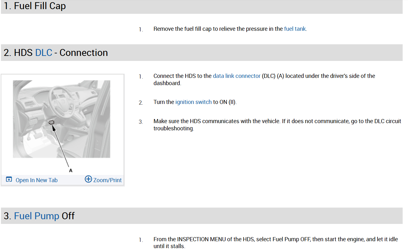

The lean trim is trying to richen up the system due to the long term trim being lean. To confirm you did replace the MAF sensor with a new one correct? We should do a fuel pressure test because the fuel pump can be lean, here is a guide to help show you how and I have included instructions on how to check the pressure in your car in the images below.
Fuel pressure should b: 47-54 PSI.

During the pressure relief, I did not have the HDS but removed the PGM-FI main relay #2 instead. The sooner I turned off the engine and then removed the relay (like right away) the more the engine idles until stall after starting engine (about 1-2 seconds from idle to stall). If I waited a couple minutes after removing the relay, then the starter would turn but the car wouldn't start which was interesting.
After setting up the fuel pressure gauge, I turned the key to II, the pressure was 50 psi for about 2 seconds then 46 psi. After starting the car, the pressure was 50 psi during idle. After turning off the car, the psi dropped to 46 psi and then within 5 minutes dropped to between 38 and 40 psi.
Nov 10, 2024 at 9:34 PM
  • 54,832 POSTS
Nice work, the fuel pressure looks okay. Can I ask if the exhaust system is leaking? This can draw outside air into the system and give a lean code.

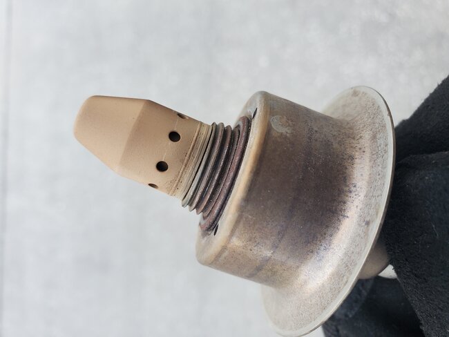

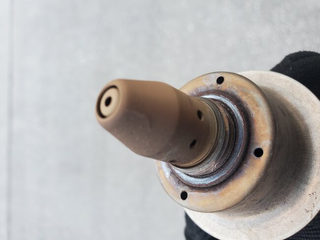

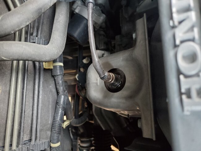

Thanks for your help on this. I swapped the primary oxygen sensor and it did not appear to make a difference on the ST Trim response. After starting, ST Trim around 17% for a few seconds and then started climbing to 46.9% as soon as the radiator kicked in.
Here are some pictures on what the original sensor and new sensor looks like. Looks like silicone poisoning but I am not sure what that means overall. I'll consider switching the sensor again with one that has the shield (OEM-like). I am not sure why some compatible sensors come with the shield and others don't.
Otherwise, I will be preparing for a PCM swap. This P0171 code is proving to be a dreaded one.

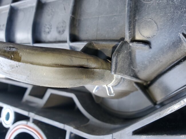

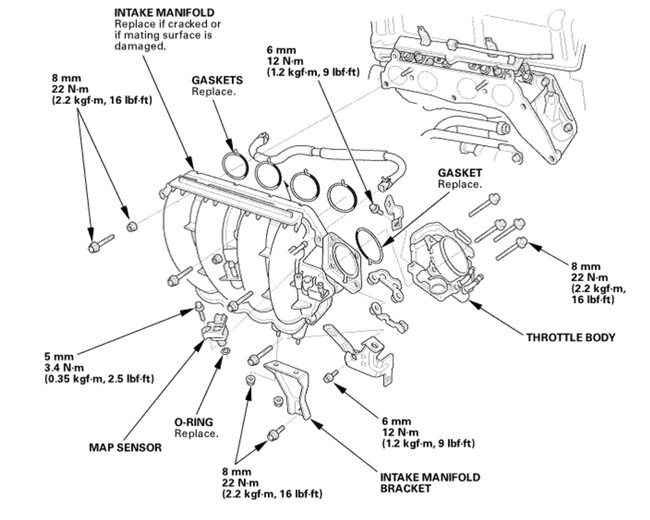

It took a while but I think I finally found the potential vacuum leak source. I smoke tested the intake again from the brake booster hose and pcv hose (after PCV valve). This time I see smoke reeking out from behind the left, center, and right of the intake manifold. I must have missed it during previous smoke test, thinking it was just the lower connection of the airflow duct tube with the throttle body.
The P0171 error code has remained intermittent throughout. I do remember seeing the check oil light flicker just once for a spilt second while in traffic a few days ago when the CEL reactivated. Same day, I ended up adding engine oil (2 qts) after checking the oil indicator (below minimum mark).
Nov 24, 2024 at 4:04 PM
  • 54,832 POSTS

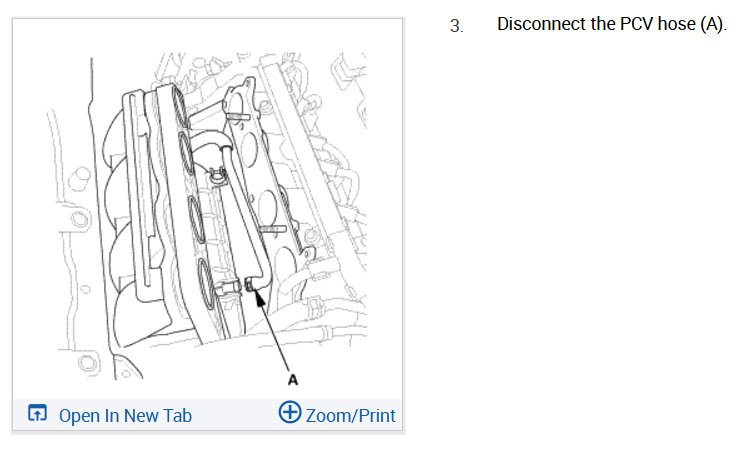

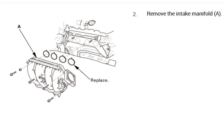

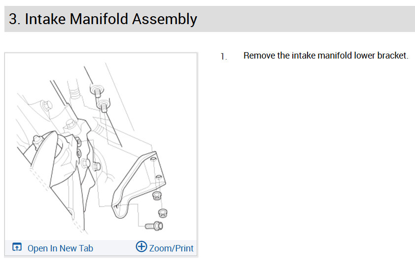

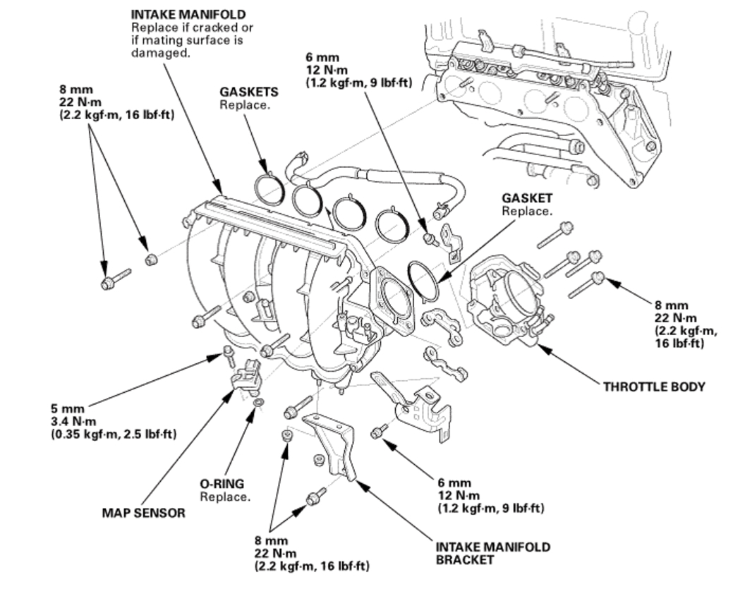

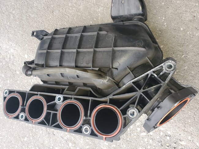

It sounds like you have some gaskets or a hose leaking down at the intake. I would remove the intake manifold for inspection. I have seen these intakes crack and leak as well so be on the looking for that. Check out the images (below). Please upload pictures or videos in your response of any problems so we can see what to help you with.
Nov 25, 2024 at 9:14 AM
LSROWE9
  • 8 POSTS
After removing the manifold, I found a crack by the elbow of PCV Hose behind the manifold connector, seems like a common issue with the OEM part. The manifold did not appear to show any signs of cracking and was reused. After replacing the PCV hose and surrounding gaskets (upper manifold and TB rings), the Short-Term trim is now well below 10% (4 to 7%) during idle. The issue appears to be fixed, finally. Many thanks for your help with this.
