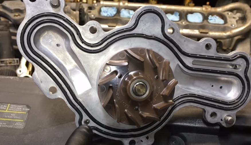

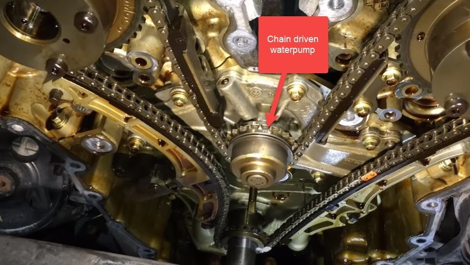

Is the cylinder five misfire code a recurring code? Or is this the first time you retrieved codes? These engines have a huge issue with water pump failures that will appear as if you have a head gasket issue because of the milky thin oil issue. This is because the water pump is driven by the timing chain and will leak coolant directly into the oil pan because of it. The cylinder five misfire code could be just because of a separate issue, but if the water pump has not been replaced I would replace it if it were my vehicle. Has the water pump been replaced?
