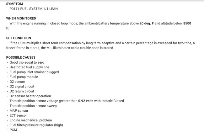

What to look at for a P0171 code?
Nov 28, 2019 at 2:56 AM
SCGRANTURISMO
  • 4,897 POSTS
This is a Direct Trouble Code [DTC] for your fuel system being to lean, or not supplying enough fuel. In the diagrams down below I have included a description and possible causes for this DTC for your vehicle. I hope that this helps. Please get back to us with what you are able to find out.
