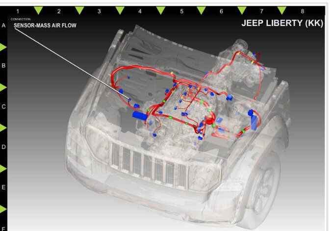

This can be a weak fuel pump, a partially clogged catalytic converter or a bad MAF sensor. If you have a scanner, you can read the MAF sensor to see if it is below these reading at idle.
0.8 - 1.2 grams/second (g/s)
Please go over this guide as well:
https://www.2carpros.com/articles/engine-has-low-power-output
Here is the sensor location in case you need it. Check out the images (below). Let us know how it goes.

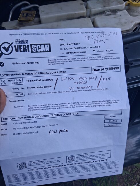

The check engine light is back on when I got it tested before I did the spark plugs and coil packs. It was reading the O2 sensor. so, could this be the reason the check engine light is back on?
Jun 25, 2025 at 6:20 AM
  • 55,770 POSTS
It could be, what is the code you are getting?
Jun 25, 2025 at 11:15 AM
JUDIESIMMONS92
  • 19 POSTS
This is what was read off before I did the spark plugs and coil packs.
Jun 25, 2025 at 12:17 PM
JUDIESIMMONS92
  • 19 POSTS
I also did the 2-cylinder fuel injector.
Jun 25, 2025 at 12:18 PM
  • 55,770 POSTS
Yep, the oxygen sensor code can be from the cylinder misfire. Lets remove the spark plug on #2 and do a compression test, this guide can show you how. Also, you can rent the gauge set at the auto parts store for free.

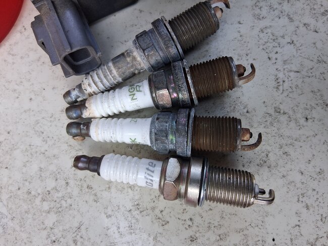

This was what the driver side spark plugs look like there's only one new one which is on the far side the ones starting from the right side are the ones that I pulled out of the driver side.
Jun 26, 2025 at 11:43 AM
  • 55,770 POSTS
Wow, those spark plugs are worn out! After you replace all of the spark plugs, I would clear the codes and go from there, which could be all of your problems. I would service the throttle bore and replace the MAF sensor as well.
Please go over this guide and get back to us.

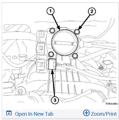

What is the throttle bore and where is it located and how do I replace it?
Jun 28, 2025 at 4:22 AM
  • 55,770 POSTS
The throttle body is bolted to the intake manifold. Check out the images (below). Let us know how it goes.
