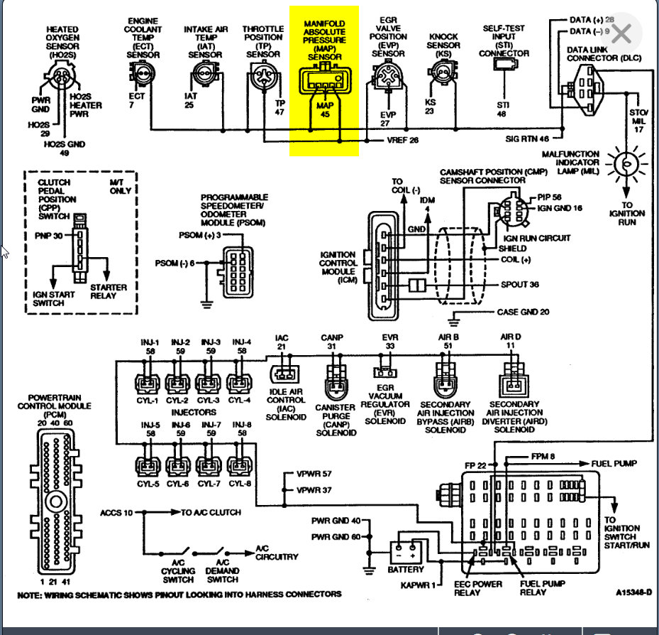

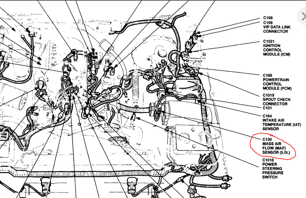

Does a 1995 Ford F150 xlt 4x4 has MAP sensor or a maf sensor?
Nov 11, 2019 at 11:46 AM

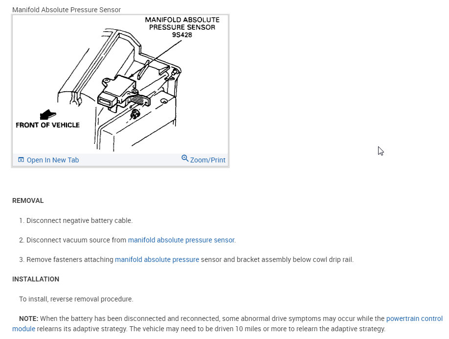

This has a MAP sensor. See the attached info for more detail. Let me know if you have more questions. Thanks

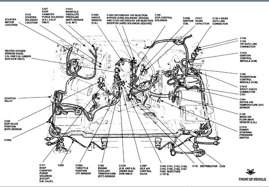

Your truck has a MAF (mass air flow sensor) It's located on the left side of the engine compartment circled in red. I've attached 2 pictures below of its location.Hope this helps and thanks for using 2CarPros.
