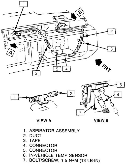

Troubleshooting error code f13.
Oct 22, 2018 at 12:20 PM
  • 110,251 POSTS
The code you have is related to the in car temperature sensor. Check the component to make sure there are no wiring issues or loose connections.
Here are the directions for removal. The attache picture shows its location.
REMOVAL
Component Locations
REMOVE OR DISCONNECT
1. Upper trim pad. Refer to Instrument Panel.
2. Aspirator hose and electrical connector.
3. Screws and sensor.
Install is the opposite of removal.
