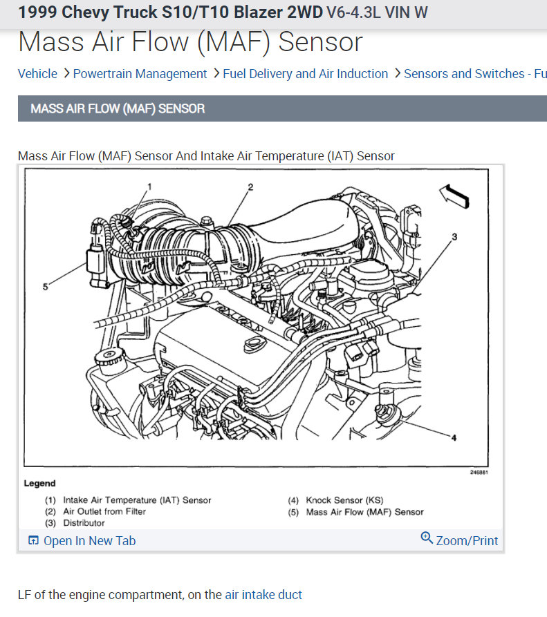

I've already drained the tank, and the only code that came up was for the MAF sensor. I can't see that not letting it run. Can you explain how it ran for a half hour or so just by actually choking it on the throttle body? I've never seen anything like this before. Thanks
Apr 2, 2021 at 12:51 AM
  • 55,628 POSTS
the MAF sensor can cause this issue. If the sensor stops working the computer sees the engine not running and cuts the fuel delivery. Here is a guide to help you step by step with instructions in the diagrams below to show you how on your car:
https://www.2carpros.com/articles/how-to-replace-a-mass-air-flow-sensor-maf

Well, I appreciate the input Ken.I replaced the MAF sensor and still no good. So far I've replaced the fuel pump and filter. Replaced the spider injection, ECM, Crank position sensor, IAC sensor, MAP sensor. The guy I bought it from did a hack job on a radio install. I redid the wiring back to stock, no radio yet, but no matter what I've done it will only run on starting fluid. I don't know where to go next. It's only got just under 170,000 miles on it. Where next? Help
