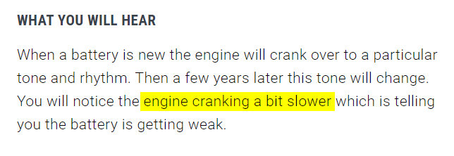

If I can jump in and just ask to clarify some points that you made? When you say the battery was tested we need to make sure it is load tested and not just have a meter put on it to measure the voltage. Not suggesting that is what was done but we need to make sure that is how we test it. Here is a guide that talks about this:
Next I agree that this definitely sounds like a battery issue. The slow starting is normally the first sign. Here is a guide that covers this and specifically talks about this. Please click on the link but I highlighted and attached the specific portion where it mentions this.

This is so very helpful. I was all stressed it was the starter and I was going to get stranded somewhere. And they were going to charge me a ton for it too. I'm not sure I'm going to go back to the first dealership, they messed up my brakes at one point too. I will keep driving the car and see how it does, it was the original battery in there, so 4.5 years old. I will certainly let you know if there are any more problems. It was practical to see how to load test a battery and to look for corrosion and bulging. I'm so thankful there are services out there like this. I just don't know much about cars. This was quite educational!!
