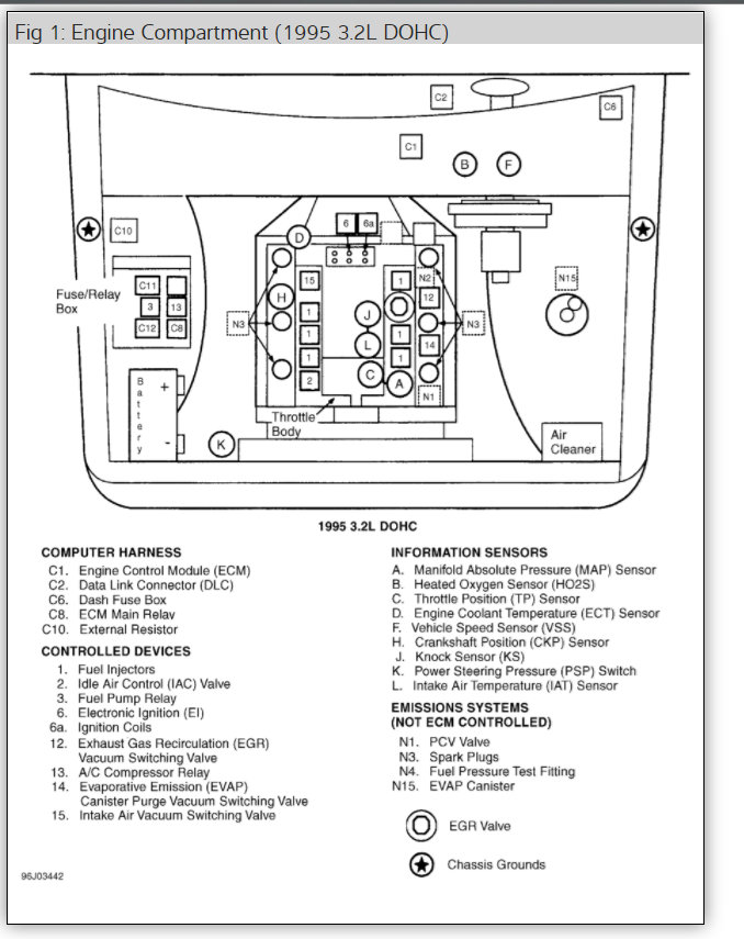

I changed the valve cover gaskets because of leaks and put everything back together. It started just fine even with a damaged a vacuum sensor that is located underneath the coil pack row. It was not driven and when I replaced the sensor, it would not start and if it did, it was at very low rpm's and when I would give it gas, it would shut off. It was a used car I bought with about 150,000 miles on it so I tried the coil packs, plugs, and plug wires. Nothing, same result. Then I did the timing belt, tension and idler pulley's, tension-er, and water pump. Nothing. Now, the "check transmission light" is on. It never ran good after initial start up after changing the valve cover gaskets and it was running just fine before that.
Any suggestions?

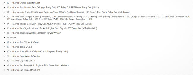

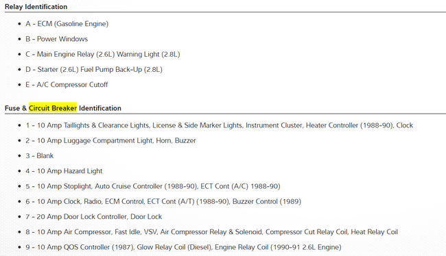

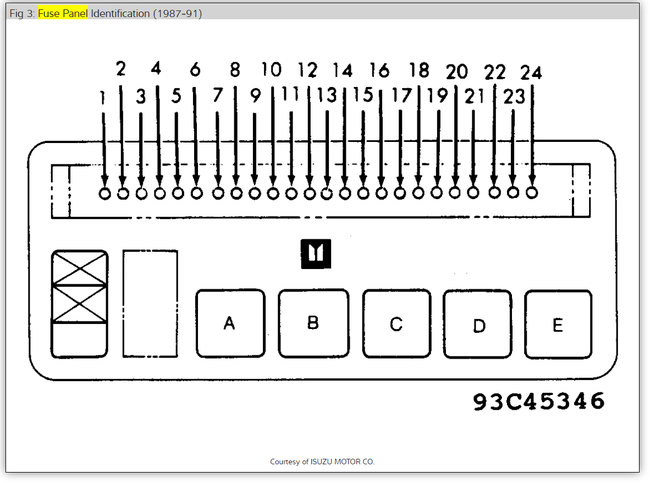

We need to fix the check engine light first so we cab see what codes are in the system you might have a bad ECM. There is a 10 amp fuse that controls the check engine light in the C-10 slot can you check it please?

Sorry for the late response. I think you are right with the crankshaft angle sensor here is its location and guide to show you what you are in for when doing the job.
Mar 3, 2018 at 5:22 AM
GO20JETS
  • 9 POSTS
Yea, we already did that. We're gonna try the ECM. I'll let you know.
