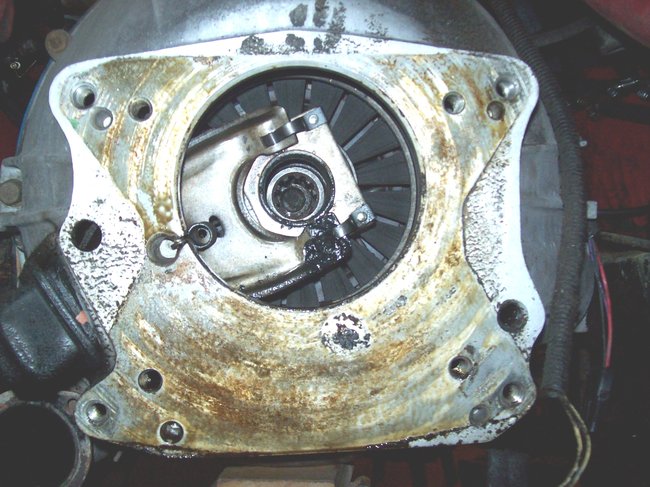

I'm definitely winging it, haha. I have no mechanical experience and I YouTube or forum everything I do. I should correct something that I said earlier. I did not replace the bell crank housing, simply the bell crank linkage. The picture below shows everything that I replaced. Thanks for getting me on track.

Did you replace everything in your pic?
The Medic
Oct 31, 2016 at 3:25 PM
JIMMYCHEESEBURGER
  • 7 POSTS
Yes.

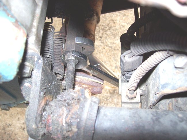

pics/ 1st '77/ same Jeep (back when Rangers only wore the black beret!)/ next '79 (semi got the last one)/ Present '77, ("Mr. Jeep")/ Present '46 Willys ("Willy")/ No title necessary!/ Next 3, few shots of my mancave!/ adjust clutch linkage/

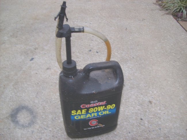

Open "Fill Plugs" fill until the juice starts running back out of the fill hole (I give mine 2 additional squirts) then quickly install the fill plug.
Do not use any other fluids such as oil stabilizer, which makes things too thick and unable to sling around.
If you have a Trak-Loc rear diff (positive traction) You must also use a friction modifier mixed in with the gear oil, this lubricates the clutches in the differential. (you may have a regular ole standard diff like mine)

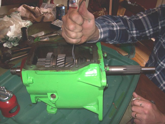

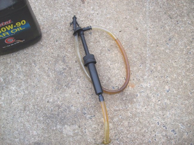

Pic 1)100% Rebuilding my tranny, Fill plug hole on side (plug is removed)
PIC 2) GIVEN
PIC 3) ABOUT $840 ALL TRANNY INTERNALS, LESS CASE, FILL/ DRAIN PLUGS, OUTPUT GEAR TO TRANSFER CASE. "Dews" in there for size reference, they were not wasted!
PIC 4/5) $5 FILL PUMP FROM ADVANCE AUTO PARTS, MAKES THINGS EZer

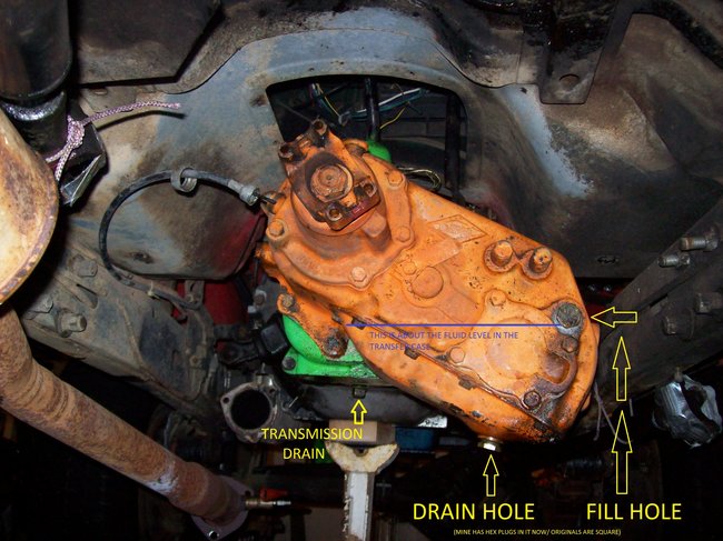

Here's the transfer case (pic below)
I'll take a few pics tomorrow of the front and rear differential fill plugs.

I drew a horizontal line about where the fluid level is inside/ I have also replaced most of the original square drain plugs with hex plugs (sockets/ wrenches are EZer for me to use) My whole Jeep is more "User Friendly" than it ever was!
