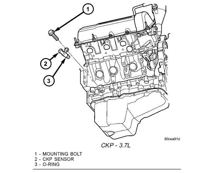

Hi everybody,
I am having a hard time locating my crankshaft position sensor. I am trying to replace it. Thank you and have a wonderful evening.

I attached a picture of the location for you.
It will be much easier to get from the bottom.
The Crankshaft Position (CKP) sensor is mounted into the right rear side of the cylinder block. It is positioned and bolted into a machined hole.
1. Raise vehicle.
2. Disconnect sensor electrical connector.
3. Remove sensor mounting bolt.
4. Carefully twist sensor from cylinder block.
5. Check condition of sensor O-ring.
INSTALLATION
1. Clean out machined hole in engine block.
2. Apply a small amount of engine oil to sensor O-ring.
3. Install sensor into engine block with a slight rocking and twisting action.
CAUTION: Before tightening sensor mounting bolt, be sure sensor is completely flush to cylinder block. If sensor is not flush, damage to sensor mounting tang may result.
4. Install mounting bolt and tighten to 28 N-m (21 ft. lbs.) torque.
5. Connect electrical connector to sensor.
6. Lower vehicle.
