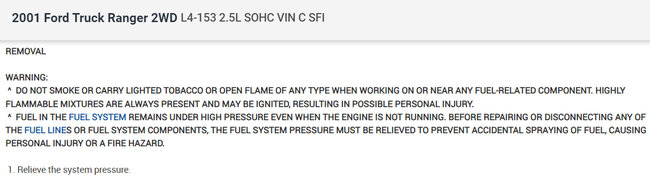

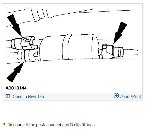

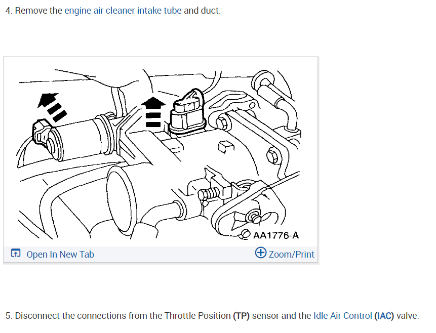

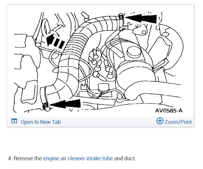

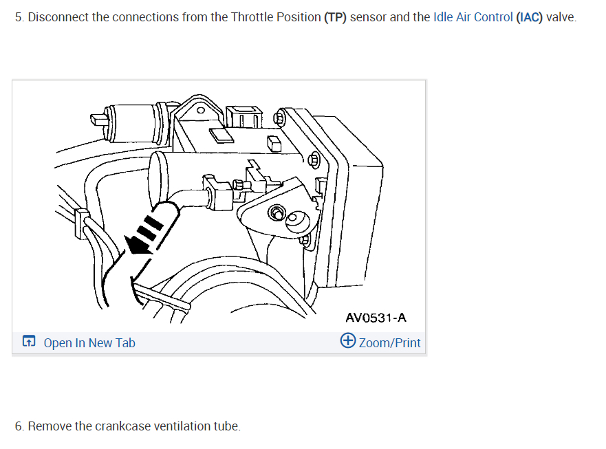

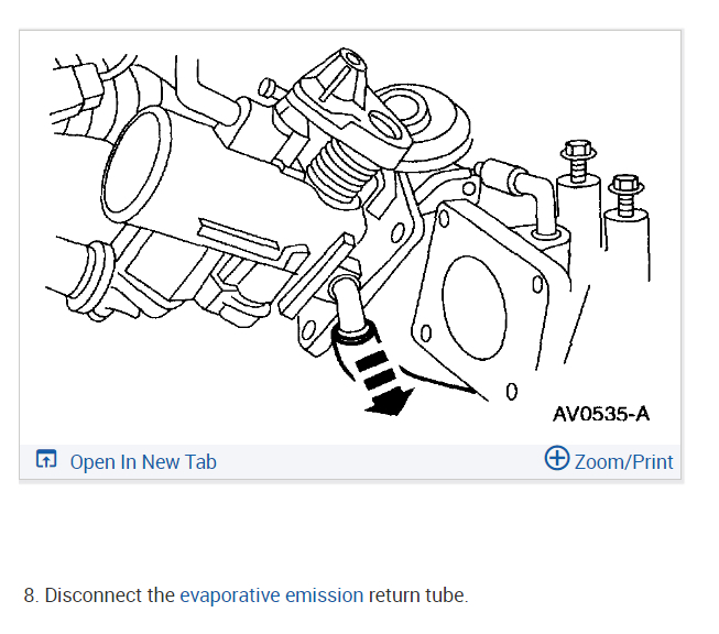

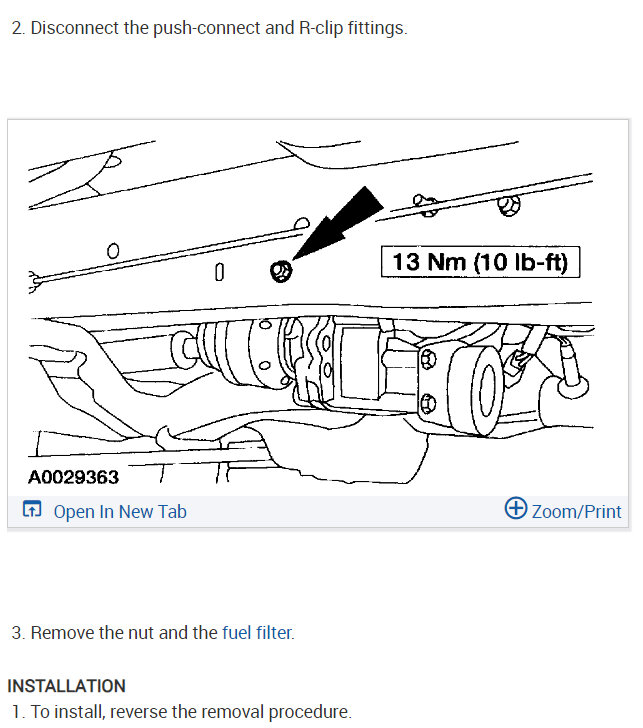

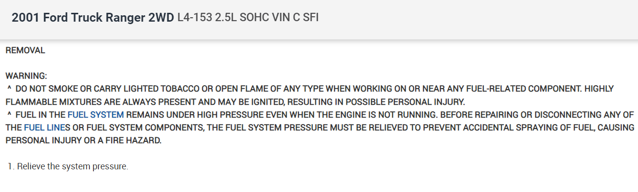

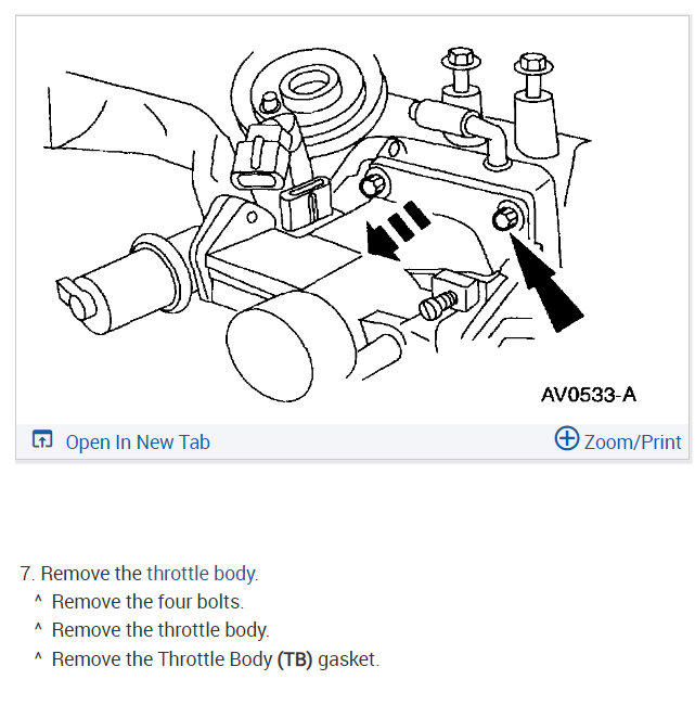

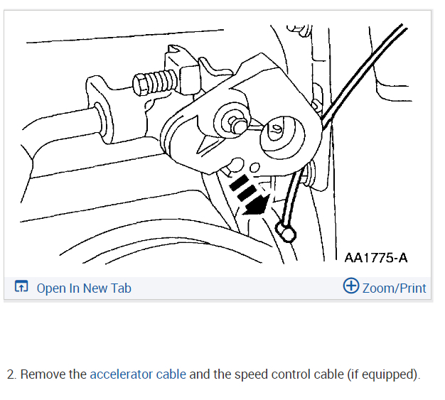

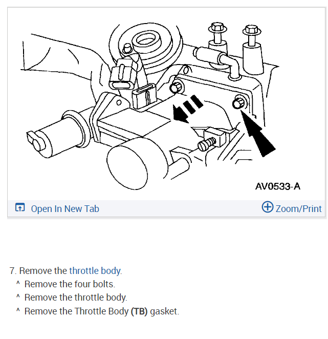

It sounds like the engine is hard starting which the most common problem is a weak fuel pump, but to be sure let's replace the fuel filter and go over this guide to learn more about the problem and how to fix it:
https://www.2carpros.com/articles/engine-cranks-excessively-before-starting

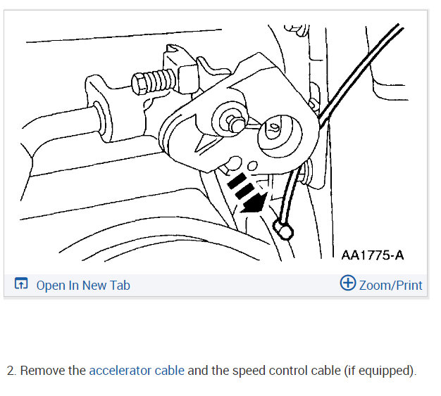

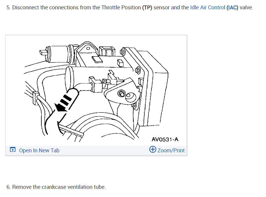

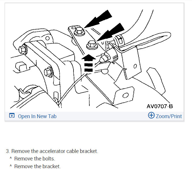

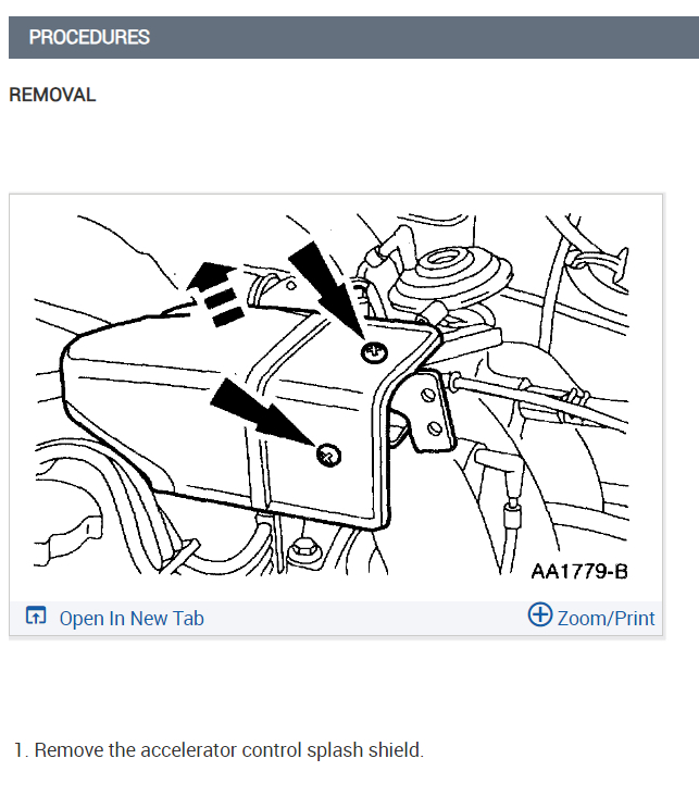

Here is the location of the fuel filter and how to change it out, check out the images (below). Please let us know what happens. Also, I would clean the throttle body and IAC motor.
Please go over these guides and get back to us.
