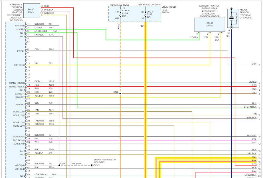

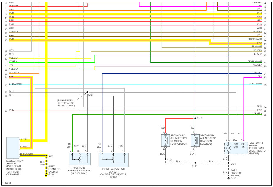

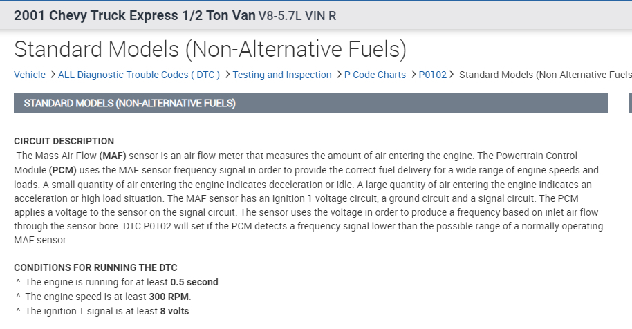

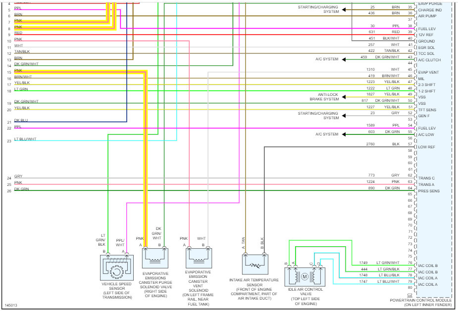

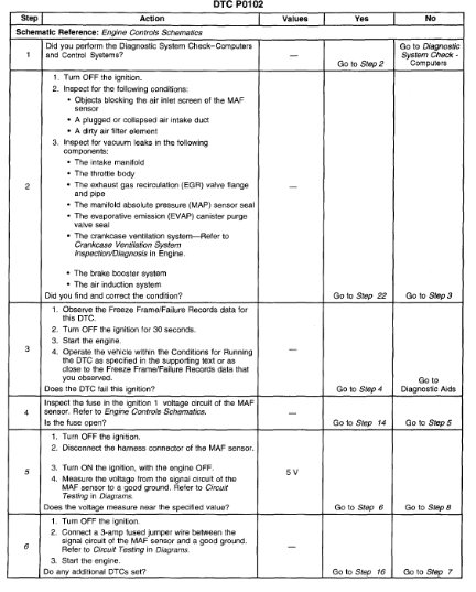

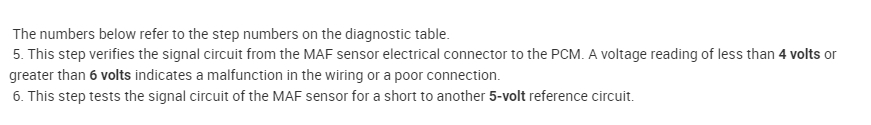

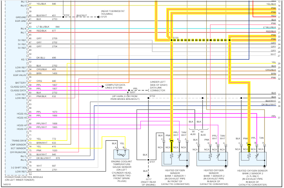

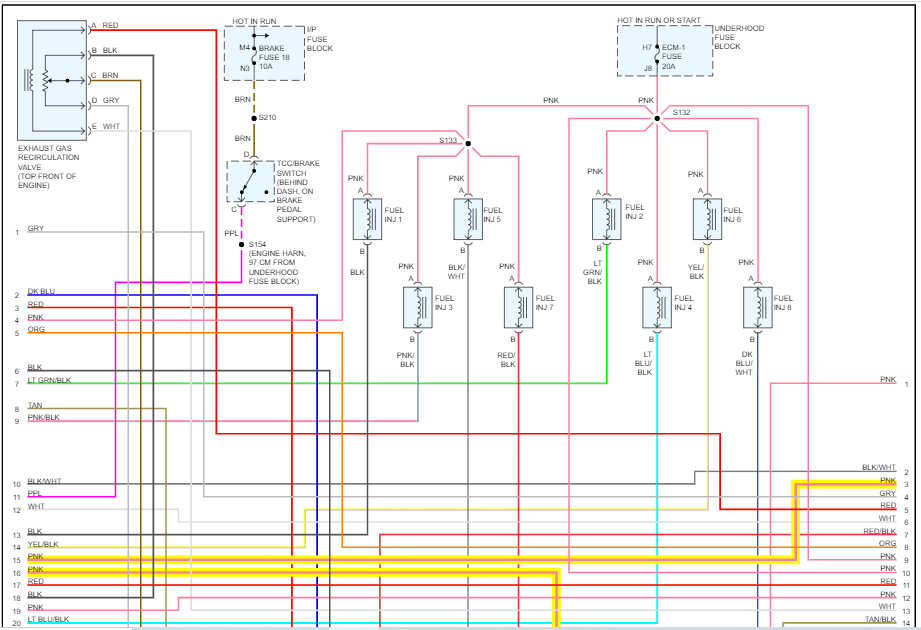

I have a p0102 code, engine stumbles a bit. I checked the connector for voltage, and it had no power. The control wire had 5 volts. I'm looking for a wiring diagram as well as steps going forward to solve.
Sep 30, 2022 at 4:26 PM
  • 110,194 POSTS

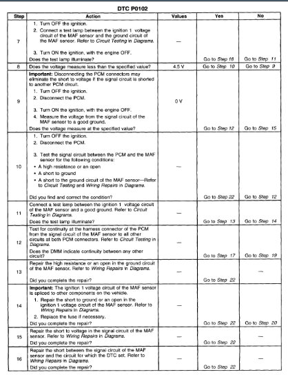

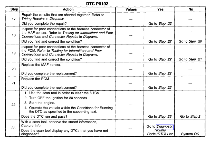

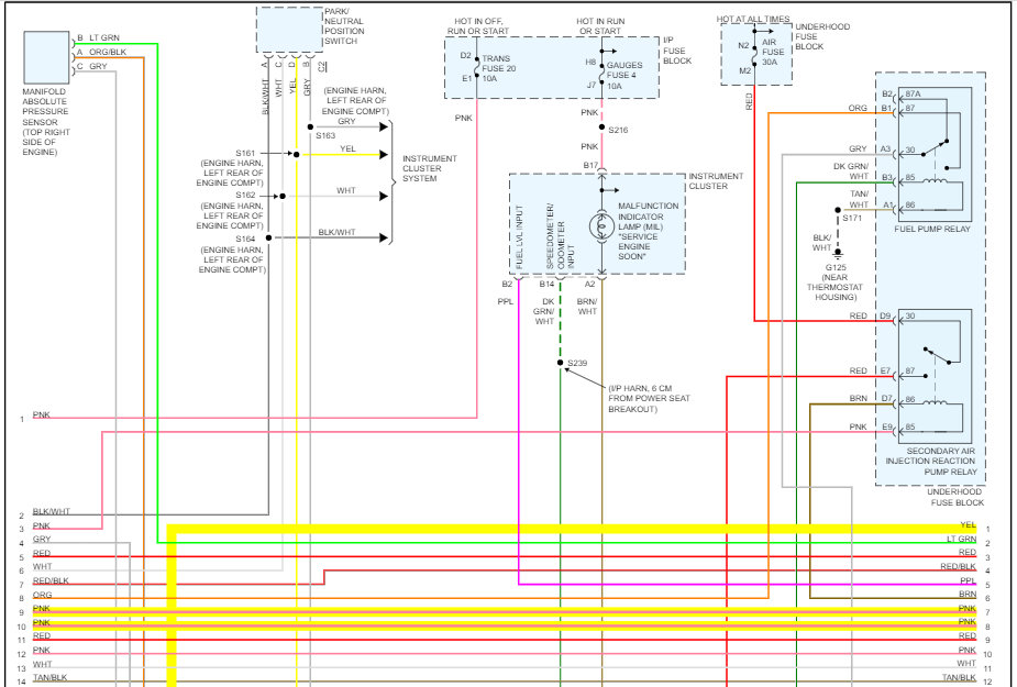

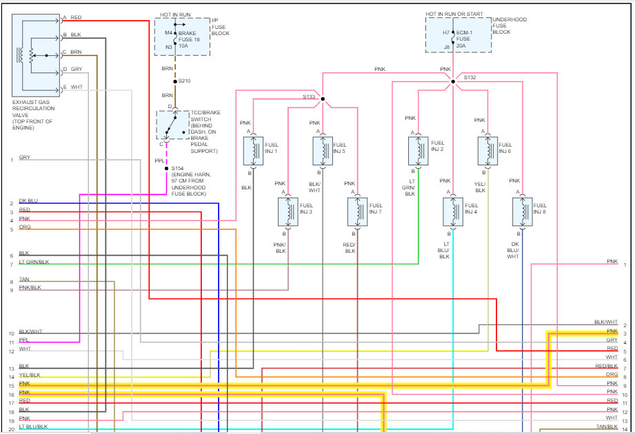

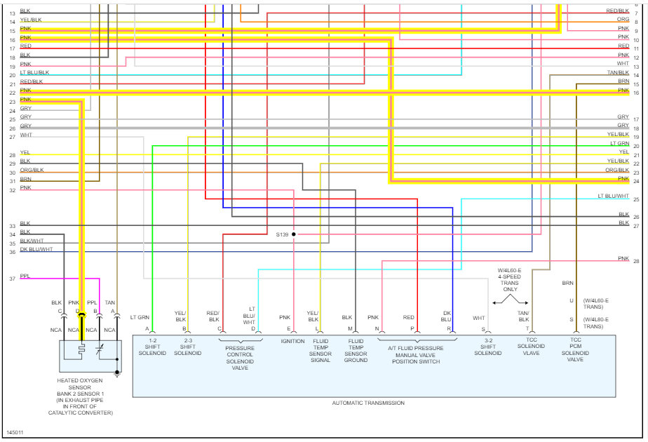

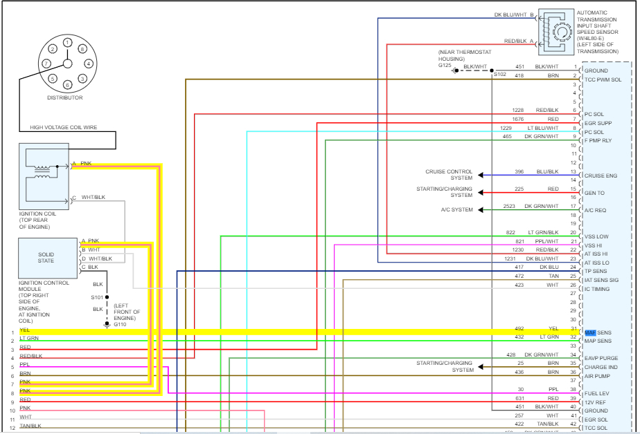

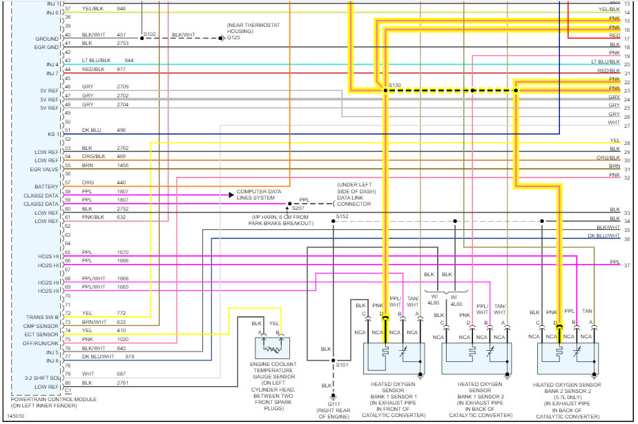

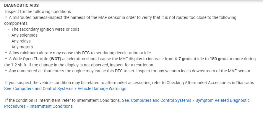

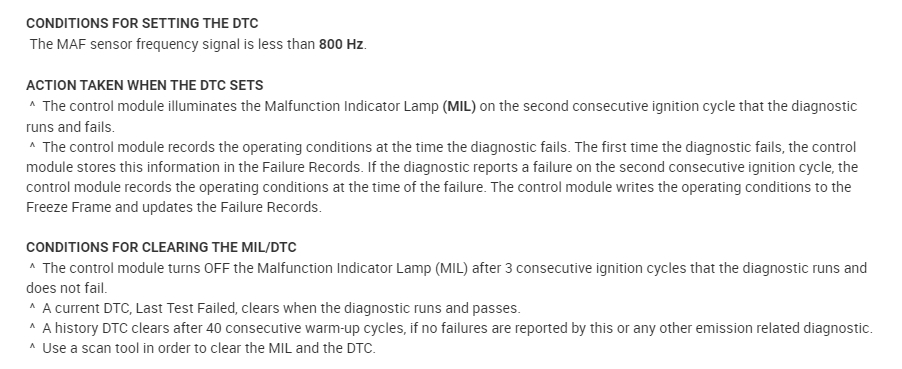

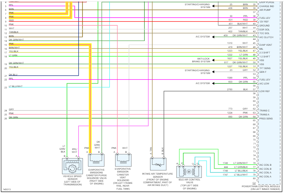

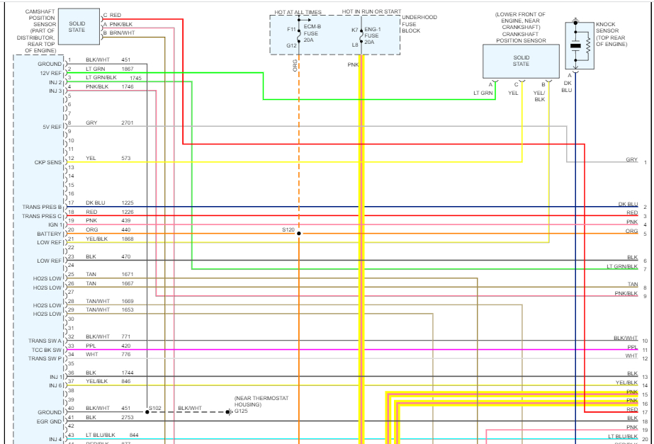

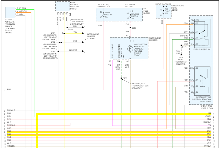

If you look below, I attached both the wiring schematics for the entire powertrain control module and the diagnostics specific to the code.
You may want to try servicing it.
Here is a link that explains how that is done:
https://www.2carpros.com/articles/mass-air-flow-service
Let me know what wire didn't have power.
See pics below. Note: I had to cut each wiring schematic pic in half to make it readable for you. I did overlap them so you can follow from one to the next.
